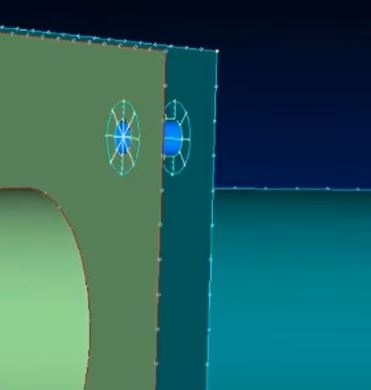

I work at a small company and from time to time we need some FEM Simulations. I quiet well know Femap. At work we are just using NX Design Simulation, which capabilities are not that good, especially when you need beams or shells.
I did some reasearch and came to Mecway, which i really like from first views :)
I downloaded the 1000 Nodes test version and iam very happy with it. When i come back to femap there is some api to idealize bolted connection, which connects each end of a beam element with an RBE2 element to a bunch of pre-selected nodes.
I tried to make a code to recreate this kind of feature.
There are some points where iam getting stuck. I managed to select some nodes and create a mid-node and connect the selected nodes with a line2 element to the mid-note.
I would like to give those beams mechanical properties like youngsmodulus, diameter, rectangular bar, poisenratio, density...
i looked in the api reference "mw.material_property(material, property)", but i didnt got it running so far.
Is there also a way to create a button, to give the user a chance to re-select some other nodes before creating a new mid-node? now it just creates the same beams like before when you continue the code.
I was thinking about the same kind of behavier when you select the open cracks feature. Where is a button to repeat the code after you pressed it or something like that.
I appreciate every kind of comments and help and i wish you a good start into the new year ;)
ps.: attached you see a bolted connection in Femap and the code i made so far.
