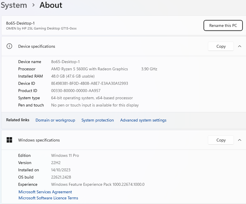

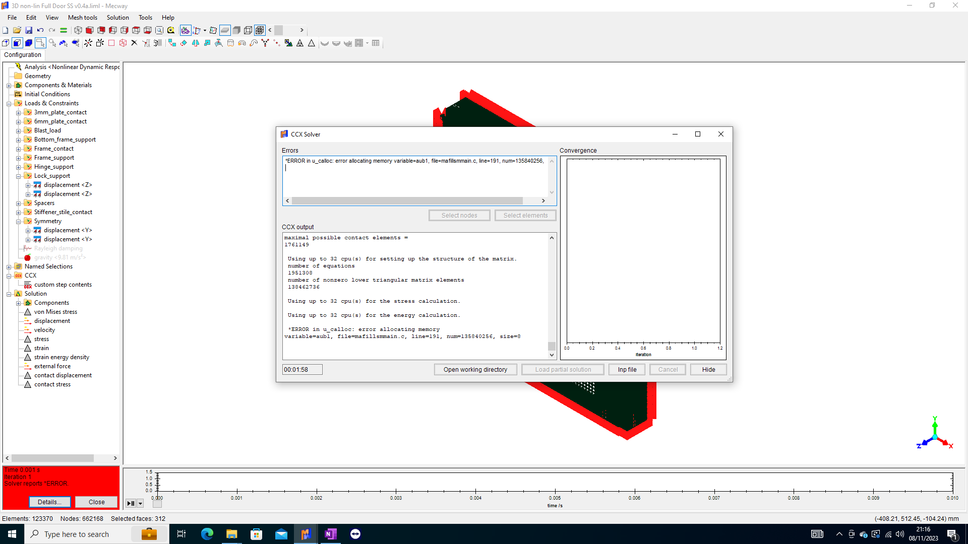

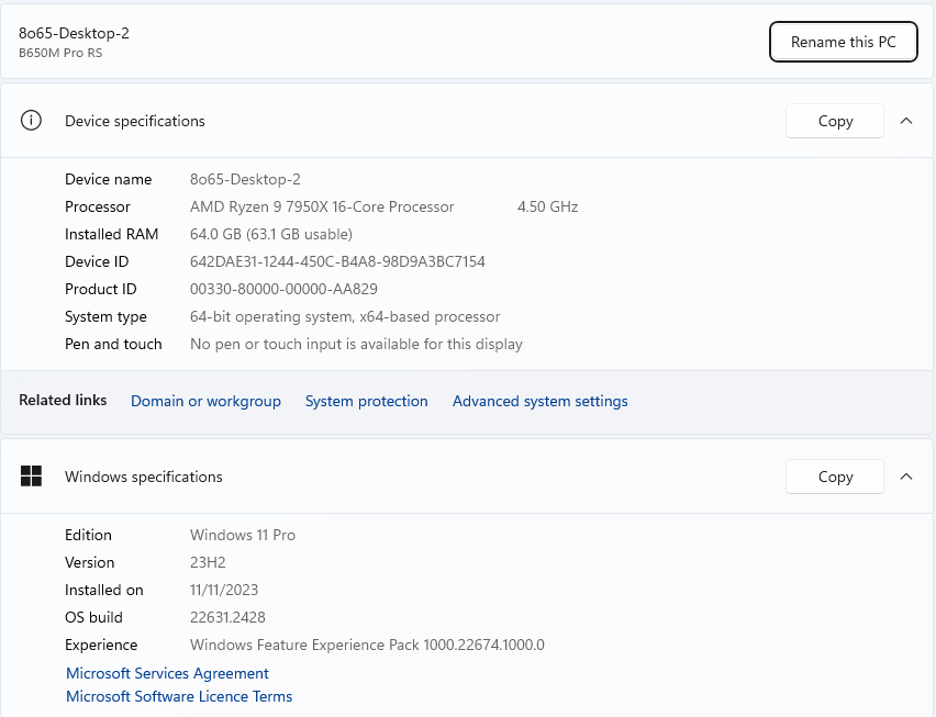

I have two AMD based computers running the same problem. The lower spec computer seems to run the model without any issues (although memory usage is often nearing 100%) but the higher spec computer stops at the first iteration with the following error:
*ERROR in u_calloc: error allocating memory
variable=aub1, file=mafillsmmain.c, line=191, num=135840256, size=8

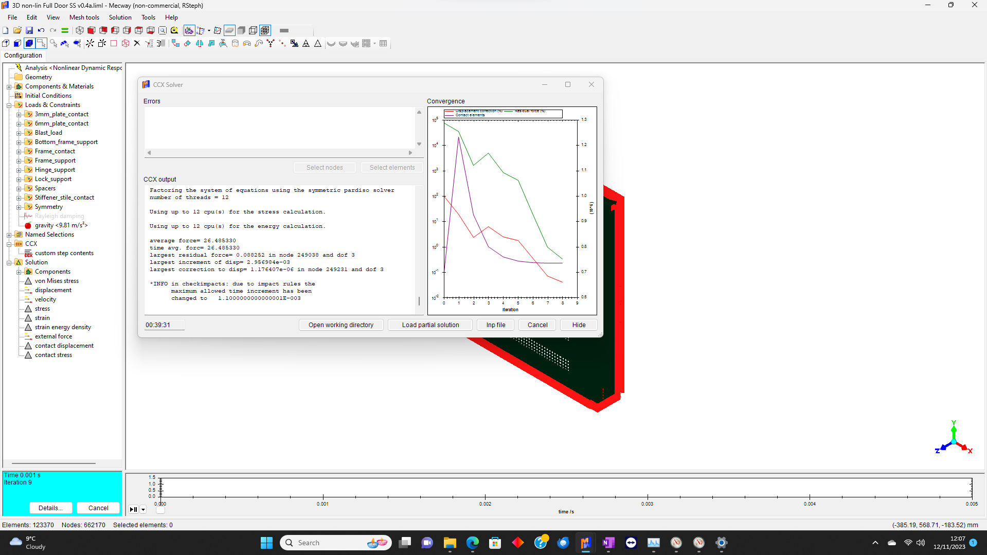

I have attached screenshots for both computers and also the solver output that is identical up until the first iteration.
My question is why is the higher spec computer failing whereas the lower spec isn't? For other problems the higher spec machine has worked whilst the lower spec machine hasn't for the same problem.

    1. Both computers are using Version 22. I may have a look at Version 20 however I have currently set the higher-spec computer to 24 processors rather than 36 and for the current run this seems to do the trick.
