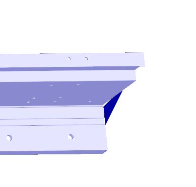

I have a STEP file that is not importing correctly. On import MECWAY is adding an additional face/surface that is not there. I have imported the STEP file into a second CAD program (not the one it was generated in) and it reads it fine (no extra surfaces). I also tried exporting the STEP file from the second CAD package and it still imports into MECWAY with the additional face/surface. The erroneous feature is shown in dark blue in the attached picture. Any ideas on how to keep this from happening?

  • Is this extra surface one triangle, and selecting it also selects a neighboring real surface? This isn't something I've seen before with the CAD import, but it's a bug that can happen occasionally with the automesher which is the same code, so it's possible that's happening here too.
    In that case, I expect the surface to be absent from the mesh and not cause any downstream problems.
    Otherwise, could you send me the step file to have a look at? You can use email if it's confidential.
  • Yes it is one triangle that also selects a neighboring real surface. When meshing, it gets all the way to generate the volume mesh (takes a long time to get there as there is a bit of complexity to the part) and then crashes. I'll tweak the meshing parameters and see if I can get it to work.
