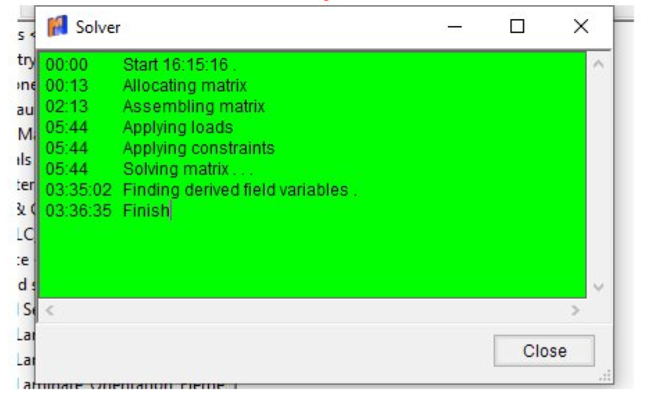

    Victor, yes it is feature-rich, but I'm not sure how that I would significantly defeature it without altering its' fundamental behavior. It is a lattice of cables which both transfers load from a covering membrane to the underlying frame, as well as buckling support for the frame. The connectors are already simplified as octagons, which is where the bonded contacts are applied between the frame. I attached a couple of screen shots.
    The only way I could figure to model tension-only cables for nonlinear analysis, is as very thin flat ribbons, so I had a reasonable surface to apply the load (for modeling, the overlying membrane is excluded), and they should just buckle out of the way should compression occur.
    I have already run partial models to reveal local bucking issues. Now it's time to look for global buckling, which I can already see three failure modes, but want to quantify them to see where to best apply additional reinforcement. Loading the entire model for this resulted in the RAM issue.
    Initially I meshed this as a surface, but CCX failed with hundreds or thousands of "inverted normal" errors. Meshing as solid resolved the CCX errors, but I had to give it a finer grain to eliminate meshing errors.
    disla, I did not activate PEEQ, that was done by....?. May be some way to override it off. Will have to investigate. For the last solve, I removed contacts with the frame just to see if it would solve, but still no. Thanks for the offer to test it on your system. However, after reading this and trying a few more adjustments, I think maybe I should really be asking how I could model this better, rather than how I can solve this one.
    Suggestions for better modeling of a cable lattice?
