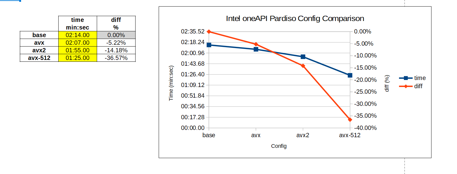

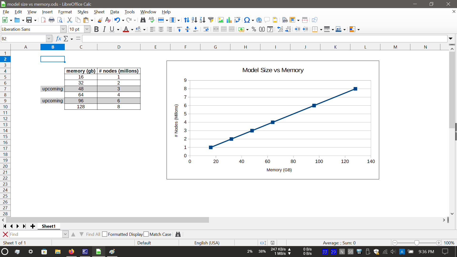

    I should probably add a few things. To get an idea if you can solve your model, I attached a picture with my solving experience. I can solve 1 million nodes with 16 GB of memory. I can go up to about 2 million nodes sometimes. If I go over 3 million it says it solves but no results are present. There seems to be a bug with CCX that occurs when you run out of core. Which means the hard drive is used to store information during solving, as opposed to memory. So ccx requires a lot of memory. I basically can analyze one blade of an 8 blade propeller. Cyclic symmetry is actually slower than just running a full disk. I can only run small test models. I can't actually use cyclic symmetry on a real model. There are also problems with the results. Mecway can't show rotating modes. So it's for all these reasons that I say you might want to look at something else.
    So besides my 8 core CPU with AVX512 extensions. I would also recommend a large amount of memory and the fastest SSD available. My SSD is slow and going out of core is very slow and hasn't seemed to work either.

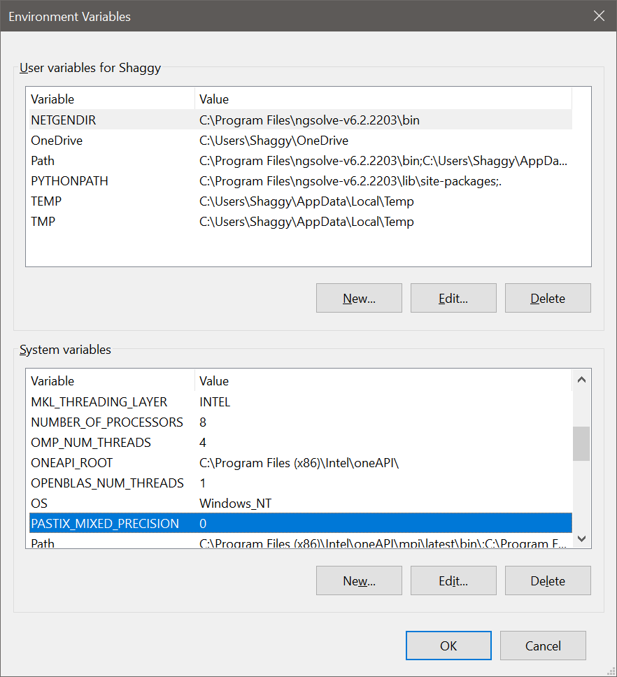

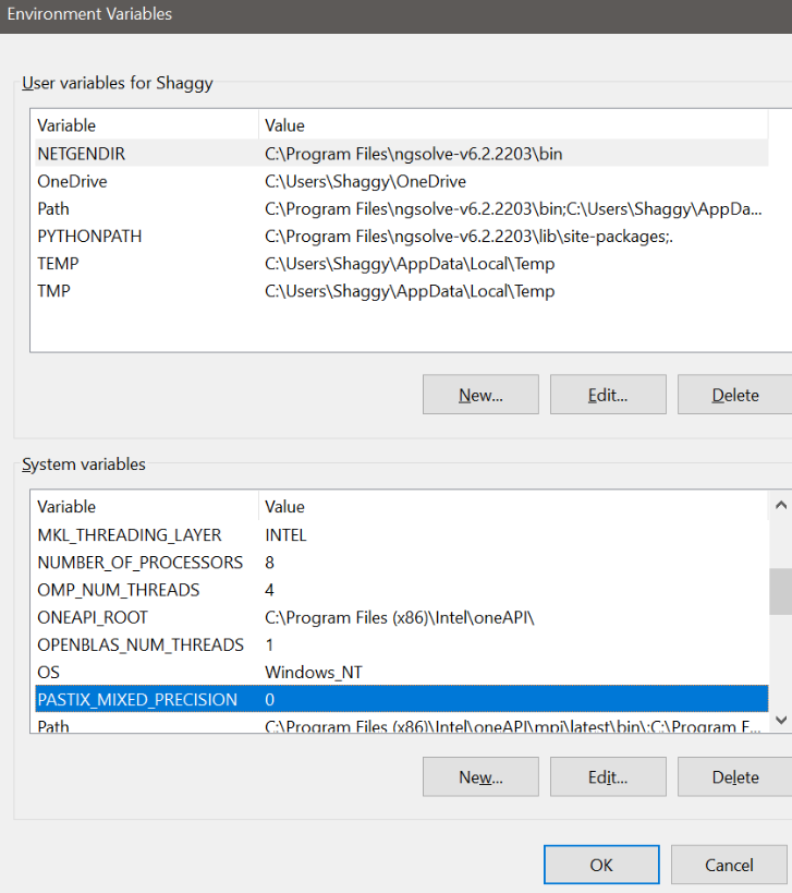

    one last thing that i forgot. you want to make sure you setup certain windows system environment variables. i attached a picture of my settings.
    the pastix mixed precision is an important one. setting it to 0 turns off their novel feature that also causes problems. the others you will want to set are the number of threads options. there is one for the intel mkl and another more general one. i see there is one for the intel mkl blas. however, i have never experimented with that. it's at the default. i have four physical cores and four hyperthreading cores. i generally never use the hyperthreading cores (on purpose anyways, they get used automatically by other software). so if you had eight real cores, i would set both options to 8. but it's up to you. if you want to solve multiple files at the same time, or do other things while it solves, then you could reduce the number of cores, to allow for that.

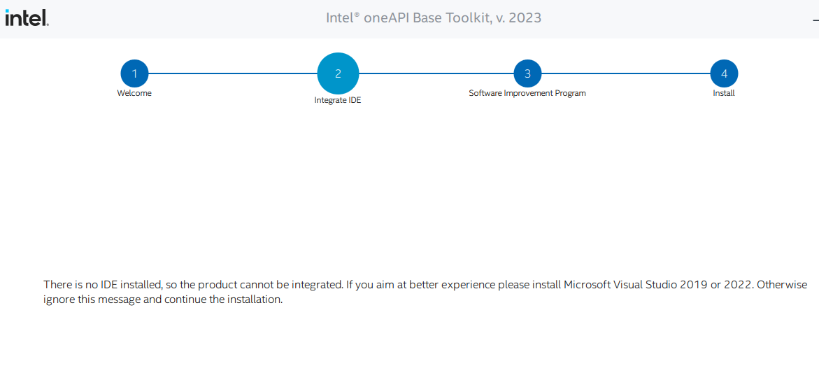

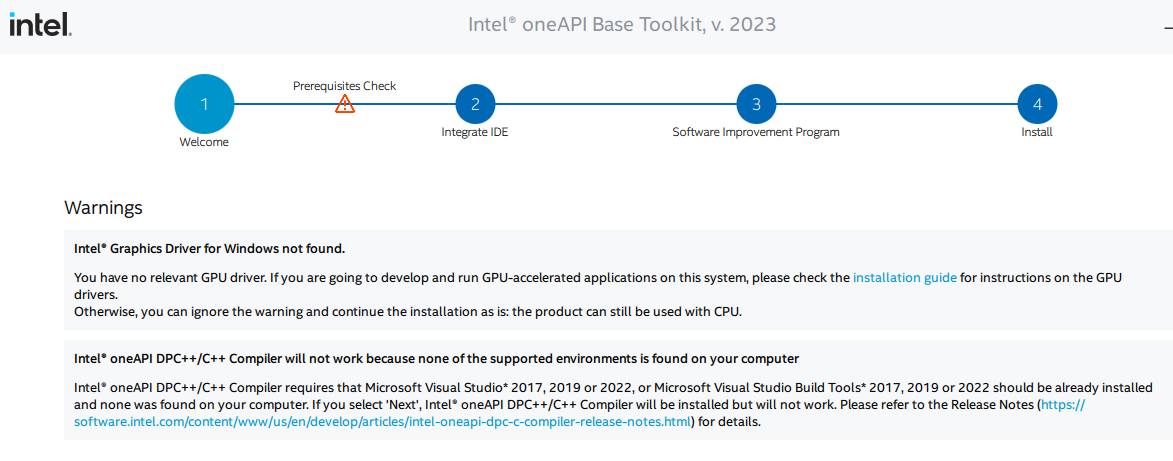

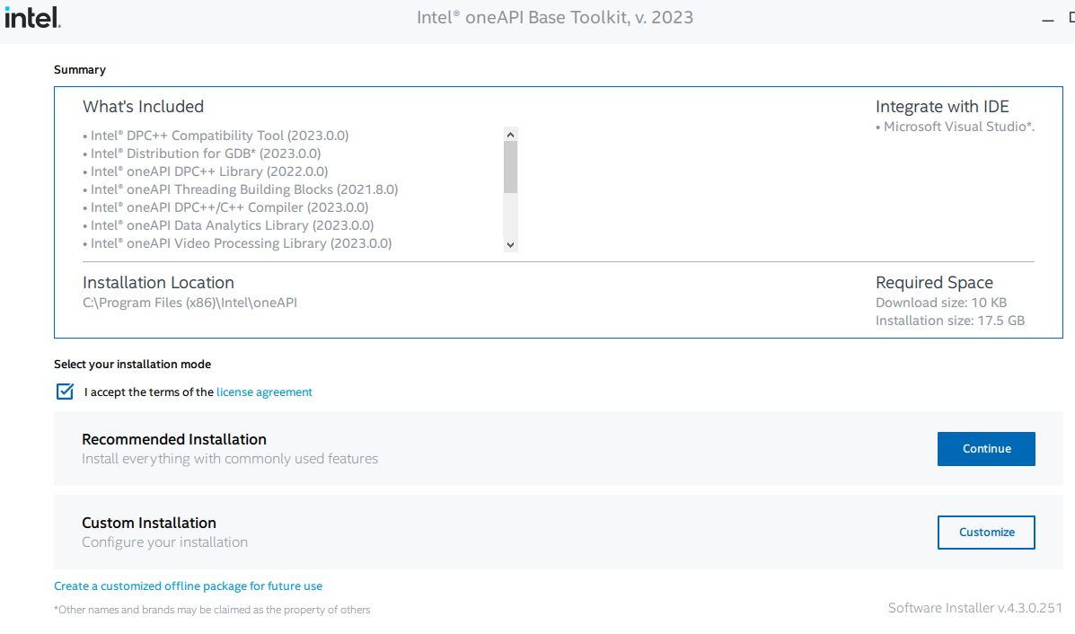

    The first step following your recommendations was I downloaded the "Intel oneAPI Base Toolkit" from Intel website and tried to install it. The first snapshot shows the warning I received. I ignored the warning and got another message as shown in the second snapshot. Can you please tell me what the problem is? Also, I can not find the site to download the CCX files.
    I have around 500,000+ elements and running on windows10 with specs attached. Thanks

    it looks like you checked to install gpu acceleration. try uninstalling the oneapi first. possibly reboot next. then resinstall. on the options, uncheck everything. then just select the MKL option. you also have to select at least one compiler, to get one dll file. the 'desktop c or c++' is the base. i install fortran, but that's because i use it to program. before you install openapi you also have to install microsoft visual studio. you got two errors there. one was for no gpu for gpu acceleration the other was for no ide. it can be difficult to figure out at first. but once you get the hang of it it's not bad. if you get an error, don't keep installing it. just cancel it and try over until you get the selections right. i don't have it in front of me so i can't walk you through it exactly. hopefully you know what i mean though. there is a free microsoft visual studio at:
    https://visualstudio.microsoft.com/vs/community/
    installing visual studio takes a long time and is rather huge to have when you don't need it. i don't need it but the intel compilers do. so it's a prerequisite i have to have installed. another issue is visual studio updates much more frequently than intel oneapi and it can break the oneapi. so once you get everything installed, don't update either program. if you want to upgrade to a newer oneapi later on. i uninstall the oneapi, then visual studio, then do the installs all over. otherwise i have had issues and even had to completely reinstall windows because oneapi got so messed up.

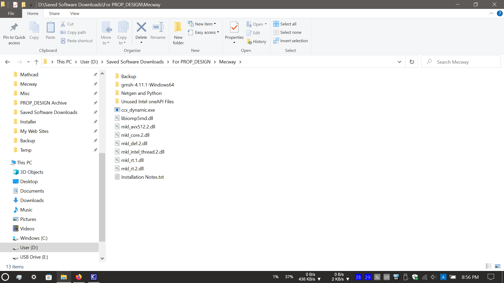

    you need to copy all the files into the folder that you made with ccx_dynamic in. look at the pictures i attached previously, to see what files i have in my folder. i experimented with removing certain files, to get the fastest solve time. it looks like your processor only supports avx2 extensions. so you will probably need two of the files i moved into the unused folder. those files are mkl_avx.2.dll and mkl_avx2.2.dll.
    in the installation notes file, i think i mentioned that you need to copy mkl_rt.2.dll and rename the copy mkl_rt.1.dll. that's because this version of ccx expects that file to be called that. intel starting renaming the files and it became hard for ccx to keep up. in the unused files you can move mkl_avx512.2.dll there, since your cpu doesn't have those extensions. lastly, i don't think the mkl_sequential.2.dll is needed. however, if you have problems, you can move that file into the folder with ccx_dynamic.exe.

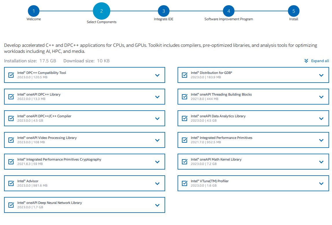

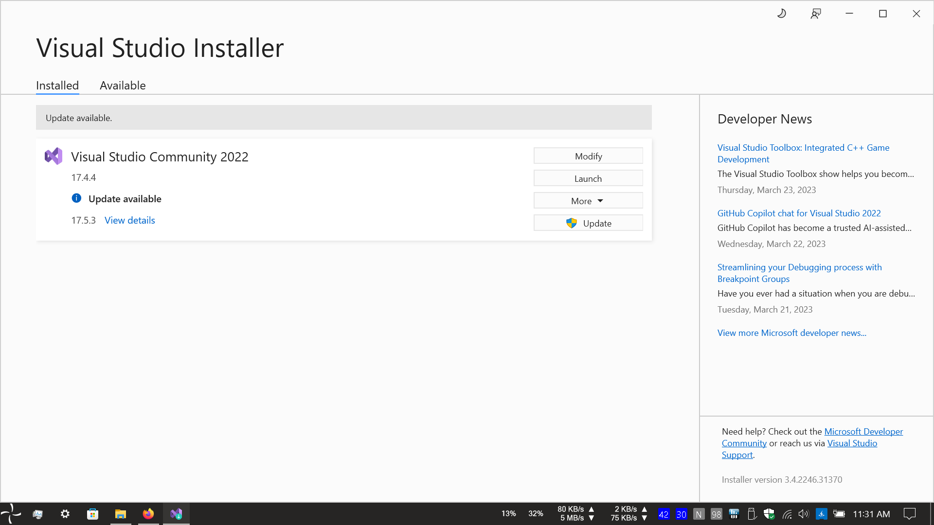

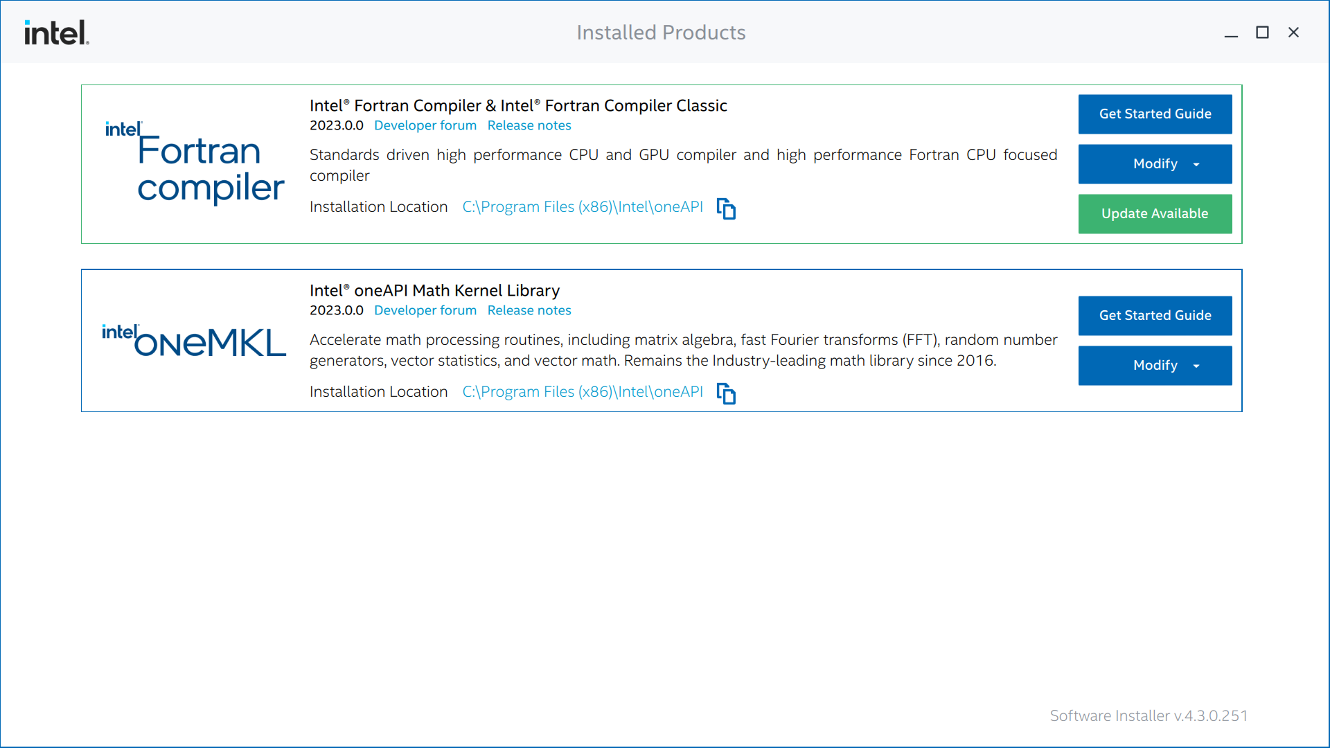

    edit; i added pictures showing what i have installed. as mentioned, using update for either product is not recommended. only install and uninstall. i had it wreck my registry and have to reinstall windows, or at best cause compatibility problems.

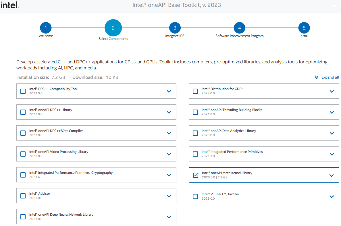

    Secondly, I started from scratch as you suggested. Downloaded VisualStudioSetup and Calculix_2.20.1_4win.zip. Then tried to install oneapi. Attached are snapshots from installing the Inlet oneAPI. I have stopped installation after selecting MKL option (see After MKL OPtion snapshot) because I was getting confused and am waiting for your suggestion.
    At this point,
    1) should I go ahead and install the VisualStudio first and continue with oneapi or it doesn't matter? I prefer step by step guidance (or few steps at a time) because I'm not an expert in all these.
    2) At what point should I install Calculix, if matters at all.

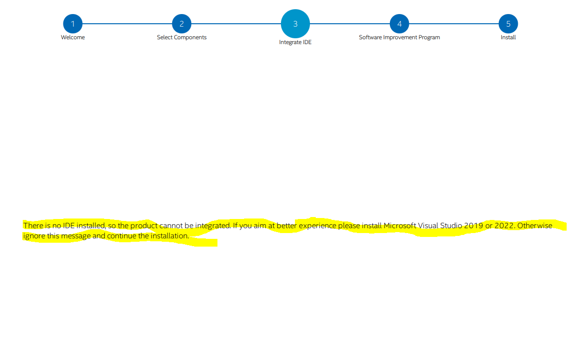

    the best i can tell it looks like you were on the right path when you had everything unchecked but intel oneapi mkl. however, as mentioned:
    1) install microsoft visual studio first (not needed for intel mkl but is needed for any of the compilers
    2) install oneapi with everything unchecked first, then check mkl, then add one desktop compiler option (c or fortran or as many as you may want to use. you need at least one to copy a dll for pardiso
    your other question. it doesn't matter when you install calculix. you actually don't install it. you just download it, unzip it, and copy the ccx_dynamic.exe file to a folder of your choice. that's the folder you point mecway to and also copy in all the dll files from oneapi
    hope that helps clarify
    ps; as you were seeing the oneapi installer does a good job of picking up additional things it needs to install. that's why i say start with everything unchecked, then check mkl and a compiler. it will pickup the rest and check that visual studio is installed

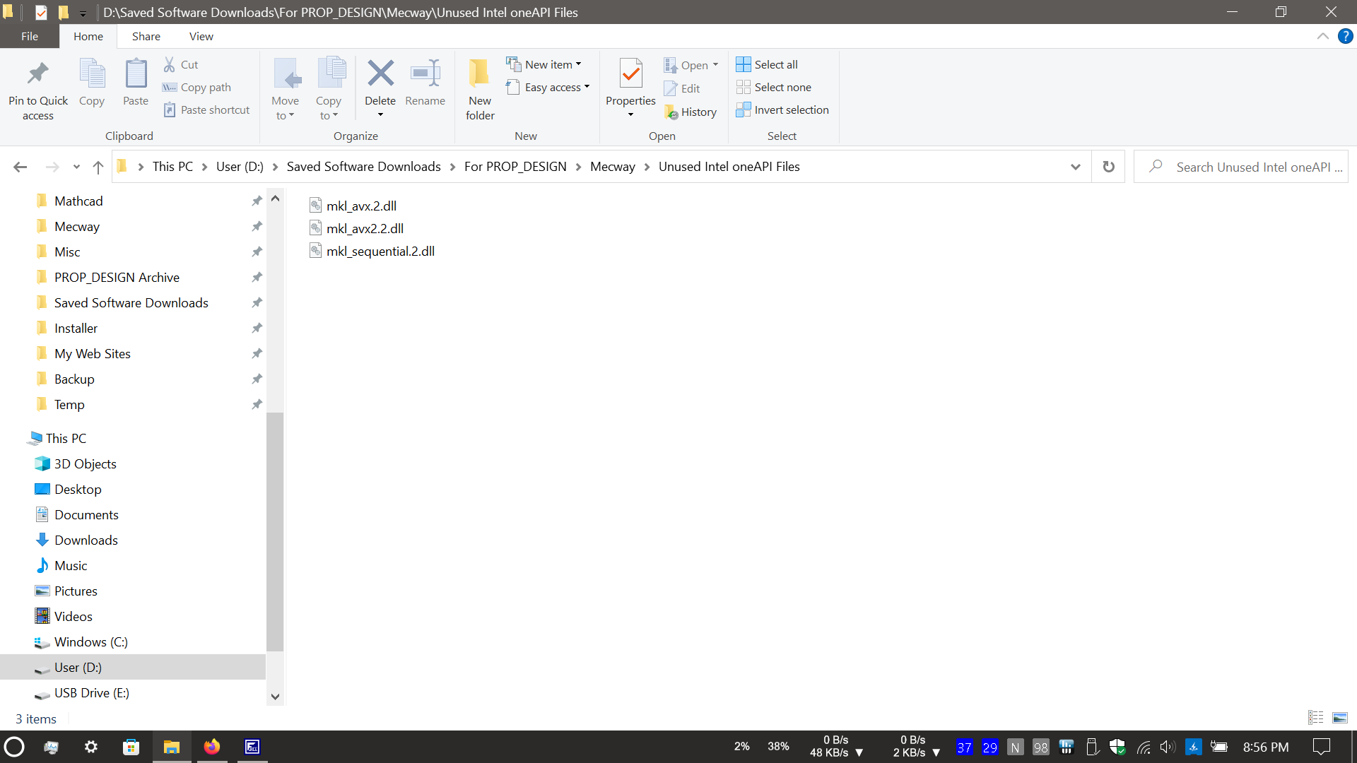

    interesting. so i tried testing some things and it seems to work differently than previous tests.
    now it doesn't seem like you need to make a copy of mkl_rt.2.dll and name it mkl_rt.1.dll
    it also doesn't seem like you need the libiomp5md.dll (which means you wouldn't have to install visual studio and a oneapi compiler). that would save a lot of trouble
    the other file in question only depends on your cpu support. you have avx2 so you only need mkl_avx2.2.dll in the folder. you don't need mkl_avx.2.dll or mkl_avx512.2.dll. so i attached a pic of what you should need in the folder.
    sorry if this reaches you too late. in the past, you had to have what i described previously.
    anthony
    update; I finished checking all the files and options. I attached an updated installations notes file. It includes my test speeds. I also attached the file, with the results cleared, to reduce file size. I experimented with the mesh size, so that it was big enough to show solution time differences. If the model is too small, you can't clearly see which dll file is best. Note, this model has reentrant corners. So ignore the stress at the root. It's just to look at displacement and transfer force to the retention model (which does not have reentrant corners).

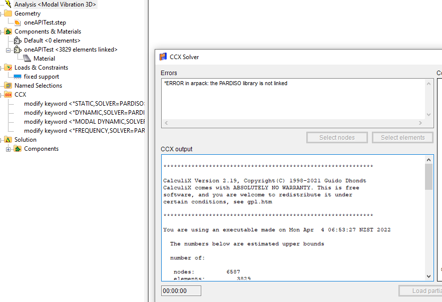

  • Anthony,

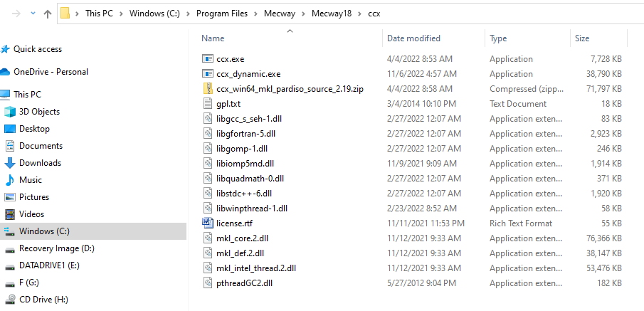

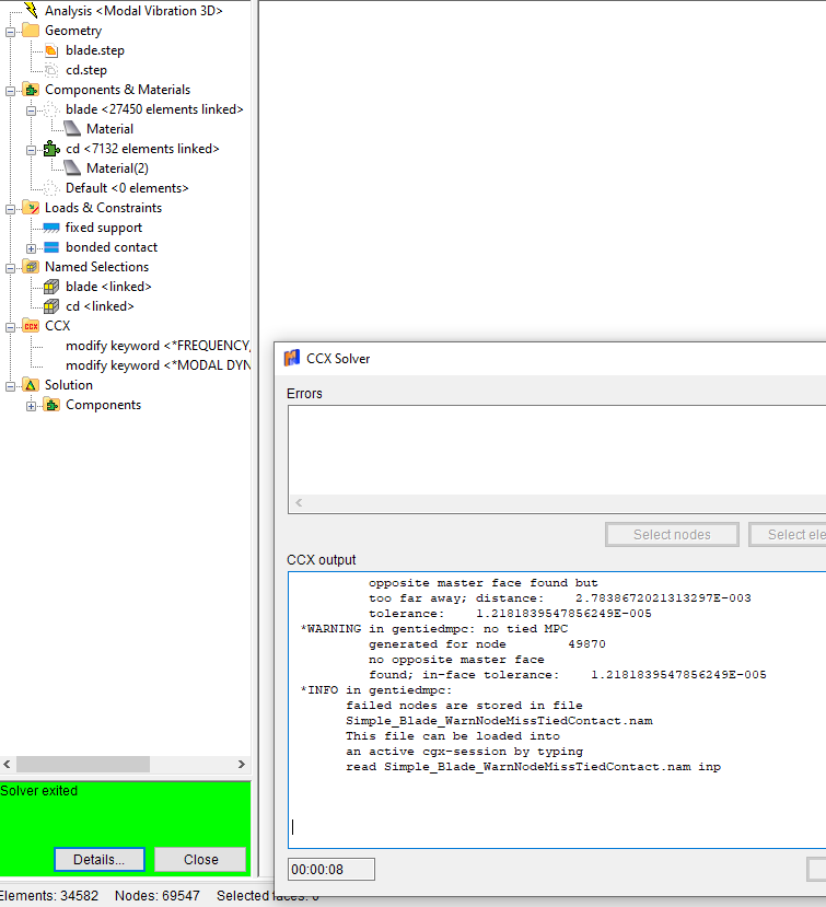

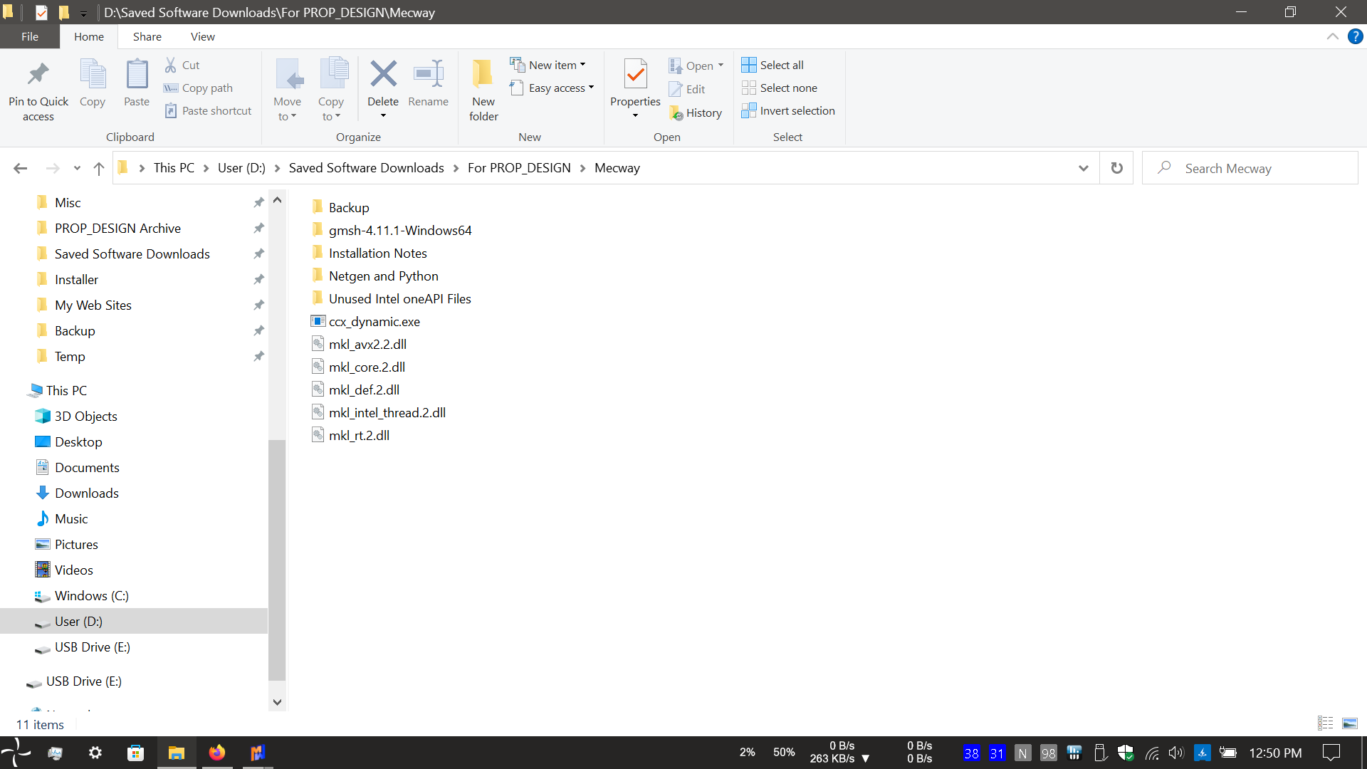

    I installed oneapi and put the CCX_dynamics.exe in the folder path as shown. Ran the attached test case and received an error. Any idea what theissue is now? thanks
  • edited March 2023
    It may be some confusion as to the folder you put the files in. You're pic shows the Mecway folder. You should pick a different folder, ideally not there. Make sure to move out any files you added there.
    I plotted my test times and I was surprised to see that AVX-512 is speeding things up a lot more than I thought. However, on small models you can't see the difference. The model needs to be reasonably large. Also, I'm staying in core. I've never got out of core to work.

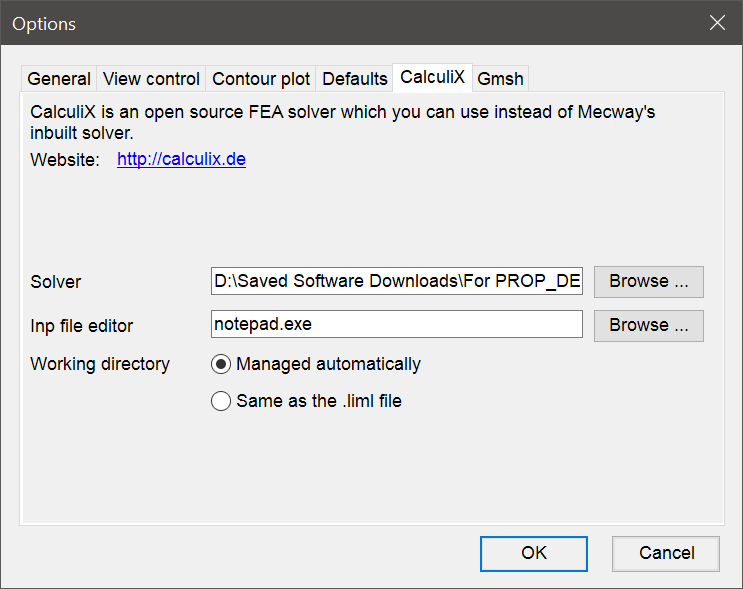

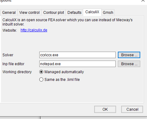

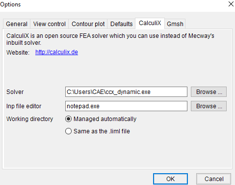

    edit; i added a picture of the mecway settings that you want to change. the option for calculix folder. you want to make that whatever folder you put the needed files in.
  • This is my current solver setting. Should I replace ccx.exe with the ccx.dynamic.exe one?
  • edited March 2023
    yeah. i'm not sure what the ccx.exe file is. maybe from mecway's install. you definitely shouldn't mess with the mecway folder though. if you have been writing over files or adding files etc... you could end up having to uninstall it and reinstall it. you want to put all the files in a separate folder, not in any windows Program Files folder. I have mine on a separate partition. However, it doesn't matter where, with the exception of if you put it in another programs folder then you run the risk of it getting deleted etc... the file you download from the ccx website that has worked for me the best is ccx_dynamic.exe.

  • Anthony,
    I'm getting more confused now. I removed the ccx.dynamic.exe from the Mecway folder and put it in a different folder (Location.PNG) and ran the test case. The solver stopped immediately with an error message with no text/description as shown in Capture.PNG.
    This is what I have done so far;
    1) Downloaded and installed Intel oneapi with MKL option.
    2) Downloaded and extracted ccx.dynamic.exe and placed it in a folder other than Mecway folder.
    3) Added cxx cards in my Test.liml
    Am I missing something? I'm trying to get this going so I can submit the full fan model with 800,000 nodes. Thanks again.

    that's great. you are getting much closer. unfortunately, you have to manually copy the needed mkl files and put them in the folder. you can also use environment path variables. i used to do it that way. however, i find having the files in the folder is nicer, because you can make sure what files are being used. so for your computer, you want to copy these files:
    mkl_avx2.2.dll (don't confuse with mkl_avx.2.dll)
    mkl_core.2.dll
    mkl_def.2.dll
    mkl_intel_thread.2.dll
    mkl_rt.2.dll
    if we are using the same version of intel mkl, then you can find these files here:
    C:\Program Files (x86)\Intel\oneAPI\mkl\2023.0.0\redist\intel64
    if a needed file is missing, you get problems like what you are having. sometimes, it will error out. sometimes, it will say what file is missing. sometimes, it just stops running but no error. it like stalls. through trial and error, i think the above are what you need.

  • After placing .dlI files in the folder where ccx.dynamic.exe reside, I ran two test case using internal (not CCX) and it worked perfectly. Submitted the big ass fan with 873000 nodes…so far nothing has happened. Is this normal? Do you switch it to internal as well?
  • Celebrated too early, I guess. Two test cases were static models. That’s why Internal ran successfully. My actual model has bonded contacts that are not allowed in Internal. Will continue on this tomorrow.

    We are getting much closer now. I’m running a test case model with bonded contact using PARDISO solver. The solver runs and exits without any error but there is no solution. I think environment variables not being assigned is the problem. Attached is your variables posted earlier. Can you please let me know where you get these from and where do you place them?
