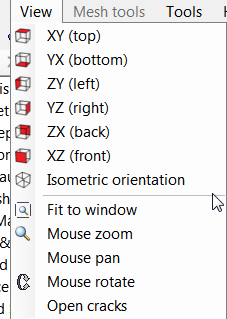

  • Victor,
    Can we have the attached picture (views) docked/expanded instead of going into the view tab each time for them? I know we have the triad at the bottom right that do the same thing. Thanks

    VMH) Thanks for the suggestion about view buttons. I'll try it and see what happens. I'm afraid they'll end up dominating the tool bar but every other CAE program has that.

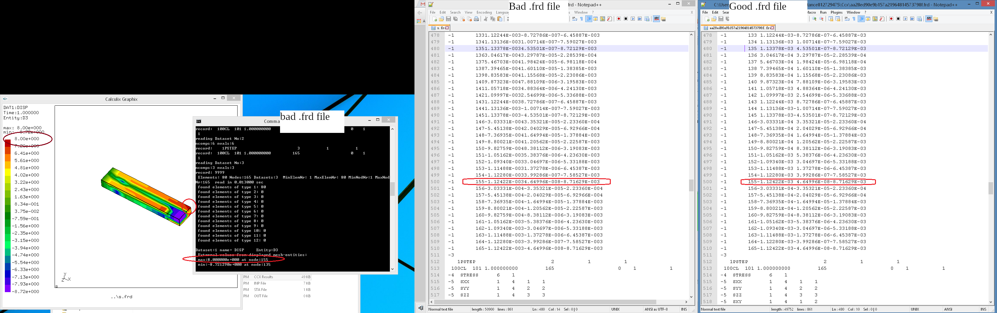

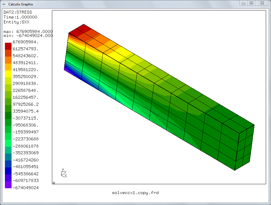

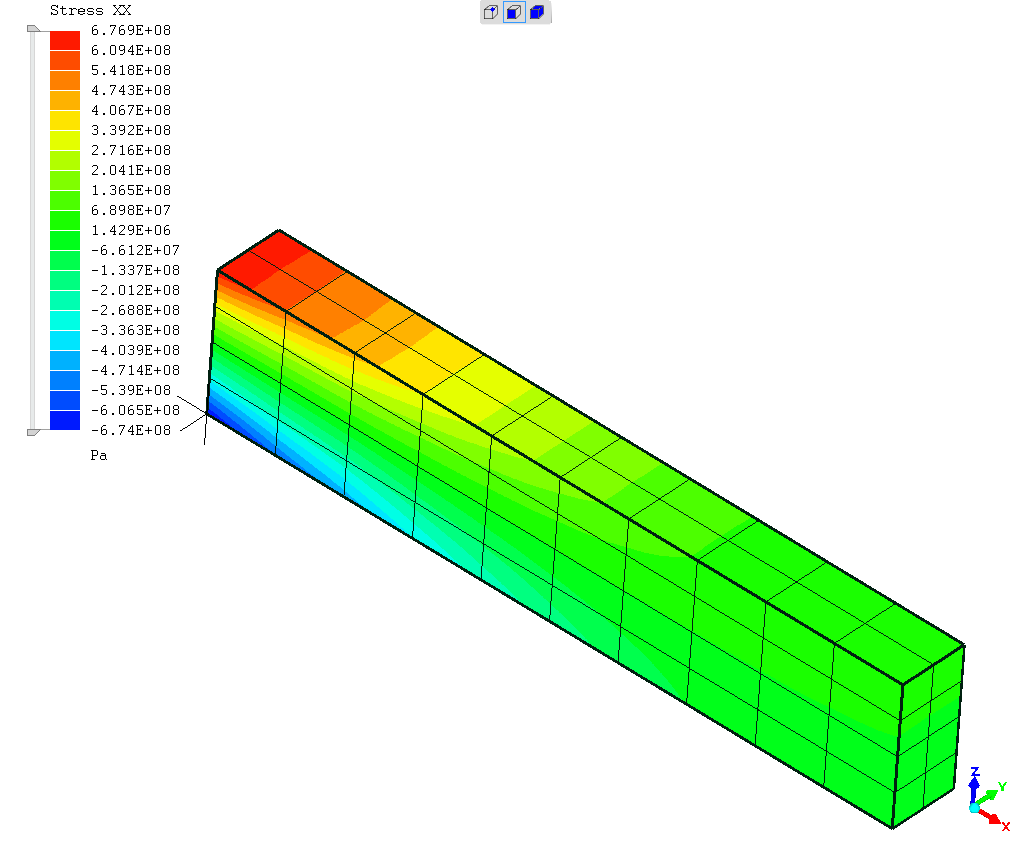

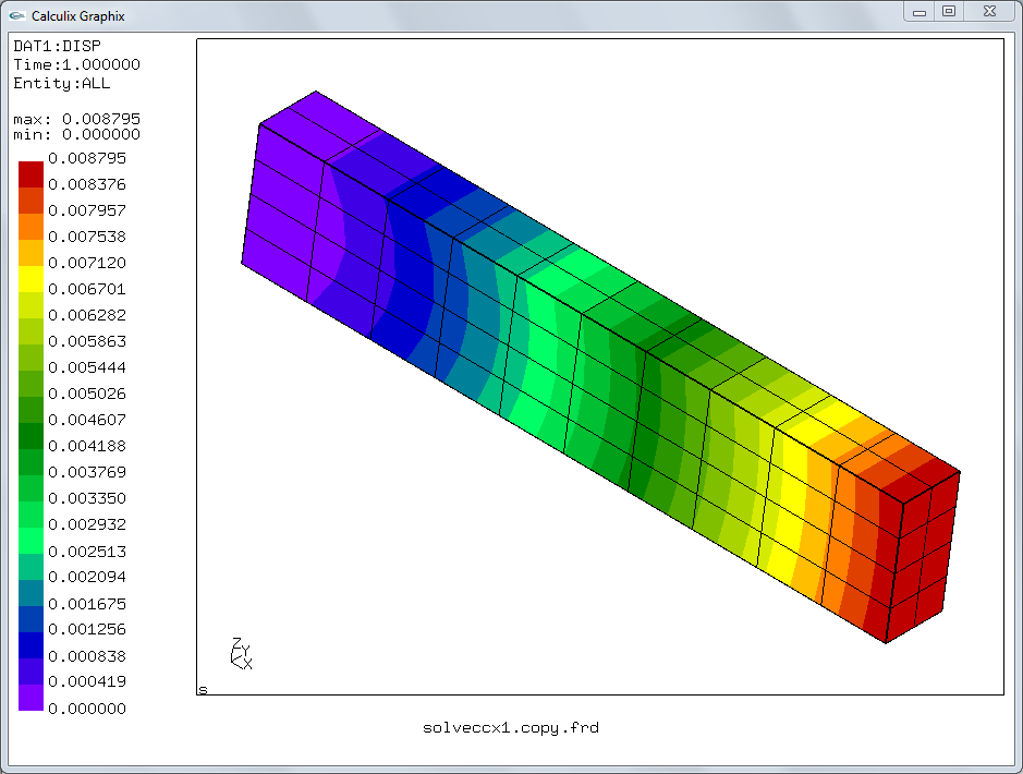

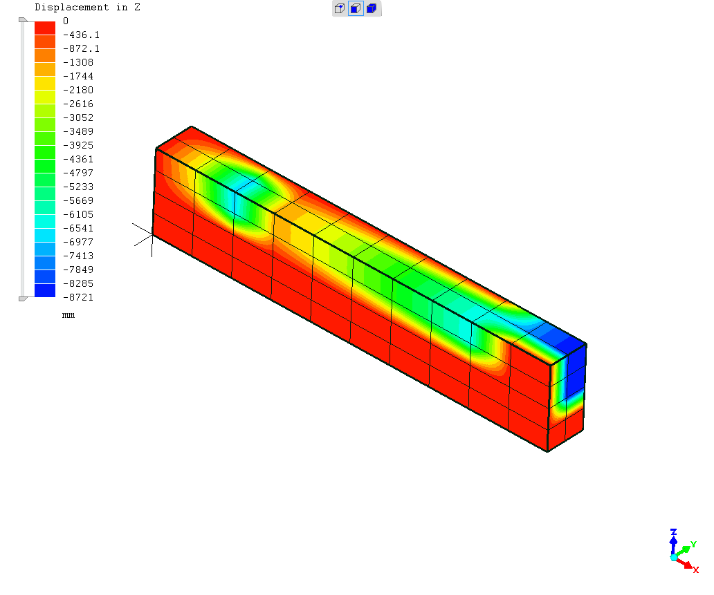

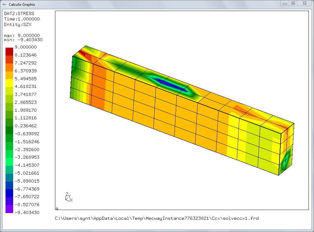

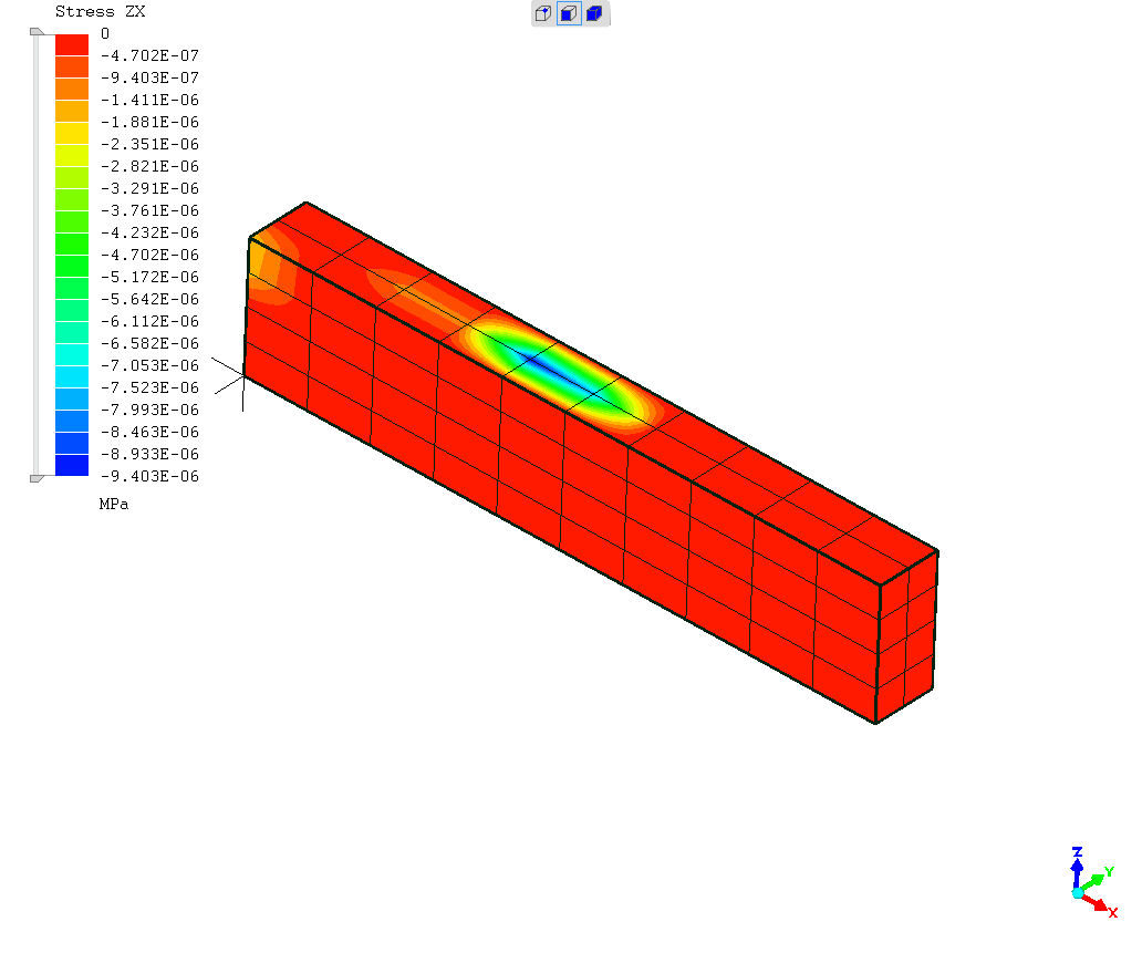

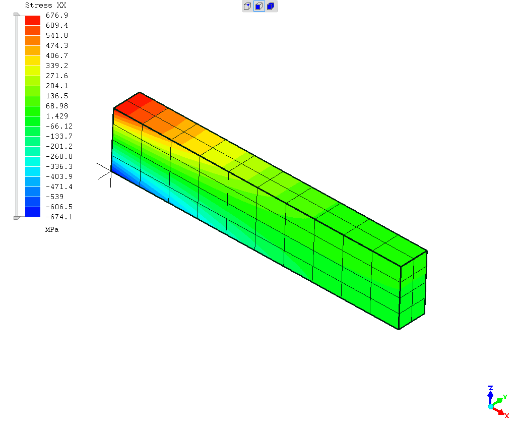

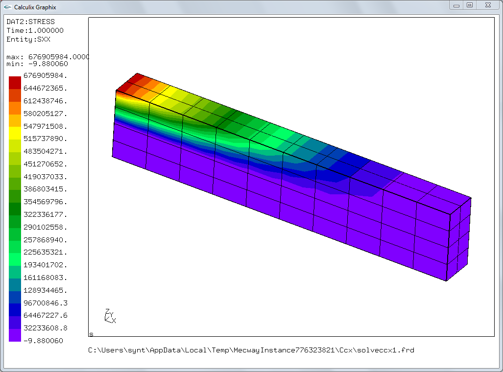

  • very impressive when MECWAY are integrated with CCX as external solver, even not fully.
    i try quick test for simple case, seem not working properly in reading *.frd results. i don't know where the trouble comes, is this my pc & installation problems or not.
    attached comparison of both solver output respectively, results for SXX, SZX, Deflection and example case input files.
    greetings,

    This looks like a bug reading the .frd file. It doesn't happen when I solve your model. Would you mind running this again and sending me a copy of the .frd file? After solving and while Mecway is still running, go to the folder %temp%\MecwayInstance#########\Ccx\ where # are random digits. Also, what version of CCX are you using?

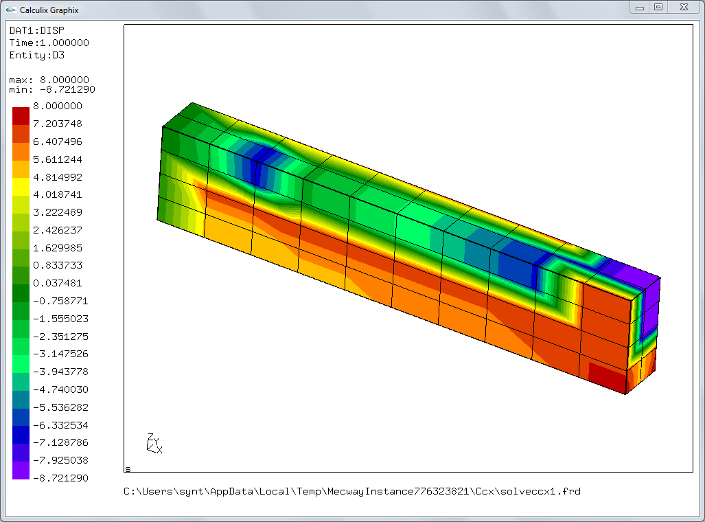

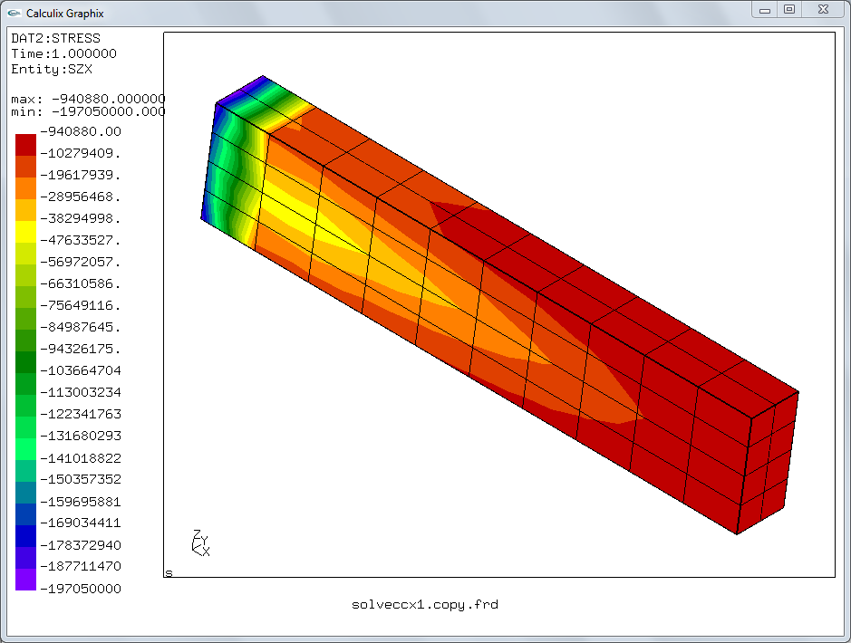

  • thx Victor for feedback,
    i have little bit confused with inp files created by MECWAY, there's also has another file with *.copy names.
    when i open up directly using CCX Graphics for frd files you mention, unexpected results same as displayed with MECWAY like my previous post.
    when i open up inp files and running, the result are as expected. back reading frd of these result files with MECWAY are displayed as expected.
    sorry Victor, not want to disturbing the forum with many of pictures i attached.. just want to show the problems.

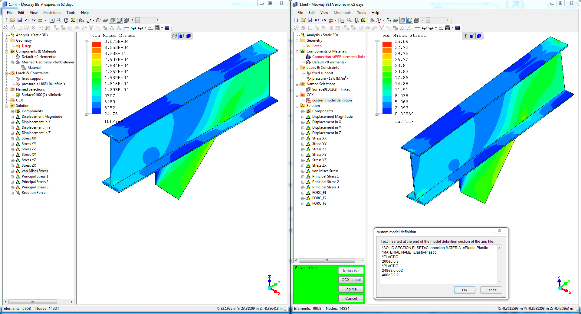

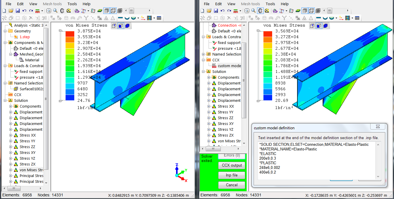

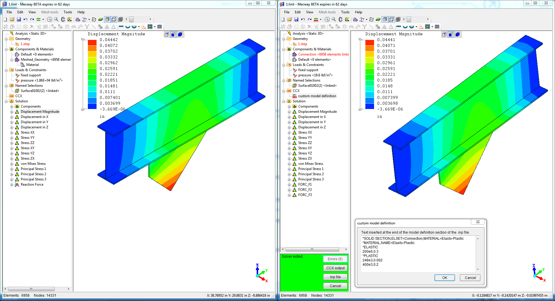

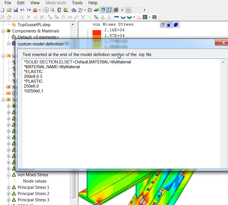

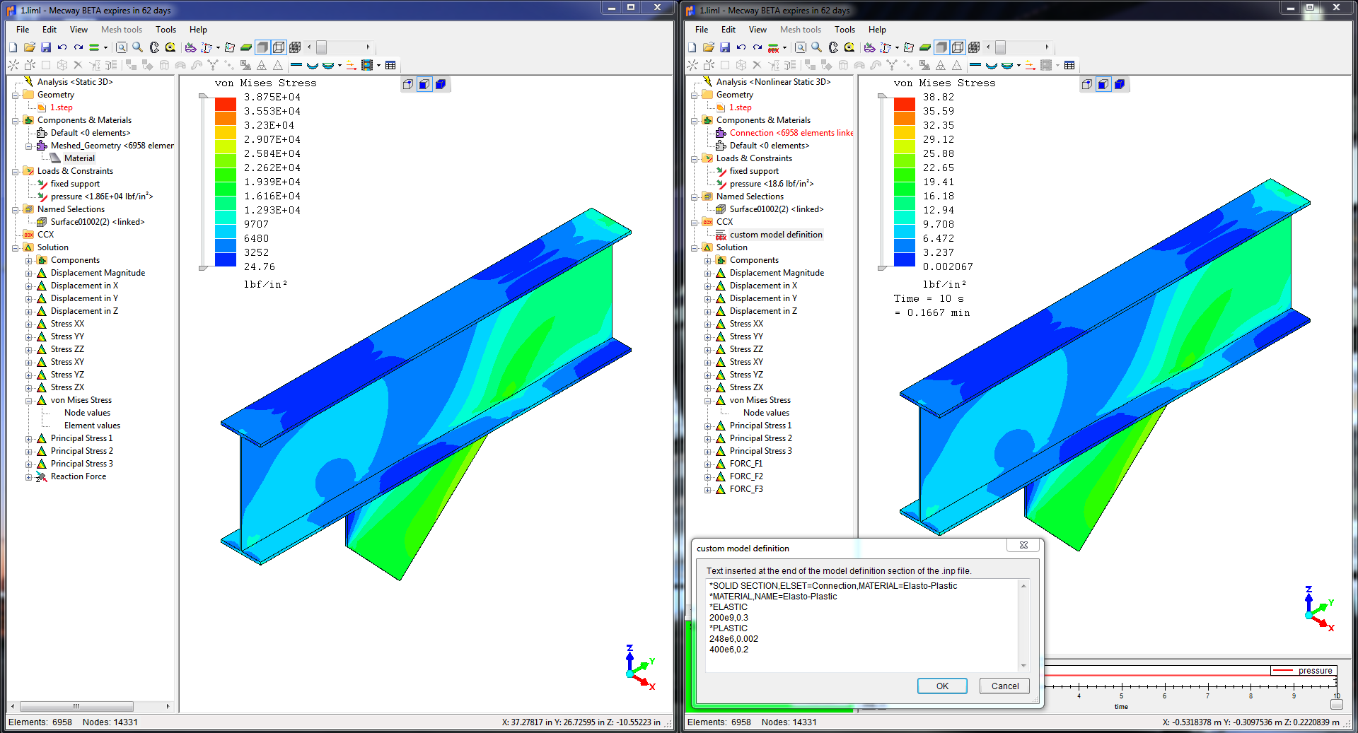

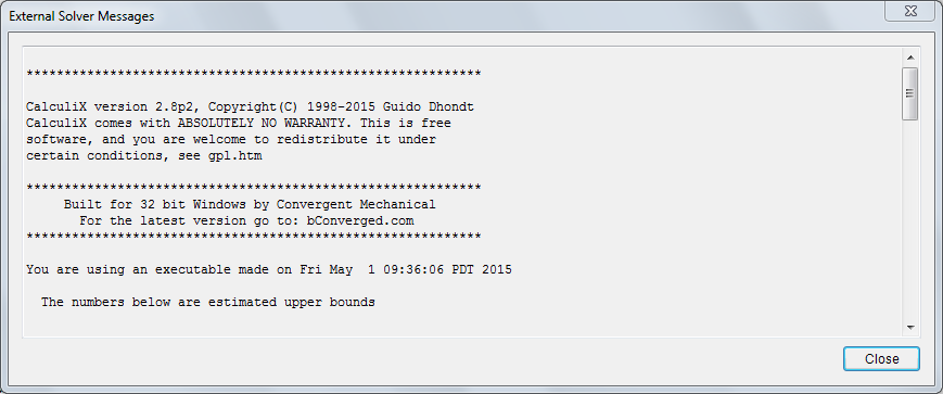

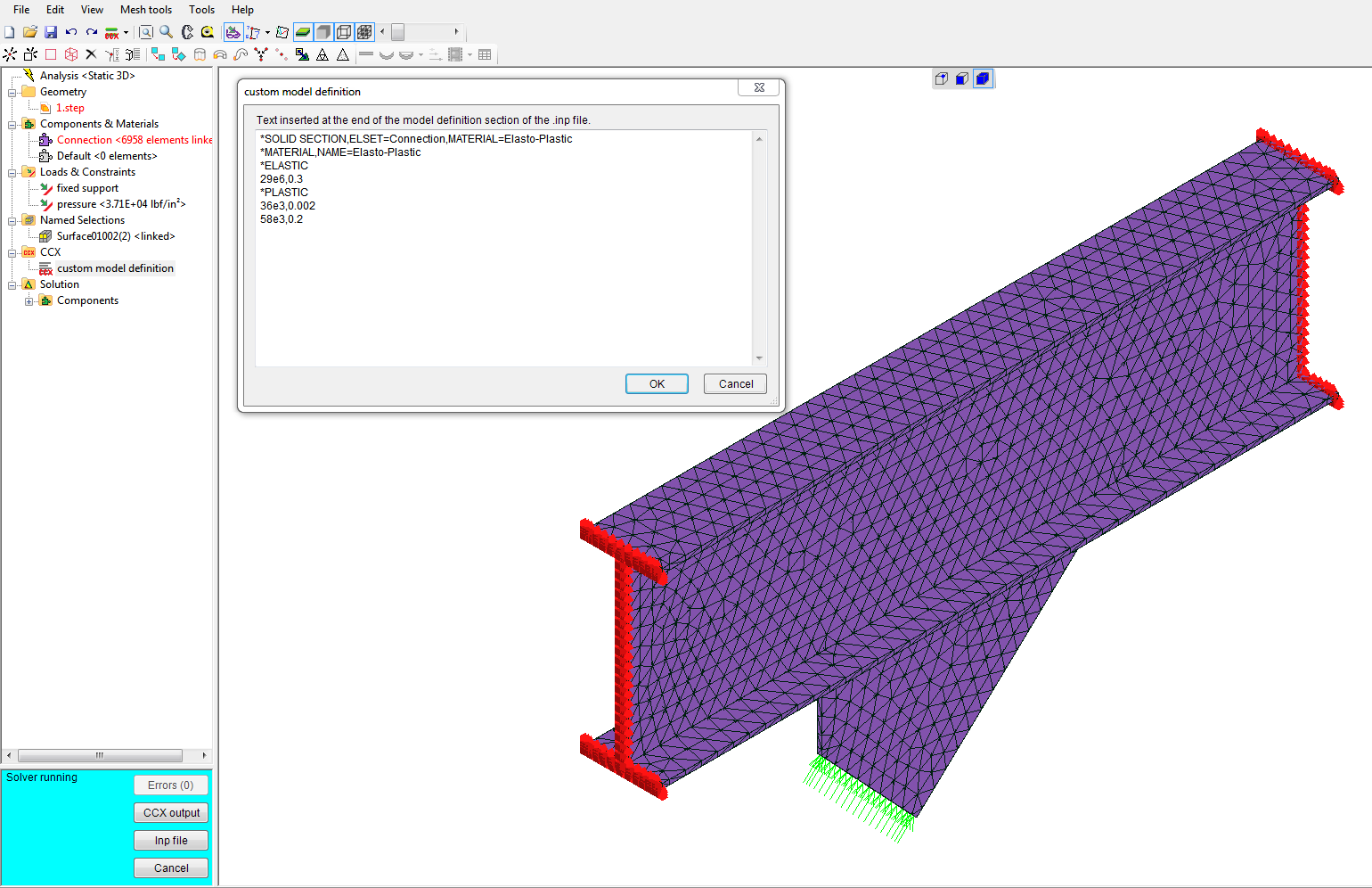

    Victor, per my email to you, I found my error trying to run CCX. I used an older version (2.7 build 002) from bConverged. I downloaded and installed the newest version (2.8 build 003) from bConverged and it run find now and recognized all of the outputs like Mecway plus more that I didn't see before. I compared the results and they are identical for linear static with linear elastic material.
    I couldn't generate or make edits using the 3 new features (custom model definition, custom step contents and don't generate keyword) in the CCX branch of the outline tree. I can right click to create say custom model definition and enter in the inputs but couldn't save or create it (there not save button. see attachment). Can someone shows me a few screenshots of the process of creating one?
    Overall, version 4 included almost all of my requests in just one update! Thanks Victor! This is great!

    Rhoka:

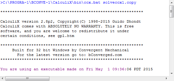

    I think the .frd file you posted is faulty. The CGX 2.8 manual says the field variables should be in the E12.5 Fortran number format. That has 12 characters in each number. But the negative numbers in this file have 13 characters. The attached picture shows your .frd file side by side with one I generated from your .liml file. You can see that it has an extra digit on many numbers such as the final number on the highlighted line (-8.71629E-003 instead of -8.71629E-03). CGX seems to read this as 8.000000E+000 and Mecway sees it as 0 - probably because it can't parse it at all and defaults to 0.
    Is there anything different in how you're calling CCX from Mecway compared to the command line? Maybe in your path there's another version that was compiled differently? EDIT: I see the output headers you posted show that it's the same executable. So this is even more mysterious.
    The .copy file is copied from the original .inp file when you press the "Inp file" button in Mecway. That's because CCX may be busy reading the original .inp file at that time so it can't allow edits to it simultaneously.

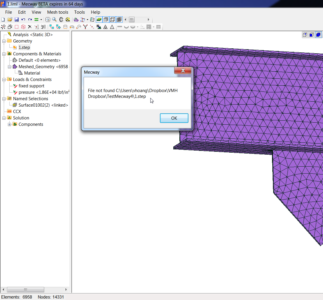

  • Victor,
    Can we have the option to relink the geometry file if we rename our folder or relocate the project files to another place for archive (see attachment that the path to the geometry file was lost after I renamed and move the project files). Thanks
  • Sergio:
    3 and 4) I have the philosophy that all the data should be defined in one liml file as much as possible. I realize that some people prefer/need to have multiple files so different tools can operate on them, and to manage unwieldy/changing mesh files. However, this is the opposite of what I'm trying to do with Mecway so it's perhaps is outside of its scope. I hope all the problems that lead to needing multiple files can be solved within the single GUI instead.
    You can define extra materials and boundary conditions using the new "custom model definition" and "custom step contents" features. The manual has an example of a material with bi-linear hardening. There might be some things you can't do with these 3 features but I haven't found any serious ones yet. I haven't tried rigid body specifically, but if it can be inserted at the end of the model definition or step section then it should work.
    Please let me know if this doesn't help. If you make multiple versions of meshes with other software and define BCs manually, it might be that Mecway isn't a good tool for that type of workflow.

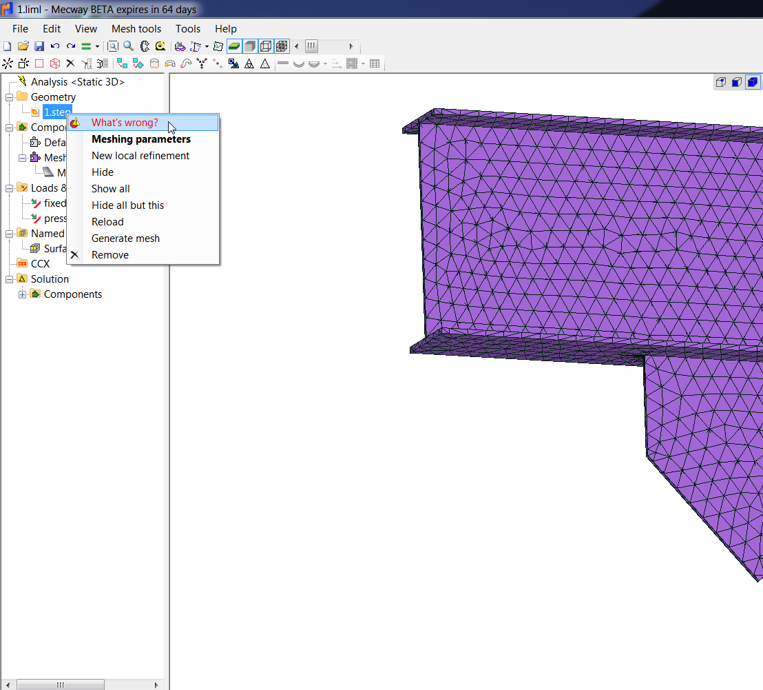

  • VMH:
    I'm surprised at such a big difference. I'll have to specify CCX 2.8 as a minimum or include those alternative names like DISPR instead of DISP in .frd files.
    No OK and Cancel button on the custom model definition window is a bug. Thanks for finding it! A workaround is to set Window's resolution/scaling factor/'Change the size of all items' to 100% if you currently have it at 150% or something.
    Good idea about changing the path for the file. I'll look into it. For now, you can edit the .liml file in notepad to change the path.
  • Victor, I changed the text scale back from 125% to 100% and I can see the okay button. I was able to add the texts (see attached). Thanks for pointing this out.

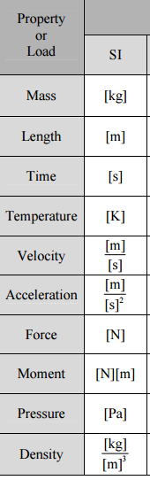

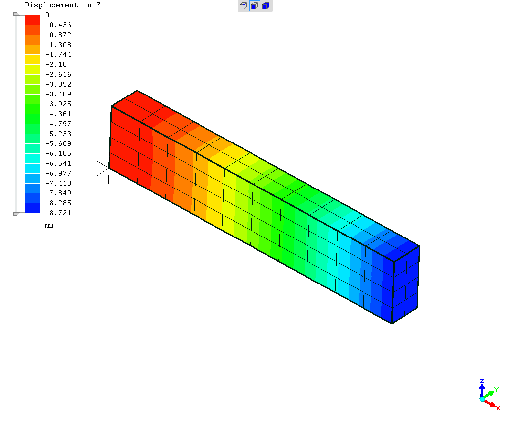

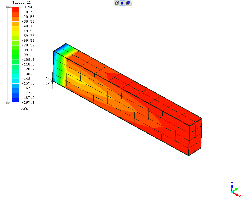

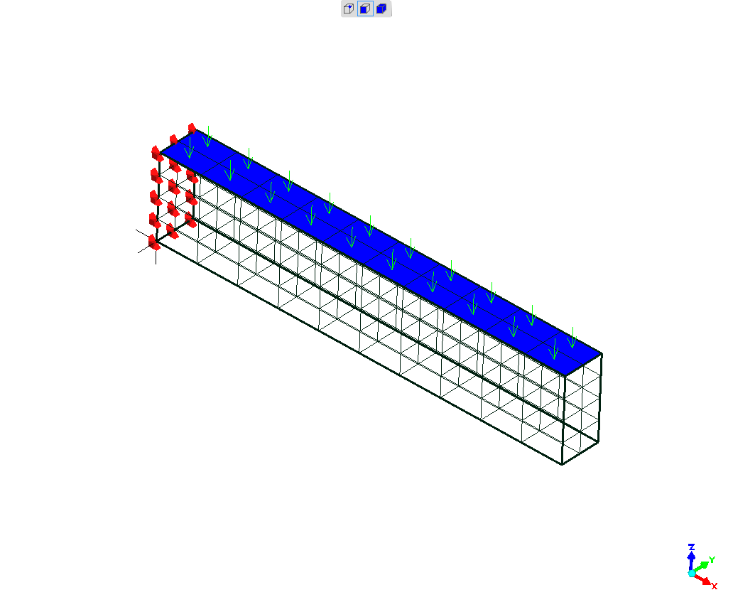

  • Victor, I'm aware that Sergio asked this questions or similar on his Item 7.
    What should be the input units (lb, in) or (N,m) for the CCX input feature? I tried both. If I used (lb, in) same is what I'm using in my model, CCX stopped and said solutions diverge. If I used (N, m), CCX finished and give me the attached results.
    The contour plots are identical if we run linear static with elastic material. For this particular test, linear static with elastic material and nonlinear static with elasto-plastic material should yield the same results since the loading are not high enough to yield the material.
    Notice in the attachment, only the unit is off by 1x10^3.
    Can you help with this? Thanks!
  • .liml and .step files attached.
    edited October 2015
    I did another test. Since my both my deflection and stresses are off by 1x10^3, the unit input may be in (kN, m). So I updated my input and rerun. Just for reference: E=29e6psi, v=0.3, Fy=36ksi at 0.2% strain, Fu=58ksi at 20% strain.
    I was able to match the deflections using (kN, m) instead of the previous (N, m). However, the stress did not match and they different by about the same amount of 1x10^3 even though I already changed the input by 1x10^3 compared to the previous test?
    Please see attachments. Thanks!
  • Victor, I uninstalled and reinstalled the software and it works fine as expected. Using the input units of (N, m) for CCX features work correct. See attachment for compare of Mecway using Linear Static with Elastic Material and CalculiX using Linear Static with Elasto-Plastic Material. They are almost are already identical.
    I'm not sure why I had my results different by 1x10^3 before and now I don't. It must be something wrong with the original install. Thanks!
  • VMH: The factor of 1000 in stress looks like it's because the load was also off by a factor of 1000 (1.864e4 lbf/in^2 vs 18.6 lbf/in^2.
    Any time Mecway converts to or from an .inp or .frd file, it assumes that the file uses the m,kg,s system. However, since Mecway doesn't understand the meaning of what you enter in the custom model definition window, it can't do any conversion here so that needs to be in m,kg,s units regardless of what other units are used in the model.
    I'll see if I can make this clearer in the program because it's obviously confusing.
  • I just checked the files again and that's exactly what happened. My applied pressure for some reason was off by 1x10^3. I caused my own confusions when overlooked simple things like that. Thanks

    I didn't see them appear automatically from the test I did and posted on another topic "Linear Elastic and Elasto-Plastic Materials Comparison". I may need to call it out in the CCX input feature but dont know how yet.
    I'm currently trying nonlinear contact using an example called "Advanced CalculiX Tutorial" by Eng. Sebastian Rodriguez at www.libremechanics.com.
  • edited November 2015
    Hi VMH, I just run a simple test with geometric nolineal and solved with CCX, by default it doesn't show the strains, but if you add a Custome Step Contents to ask for them, it work ok:
    *EL FILE
    S, E
    Now I will try with a geometric and material plasticity nonlineal to see If we can postprocess PEEQ as well.
    Regards.
    Victor, can be Strains (E) and Plastic Strains (PEEQ) turned on by default on nonlineal analysis? And if we want to know how much deformed/strained is the part after unloading, is possible to add another step using the actual input file modifiers? Or could be done by a time table definition for the load aplication?
    Regards again :-)
  • About the custom editions text inputs for CCX, can you add a big remembering of the units on the edition windows :-) ???? You say that must be m,kg,s, what about load and pressure? N and Pa??
