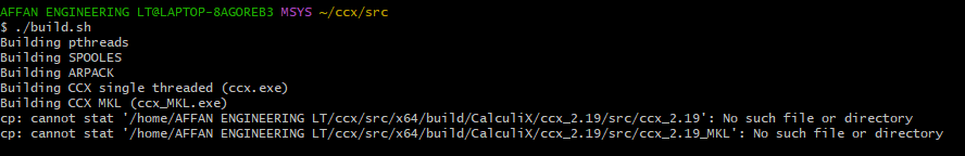

"cp: cannot stat [...] ccx_2.19': No such file or directory"
"cp: cannot stat [...] ccx_2.19_MKL': No such file or directory"
means the final binary failed to be built. Look in x64/buildlog.txt and you should find error messages at the end of the file buried among all the warnings and other messages.
I think it's because your home directory has spaces in its name. That's a known problem and I haven't been able to get the build script and makefiles to work properly with spaces. Please rename it. Sorry for not making this clearer.

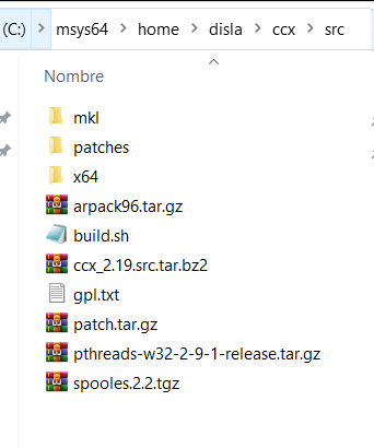

I'm completely newby compiling programs and it worked following carefully the instructions. I have WIN10Pro and installed from the v.16 Mecway folder.
¿Did you execute MSYS2 with admin rights?
You laptop name seems very large and has some spaces ¿isn't it?. ¿Maybe that's a problem?.

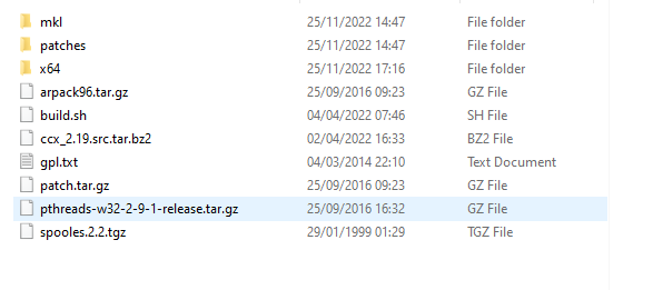

You need to unzip.
In my case it looks like this:
Check those files "cannot stat" thye are where they should
