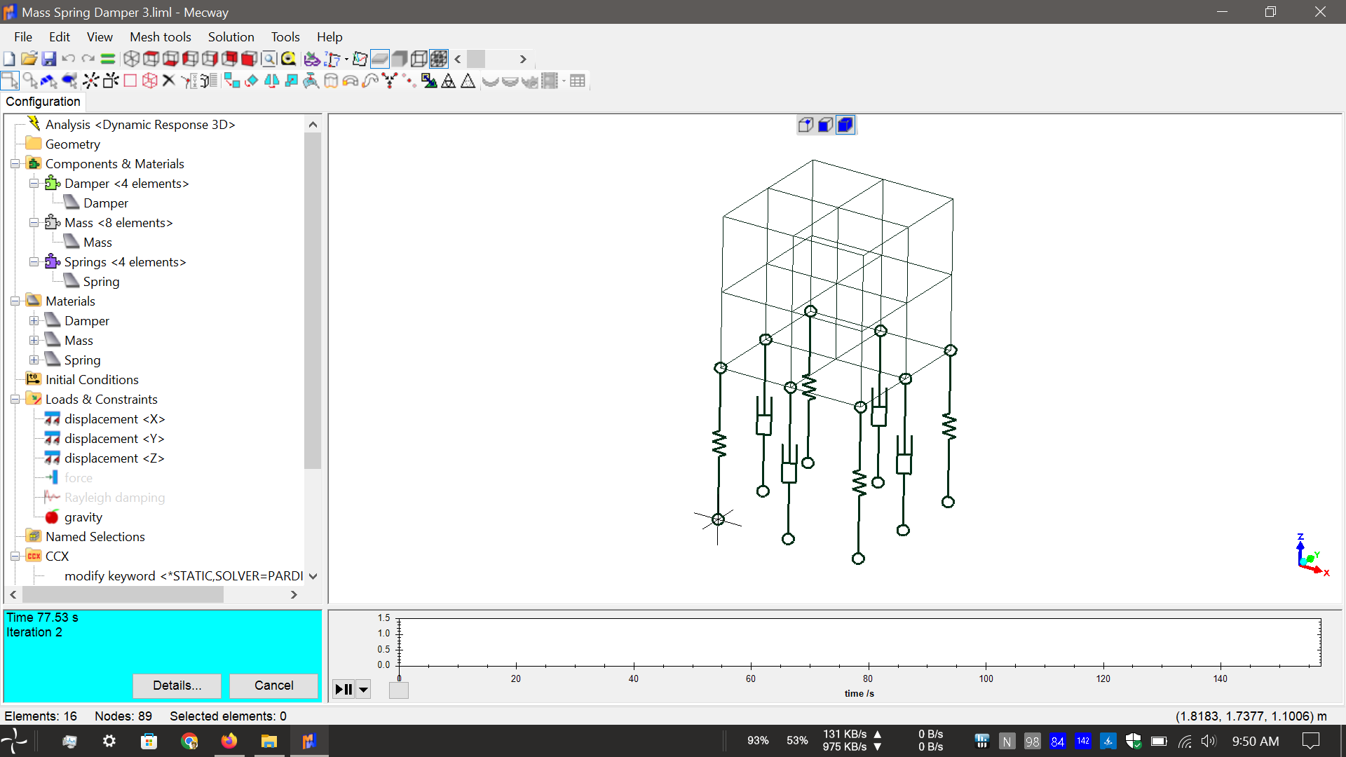

    Just opened a model I made in v17 with v18. The new mass and damper graphics are awesome. Very nice improvement.

  • The new spring element visual representation is awesome! I though that would be visible only in preprocessing, but is also visible and deformable in postprocessing, really really beautifull and usefull to better understanding.
    Coud be added something similar for rigid body?
