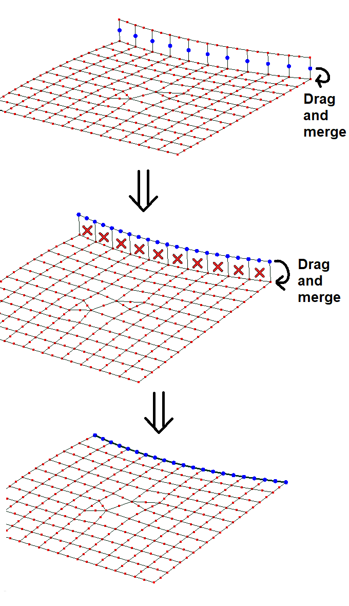

    A way to create line elements on shell edges is select the edge faces, extrude 1 layer in any direction, then move the extrudes nodes back onto the original ones and merge. The extruded shell elements get automatically collapsed into line elements.

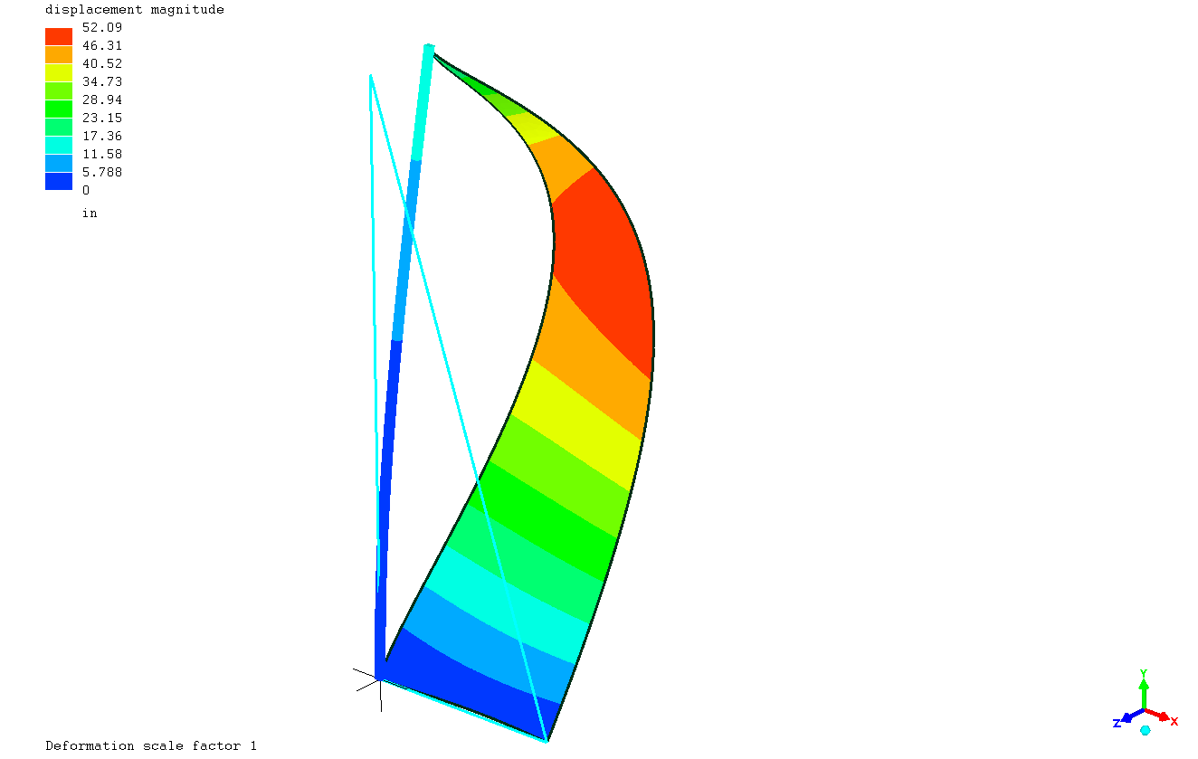

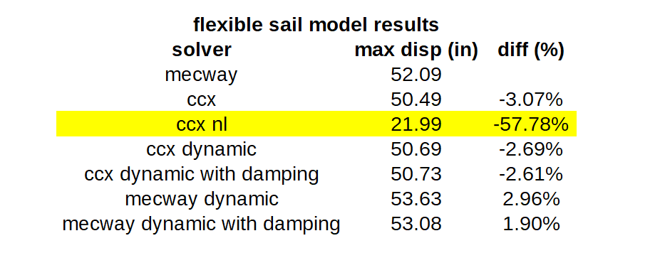

  • hi jmf,
    your model is interesting to me, so I've been playing around with it. i was wondering if the attached images would be closer to an actual sail. are sails really connected to the entire mast? I don't know anything about sails. The reason I ask is I am having all kinds of weird stuff happen when I try to work with the mesh. I think some of the files I attached previously may have some sort of issue. Even though the results were agreeing better. I think there is something weird going on with ccx as far as the beam to shell connections. So I made a completely new model and still had problems. When I only connect the sail to the mast at two points, things agree and also seem more realistic. I still have to figure out how to connect the sail to the entire mast and be able to trust the ccx results. However, I don't know if that is even realistic or was just your first pass comparison.
    notice all the linear models agree pretty well. however, nonlinear is drastically different. that is what i normally see. i couldn't run nl dynamic, as it was taking too long. i also couldn't run modal superposition as it was very slow and when it got to the transfer results to mecway stage it was killing my machine. i had to kill the process after about 30min. i also tried some runs were i added damping. close to a damping ratio of 0.02.

    ok. i finally figured out what was happening. in the original model only the ends of line2 elements were connected to the shells. so if you converted the beams to line3 for ccx the connections were still the same. so the midpoints of the line3 elements were not connected to the sail. i was connecting those to the sail. so i was getting different results. so basically what i found is how many connection points from the mast to sail makes a big difference. connecting all the nodes is the lowest displacement around 8-9 inches. connecting just the ends of the line2 or line3 is around 10-11in. then connecting just the start and the end of the mast to the sail is a huge displacement of 50+ inches. since mecway doesn't support line3 you can't do a comparison of some ways of building the model. however, when you can do a comparison, they aren't too far apart.

    I used Victor process to create the line elements on the shell edge. I succeeded to apply the method to generate a line2-tri3-quad4 mesh. Then I converted the elements to line3-tri6-quad8 with the mesh tool.
    I failed to apply the method with quadratic elements directly.

    yes, i couldn't use victor's method for quadratic elements either. when you do the move it doesn't work right. not sure why.
  • @JMF11, @prop_design, with quadratic elements, you have to also move the midside nodes, not sure if that was the problem.
  • oh thanks. yeah, that is probably it. i didn't select those.
