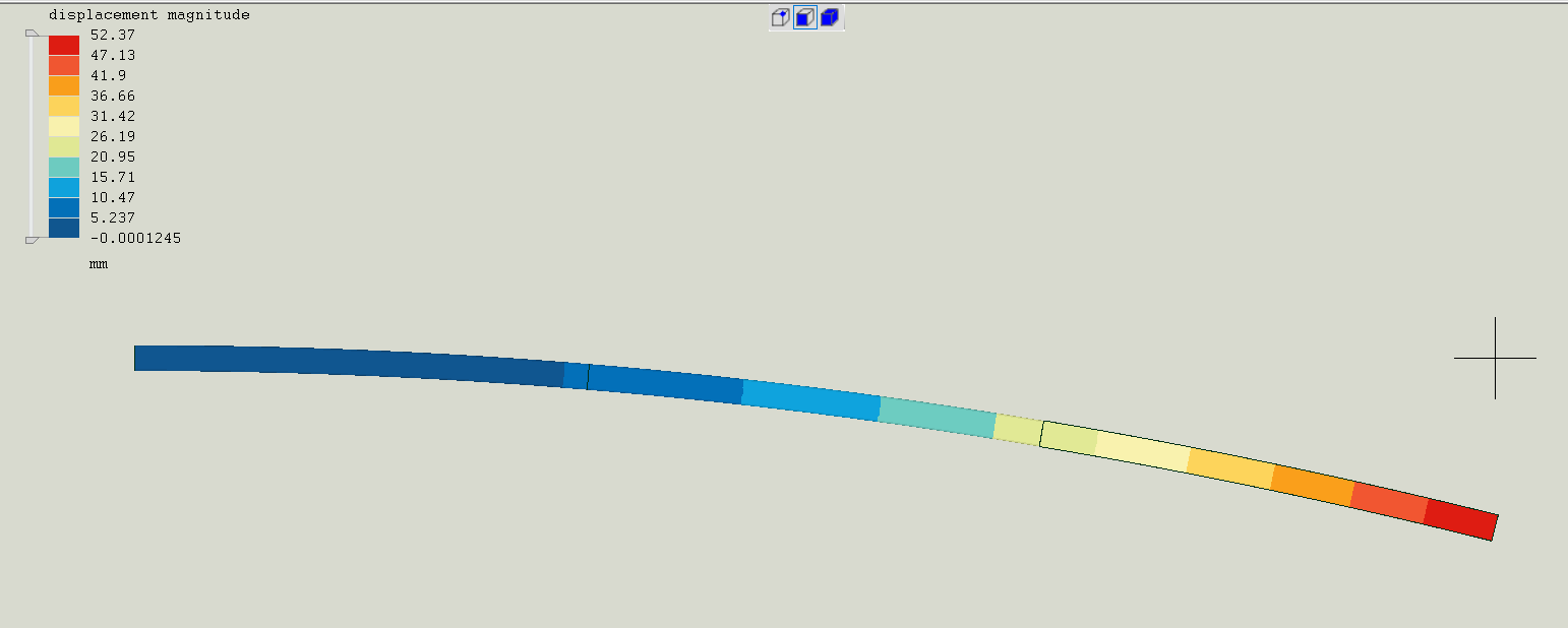

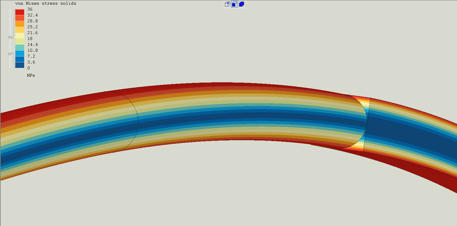

    -ASTM Pipe 4" Sch10s (114mmx3.01mm) modeled as 2m Solid + 2m Shell and 2m Beam connected in series with *SURFACE BEHAVIOR,PRESSURE-OVERCLOSURE=TIED .
    Nice continuity on displacement and stresses.

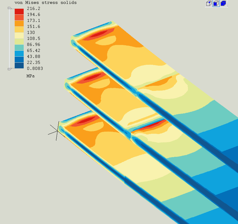

  • The first picture of the post is an example.
    Tie and Elastic with high tangential stiffness might warranty the bodies keep together but it can make some stresses to arise at the contact area. Displacements continuities are usually ok.
    *SURFACE BEHAVIOR,PRESSURE-OVERCLOSURE=TIED + a user adjustable Tangential Stiffness can help to remove those discontinuities even with dissimilar materials and thickness.

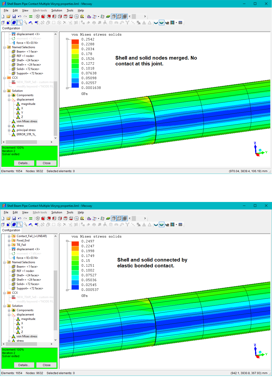

  • I think those stress discontinuities are real if they're caused by differential expansion of the two materials, so they shouldn't be hidden by softening the tangential stiffness.
  • Your comparison between merging the nodes and the elastic contact has convinced me.
    Once the stresses arising by an unproper selection of master and slave are removed , the stresses due to different material properties are totally real.
