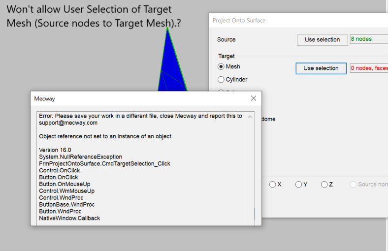

@Victor: 1) I have a set of random nodes (Source). 2) I have a triangular element that I wish for Target. Selection box for Target Mesh does not allow the selection, instead I get a screen error.
Oh, this is a bug. Thanks for finding it, I'll fix it in the next version.
The only workaround I can find is to restart Mecway. You can predict when it's about to happen when the target selection shows "0 nodes, faces or elements" instead of "0 faces".
OK. Yes, I was wondering why I thought it worked the first time (only).
