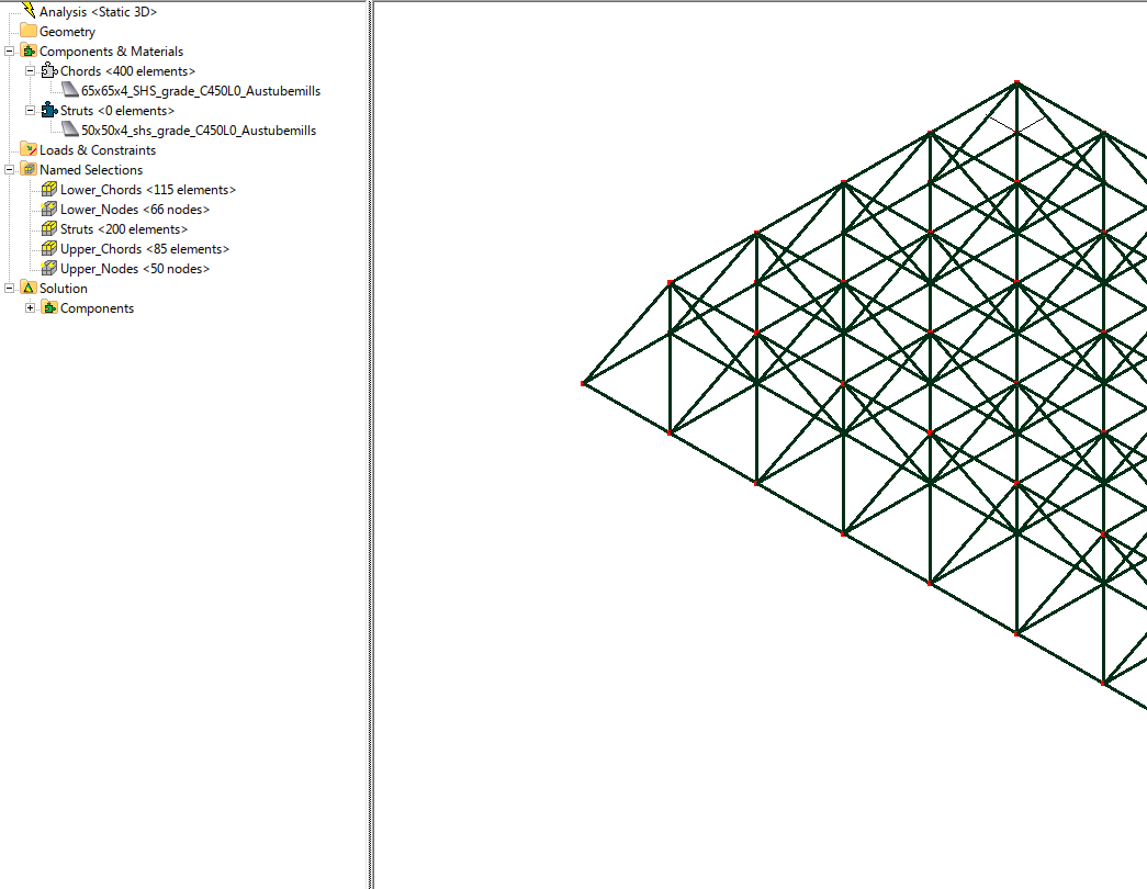

Hi - I am a complete newbie to Mecway. I am trying to set up a spaceframe and I am having trouble assigning materials to named selections. I suspect it is because I created the second SHS profile after I had created the components it was to be assigned to. The result is all 400 members have been assigned the first SHS profile - not what I wanted.
My question is is there still away to assign the different profiles to the different maned section or do I have to start from scratch. All help and advice will be appreciated
  • I figured out how to do it. I selected the strut elements by numbers > right click > element properties > chose struts. Sorry for my impatience.
