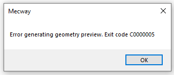

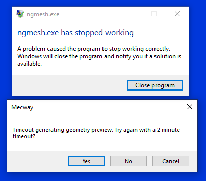

    I tried this but the UI didn't start and I got the following error messages (the first was immediate and the second appeared after several minutes with the first message still open) --
    If click Yes on the second message then the first message is just regenerated. If click "Close program" on the first message then I got the following message --
    If click OK then the first message is just regenerated. If click "Close program" then the last message is just regenerated. If click OK then the model is finally loaded but without results (can be resolved with "\Analysis\Save after solve" about which I may inquire later.)

    Oh dear, that failure with the geometry preview is terrible! I'm not sure what's wrong and can't find a workaround yet but I'll fix it for the next release. Sorry for such a frustrating experience.
