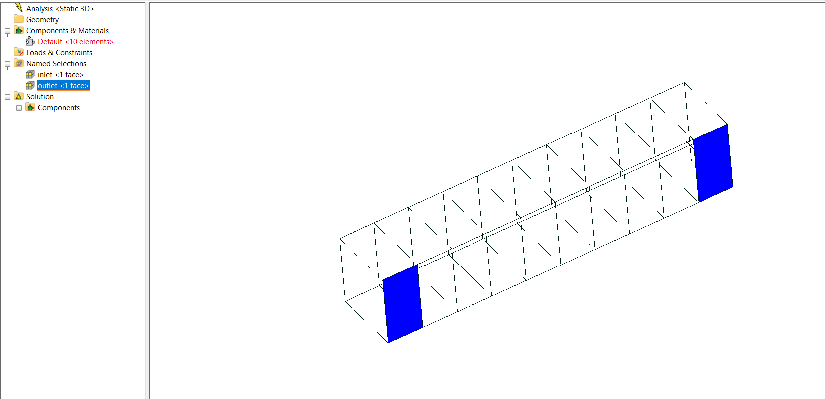

I noticed Mecway has a .msh file export option - I wonder if it was possible to add named selection faces as physical groups as part of the export? That would allow me to do all my preprocessing for OpenFOAM in Mecway which is much nicer than the Gmsh interface.
Eg. add inlet and outlet faces as physical groups on the .msh export file.

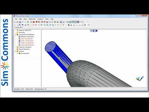

  • There are some very well explained tutorials in Youtube on how to prepare the models for OpenFoam in Mecway. They export the initial model as STL and then the mesh is created with OpenFoam with some available to download windows scripts.

  • Have used very little, but they are not complex to understand if you open with a text editor. I will make a new approach to OpenFoam.
