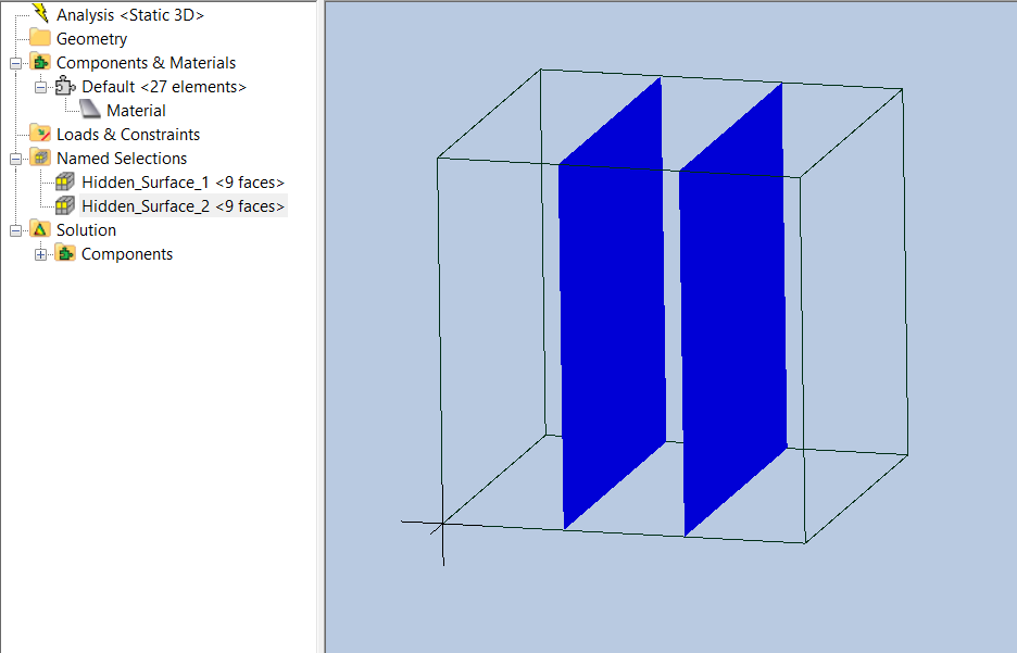

    If the faces are aligned with the XYZ maybe, you could expose them using the slice bar. Then you can select and create a surface selection for easy access in the future.
    If they are not aligned with XYZ, I would split in two components just temporary , only for the face selection.
