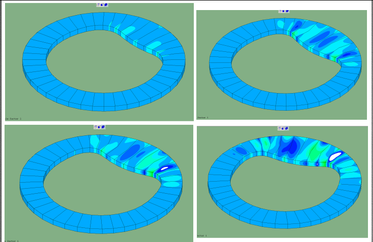

I guess that must be a very hard problem to solve. One option could be pointing to the direction you foresee your model is going to finish or work as usual with Vm or equivalent invariants. In the pic I have rotated it only AFTER the load has finish. ( In- plane Shear Stress)

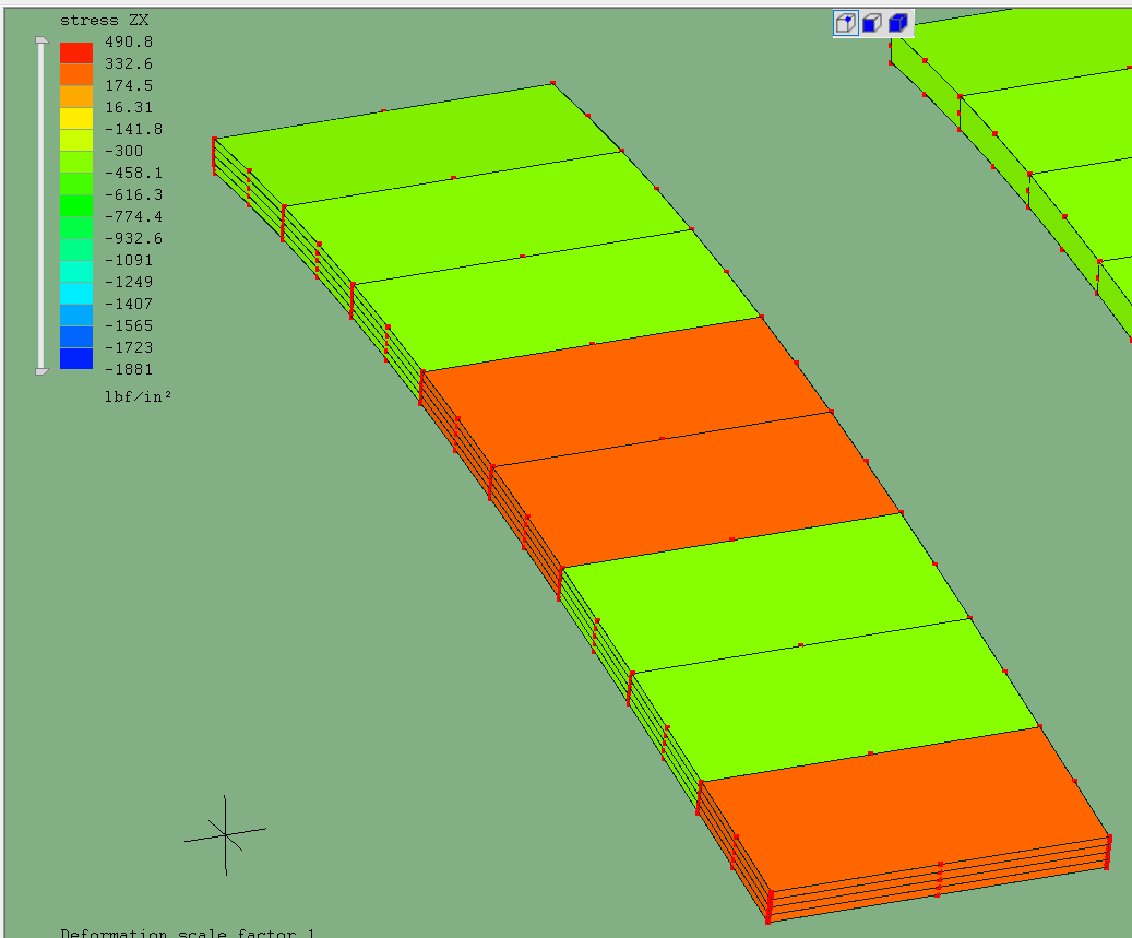

I think I catch you. That would explain why I have seen shear stresses with the same value but oposite sign one beside the other while the overall Von Misses was correct. That means the local axis is inverted in that element. Defining only one axis in a shell is ill conditioned as there are two normal. I think this is possible because shell element can be inverted and still work. Solids do not allow that. I liked that old “Propagating orientation to neighbors tool ”. It was deprecated for some reason. I remember asking you about that some years ago.
My intuition says "That potential explosion of *ORIENTATION blocks" could be a sudden "Pop/sign reversal" of normals associated with the usage of Euler angles that may lead to known singularities at specific angles.
Yea that sign reversal on a curve does look like what you say. It should happen when the shell's normal is within 0.1 degrees of the X axis.
