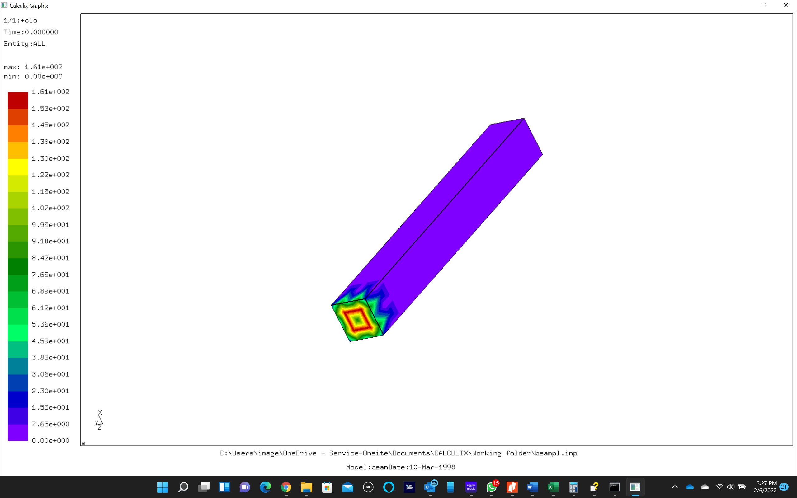

I just installed the 2.10 version of Calculix and during the testing as per the guide, I had a different display of the solution; the image from the one on the guide has concentric rainbow colors along the longitudinal axes depicting the load, the one produced by my "RUN" is limited to one end and the color gradient is only of the small face of the beam.
can someone. help me as to the reason and solution?

Did the solver show any error messages? If it didn't converge, you might be seeing a wrong solution.
