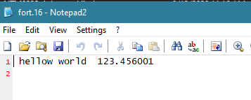

  • Hello Victor
    thank you very much for your information. I tried the following:
    test.exe is a small program like "Hello world" compiled with both Freebasic and Fortran, it also applies to a more complex Fortran program with graphics output. So it should not depend on the compiler used.
    While testing the following lines I made the following observations
    import subprocess
    subprocess.call("notepad.exe") Works!
    import subprocess
    subprocess.call("test.exe") works only if test.exe is in the folder Mecway14
    import subprocess
    subprocess.call("C:\temp\test.exe") does not work if it is located elsewhere and the path is specified. Resulting in error message:
