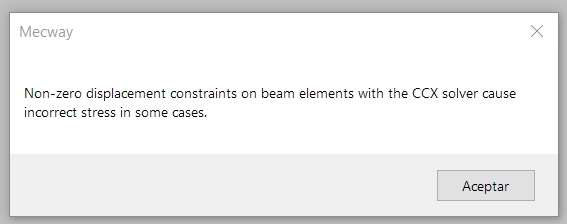

    As MECWAY noticed and warn, displacement BC on shells and beams sometimes causses incorrect stresses in ccx. This issue is the same, it is related and can be fixed the same way. If BC's are imposed at once, the displacement/stresses will be wrong. It needs to be introduced in tree, one for each direction. I post it in Calculix forum as it affects Nonlinear too. The model geometry cannot be updated correctly so it fails. Hope it is this and can be fixed.

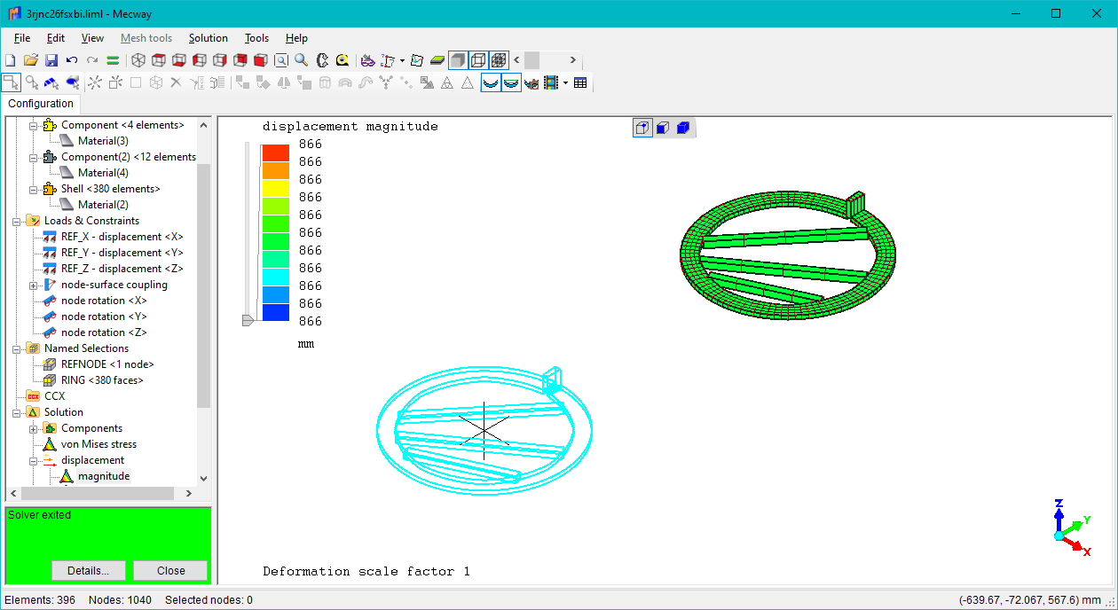

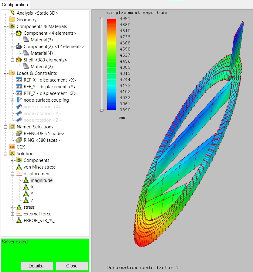

  • edited January 2022
    Another example that I have convert to Shell element. Try to solve the rigid body motion without constraining the Rotations of the reference nodes. It finishes that it is not a rigid body.
    @prop_design you can see in the picture I'm getting 4951mm of displacement.ccx V2.19 on Windows 10.

  • @disla. I'll try with 2.19 and get back to you. Seems OK on 2.17 with the 3 node rotations suppressed except the solution doesn't complete all the way to 100%.

  • That's the normal way unconstrained rigid body rotation works in FEA (and in real life!). You sometimes get a random rotation or solver failure. It's still a correct solution but there isn't a unique solution.

  • I've reproduced the failure of Distributing displacement not responding-2.liml that happens when you suppress all 3 node rotation constraints. It happens in both CCX 2.17 and 2.19.
    It also happens when I extrude the mesh to solids. I'd rather focus on the solids first because shells aren't technically supposed to work reliably but solids are. Now I'm trying the attached model that has solids, no rotation constraints, and explicitly ramped displacements. I'll get back to you when I find more.
    It looks like Distributing displacement not responding-2.liml fails because of the extreme deformation which is way beyond what a linear material can do correctly anyway. I also get a solver failure with the rotation constraints enabled but the displacements doubled, success with slightly smaller displacements and rotations disabled, and failure with displacements doubled and applied to the rectangular face selections and all node-surface couplings disabled.
    Overall, I think everything's working correctly here and both versions of CCX seem to be equivalent, at least for *RIGID BODY. I haven't looked at *DISTRIBUTING in CCX 2.19 yet.
