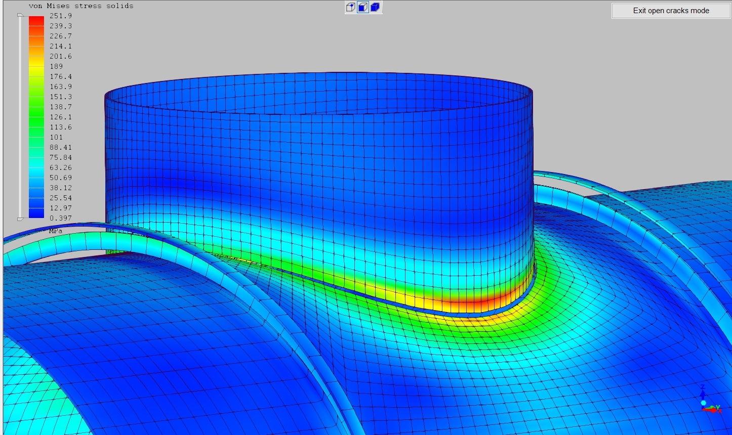

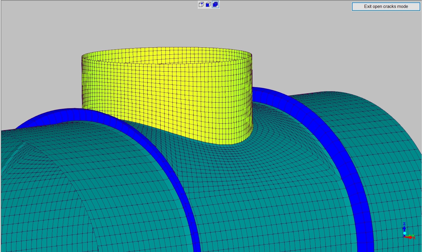

Hi Victor,
I’m pretty sure it is an artifact but when opening cracks in the solution windows the model seems it is broken at some points. In the modeling window looks ok.
¿Should I worry?
  • Not something to worry about. When CCX expands shells to solids, it sometimes joins them together with shared nodes as you'd expect but sometimes it separates them and connects them with MPCs so they're disconnected in the mesh but still connected mathematically in the solver.
