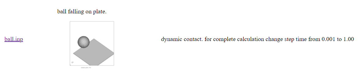

  • Hi, in the CCX examples, there is a file called BALL or something like that with DYNAMIC, EXPLICIT and CONTACT cards included.
  • Hi Sergio, did you mean this example (see attached)
    that seem to be implicit dynamic
