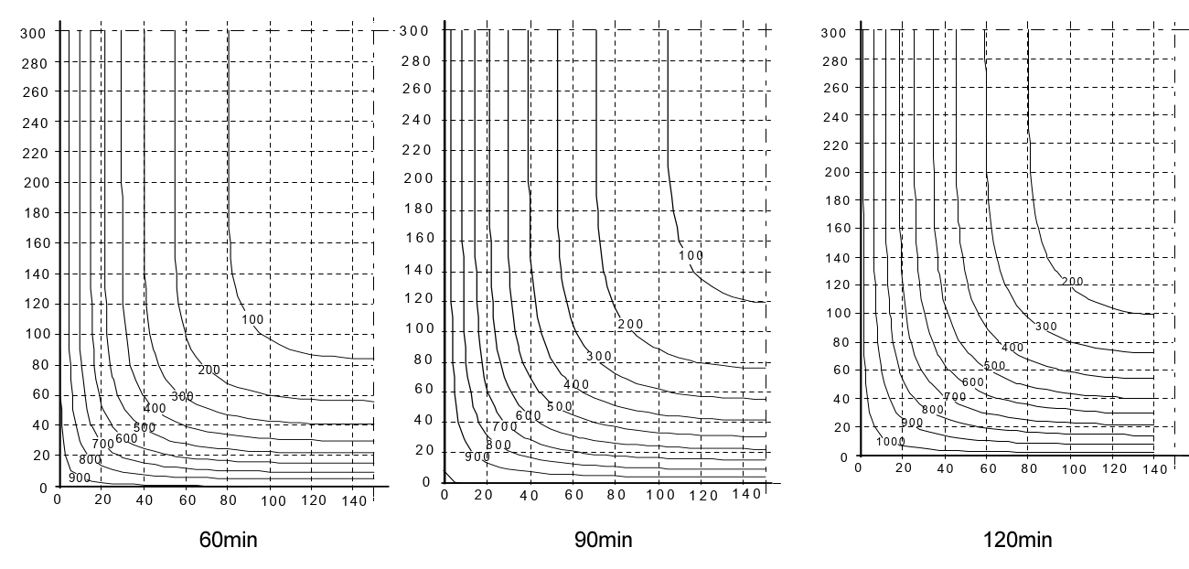

***First of all, to assess thermal results accuracy, I've checked temperature distribution comparing temperature profiles specified by EC2 for a 30x60cm beam with Mecway results.

1) Mecway thermal results seem to be very closed to EC2 profile temperatures.

    P.S.: I'm attaching isothermals from EC2 for a 30x60cm beam and my liml file for validation of thermal analisys in my case study.

    Annex A represent the temperature in the crosssection of beams and columns taking symmetry into account.
    As it is representing 1/4 of the beam (page 63) it means the simmetry is in both planes. That means the fire could probably have been considered acting from the 4th sides not three as you are imposing in your BC.

    Disla, well observed. So if the isothermals are for 4 sides exposure, then my thermal analisys in Mecway for initial validation (viga 300x600) may not be accurate because I simulated 3 sides exposure...I'll try with 4 sides exposure.

  • GEMADA, I run your analysis. Great job.
    Your temperatures over time are almost exactly the ones from the EC2-CONCRETE plot. Big accuracy from you.
