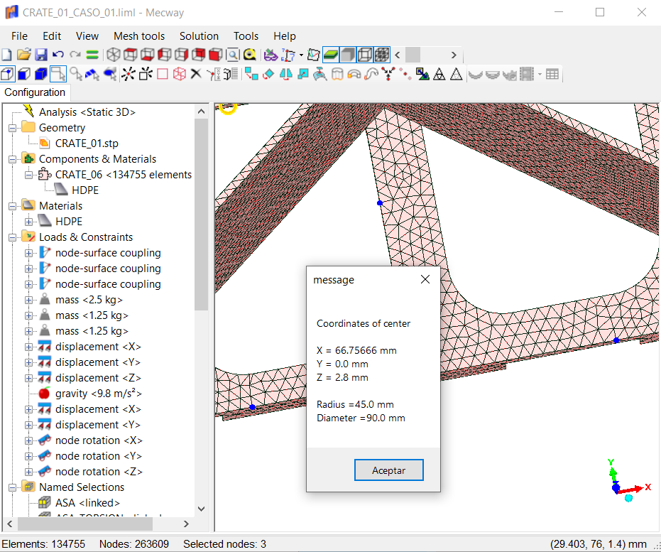

Info window with diameter, radius and center of a circle by 3 points (just info, no node creation)
@Victor, is there a way to know which length units the user is using? I have hardcoded the results in mm, but would be nice to inform in user units.

X_center_mm = str(X_center*1000)
Y_center_mm = str(Y_center*1000)
Z_center_mm = str(Z_center*1000)
R_mm = str(R*1000)
D_mm = str(R*2*1000)
STR_center = str("Coordinates of center" + "\n\n" + "X = " + X_center_mm + " mm" + "\n" + "Y = " + Y_center_mm + " mm" + "\n" + "Z = " + Z_center_mm + " mm" + "\n\n" + "Radius =" + R_mm + " mm" + "\n" + "Diameter =" + D_mm + " mm")
mw.message(STR_center)

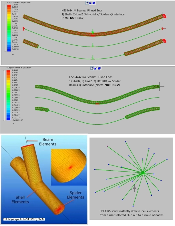

Spider Beams tool. Draws Line2 elements from a center Hub (origin) to a selected cloud of nodes.
Transition easily from line elements to shells. Save your node budget for areas of interest. Hyper-stiff Spider Beams can approximate behavior of an RBE2 element if set up with care. In my tests I increased Modulus of Spiders between 10e3 to 10e6 greater than the part, chose Spider widths that would fill the volume spanned, and came within 3% (form, displacement, vM) comparing actual Nastran RBE2 elements against Mecway Internal solver.
Same behavior is seen with a meshed hyper-stiff diaphram, but I think Spiders are quicker to set up, and maybe a fun little script to run.

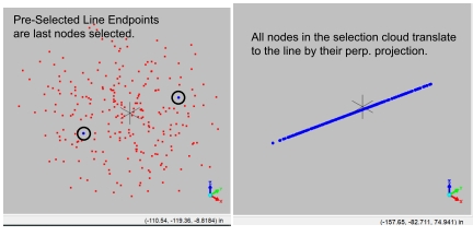

@cwharpe, did you know that you can project a set of nodes onto a plane parallel to the 3 global planes by using Mesh tools -> Node coordinates? If you leave some components blank, they're not altered.
As for 3-point plane, I think it's almost as easy to create a temporary tri3 element then project onto surface onto that?

# Get the coordinates of the points that define the circle from 3 selected nodes.
# Given three points in space (A,B,C)perimeter_node_ids = mw.selected_nodes()
point_1 = mw.node(perimeter_node_ids[0])
point_2 = mw.node(perimeter_node_ids[1])
point_3 = mw.node(perimeter_node_ids[2])
# ... do some math but not this ...
Xa=point_1.x
Ya=point_1.y
Za=point_1.z
Xb=point_2.x
Yb=point_2.y
Zb=point_2.z
Xc=point_3.x
Yc=point_3.y
Zc=point_3.z
# Lengths of AB, AC, AC
AB = (((Xa-Xb)**2) + ((Ya-Yb)**2) + ((Za-Zb)**2))**0.5
BC = (((Xb-Xc)**2) + ((Yb-Yc)**2) + ((Zb-Zc)**2))**0.5
AC = (((Xa-Xc)**2) + ((Ya-Yc)**2) + ((Za-Zc)**2))**0.5
# Direction cosines of AB(ABi,ABj,ABk)
ABi = (Xb-Xa) / AB
ABj = (Yb-Ya) / AB
ABk = (Zb-Za) / AB
# Direction cosines of AC(ACi,ACj,ACk)
ACi = (Xc-Xa) / AC
ACj = (Yc-Ya) / AC
ACk = (Zc-Za) / AC
# Cosine of angle BAC
cosBAC = (AB**2 + AC**2-BC**2) / (2 * AB * AC)
AD = cosBAC * AC
CD = (AC**2-AD**2)**0.5
# Position of point D, which is C projected normally onto AB
Xd = Xa + (AD * ABi)
Yd = Ya + (AD * ABj)
Zd = Za + (AD * ABk)
# Direction cosines of CD(Cdi,CDj,CDk)
CDi = (Xc-Xd) / CD
CDj = (Yc-Yd) / CD
CDk = (Zc-Zd) / CD
# Direction cosines of normal to AB and CD
# to be used for rotations of circle center
Ni = (ABk * CDj)-(ABj * CDk)
Nj = (ABi * CDk)-(ABk * CDi)
Nk = (ABj * CDi)-(ABi * CDj)
# # Diameter of circumscribed circle of a triangle is equal to the
# the length of any side divided by sine of the opposite angle.
# This is done in a coordinate system where X is colinear with AB, Y is // to CD,
# and Z is the normal (N) to X and Y, and the origin is point A
# R = D / 2
sinBAC = (1-cosBAC**2)**0.5
R = (BC / sinBAC) / 2
# center of circumscribed circle is point E
X2e = AB / 2
Y2e = (R**2-X2e**2)**0.5
Z2e = 0
# Transform matrix
# Rotations Translations
# ABi , ABj , ABk Xa
# CDi , CDj , CDk Ya
# Ni , Nj , Nk Za
# Position of circle center in absolute axis system
X_center = Xa + (X2e * ABi) + (Y2e * CDi) + (Z2e * Ni)
Y_center = Ya + (X2e * ABj) + (Y2e * CDj) + (Z2e * Nj)
Z_center = Za + (X2e * ABk) + (Y2e * CDk) + (Z2e * Nk)
center = Vector(X_center,Y_center,Z_center)
# Create the center node
mw.new_node(center)
@sergio, the API doesn't yet have function to enumerate the named selections or components, so both your suggestions are difficult and probably require reading the file yourself like cwharpe suggests.
Thanks for the Node coordinates tip. Question about Project to Surface in new thread this date.

Purpose: From a selection of perimeter nodes, script connects line elements (Purse) that can be Auto-meshed, which helps patch regular shaped voids in shell meshes. For high-density meshes surrounding a void I wanted to automate a sometimes intensive mouse-clicking effort in forming the lines. Concept derived from Purse-Seine fishing nets.
Beginning from a Hub (last node in selection) script performs a brute force distance calc. to all neighbors, then draws line to that nearest node as a newly created [PURSE] component. Makes that node the new Hub, drops out the used up nodes, then progressively updates the shrinking list until the curve is finally closed (or left open) by user.
PURSE works admirably in most cases, but has trouble with narrow corners or slender cracks because the nearest distance might bridge across said void instead of follow the edge. To be fair, there IS an existing routine discussed in the Forum/Manual that works for Any void shape, loosely call it The Edge-face Extrude/Merge-Back(onto) method, which results in extruded shells collapsing into edge Line elements. But I've been finding PURSE to be a touch easier to employ for most of the voids I encounter (holes), and I submit it as a noteworthy alternative.
