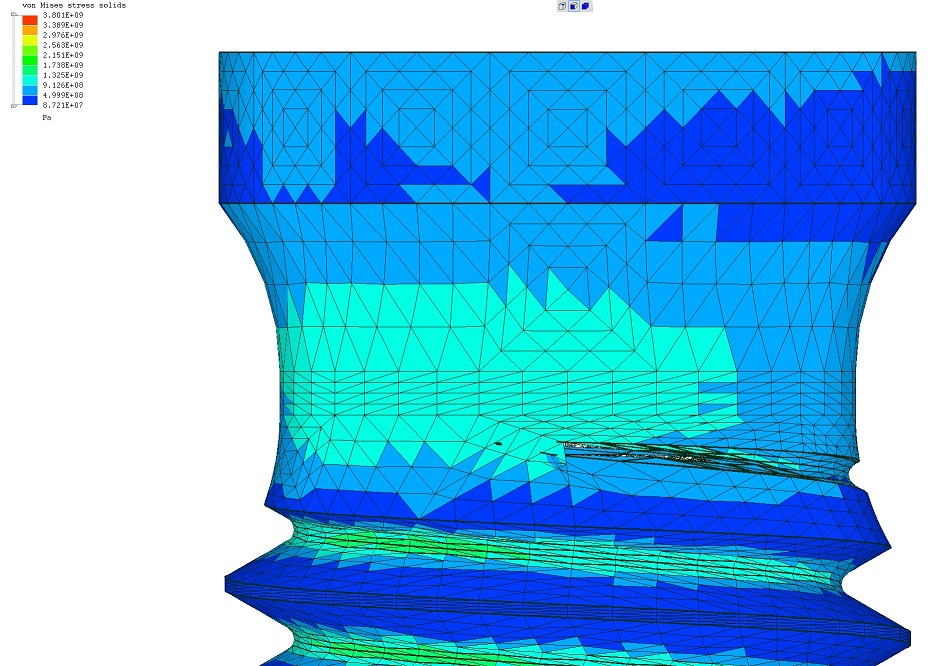

I'm having difficulty analysing this with the level of detail that I think it needs. Does anyone have any suggestions? I've just managed to get a solution using a mesh generated in gmsh and imported into Mecway, then used the CCX solver, but I think that's overlooked a lot of problems in the mesh.

    I would sacrify a little of accuracy using half, or cuarter part if the loading is simmetric, best would be an axissimmetric model. Looks like your elements has not the best shape, I have a feeling that bad shape element can increase the time to solve. My votes are for an axisimetric model meshed with mainly second order cuad, there you could use a very fine mesh.

  • I did make some progress over the weekend since my original post. I got a much better looking mesh by using gmsh through Mecway. I'd previously tried using gmsh completely stand-alone, and then import the mesh in Mecway but I'd made mistakes in the settings which Mecway has avoided.

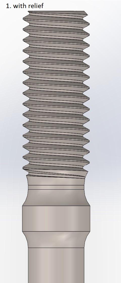

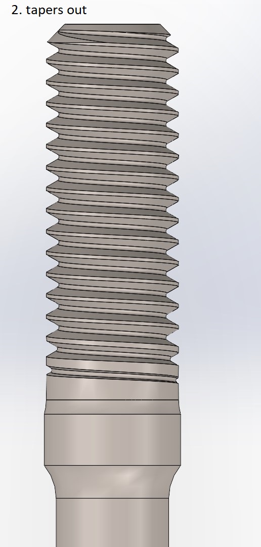

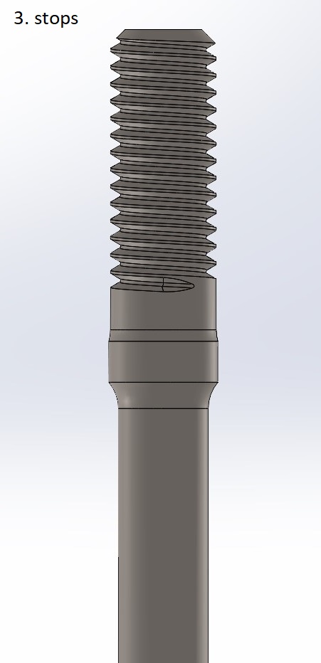

    I'm looking at this not to investigate at the stress in the thread but more in the area it transitions from the thread to the parallel cylindrical portion, so the "the beginning/end of thread root" in particular. I've got three main options to compare:
    1. with an undercut / thread relief so that the cutting tool has somewhere to go
    2. run the thread out, as if cutting tool is pulled away from the bar stock so the cut gets shallower
    3. stop the thread, as if the thread is being ground into the stock, with the feed and the workpiece rotation stopped but allow the grinding wheel to still rotate

    It's version 3 that's got me really focussed on the full 3D model, since I can imagine that the stress concentration where the thread stops could be high, and that's just in one circumferential location.

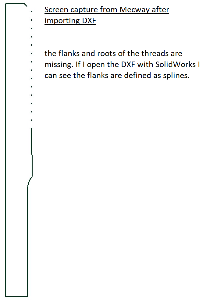

    But... I did try to do an axisymmetric model. But the DXF didn't import fully, the flanks and root of the thread are splines in the DXF and these are missing when I import it to Mecway. Am I doing something wrong there? I would like to try this if only to prove to myself that it's a good way to do it.

  • If your models will differ only in the transition area, you could do a first analysis with a medium size mesh, and then do a submodeling analysis with a finer mesh only in that area, the good news is that you can use the same first main analysis for the three versions.
    For making the axisimetric analysis, you could import a surface model directly, not curves as DXF.
  • Sergio, thanks for the tip about surfaces. I don't use very often, probably never! so I wouldn't have thought of it.
