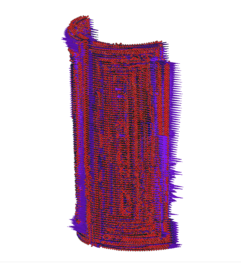

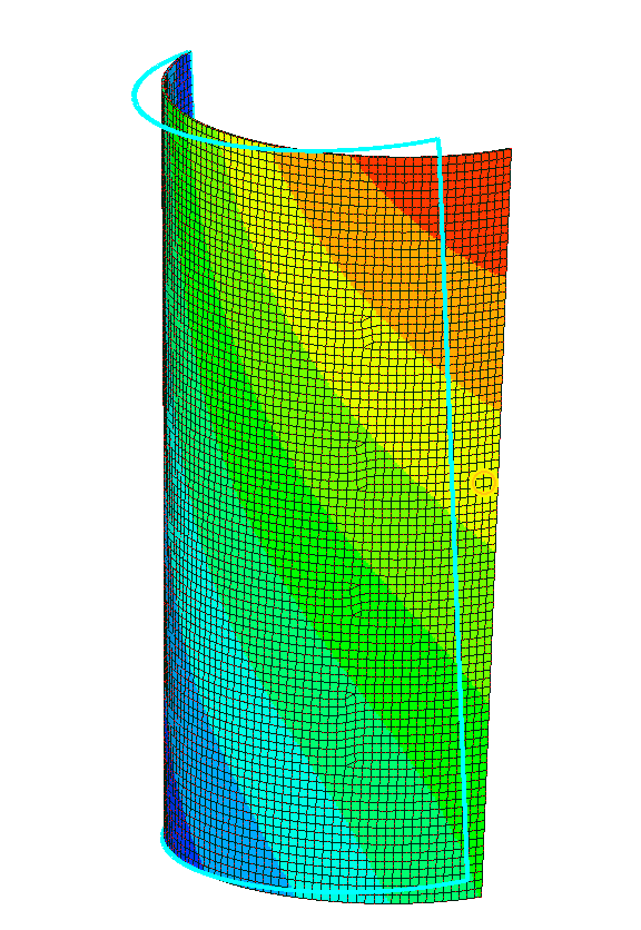

I am trying to export a deformed mesh, and I am having some difficulty. When I run the simulation on a solid body I can export the deformed mesh without an issue, but if I run my simulation as a shell model, I get the error below, and the deformed mesh does not export properly. (Image of deformed result and failed export are attached)
Has anyone else encountered this issue?
