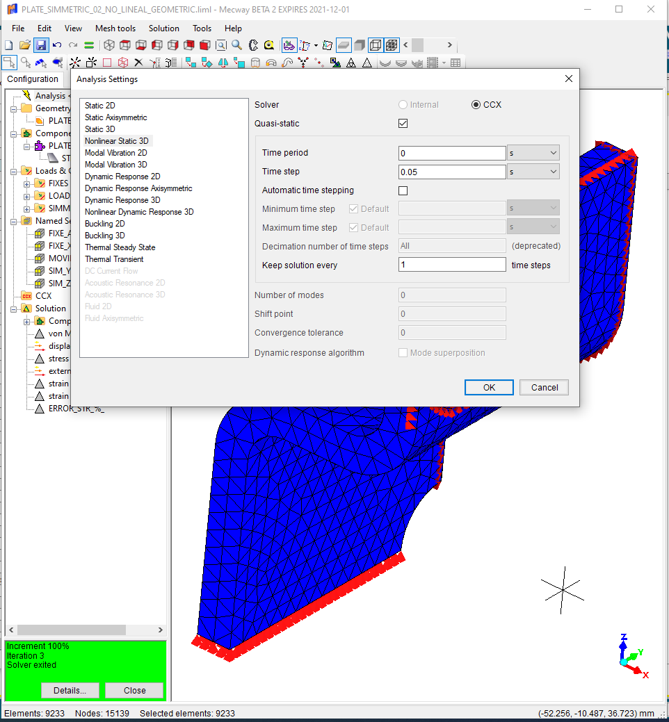

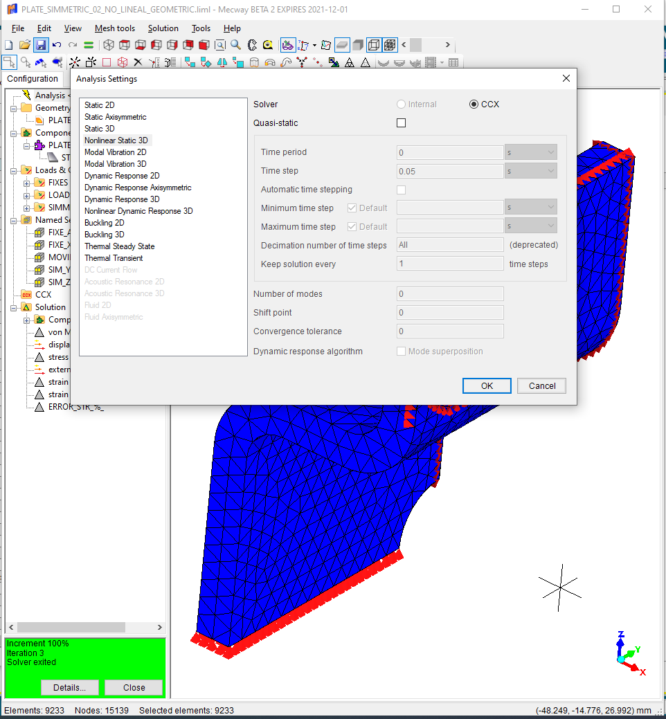

    @Victor, using the beta version, I have defined a quasi static no lineal analisys, but this definition is not keeped when I open again the analisys definition window. Have closed and reopened the model/program and the problem remains.
    EDIT: my mistake, the time period=0 is the problem :-)
