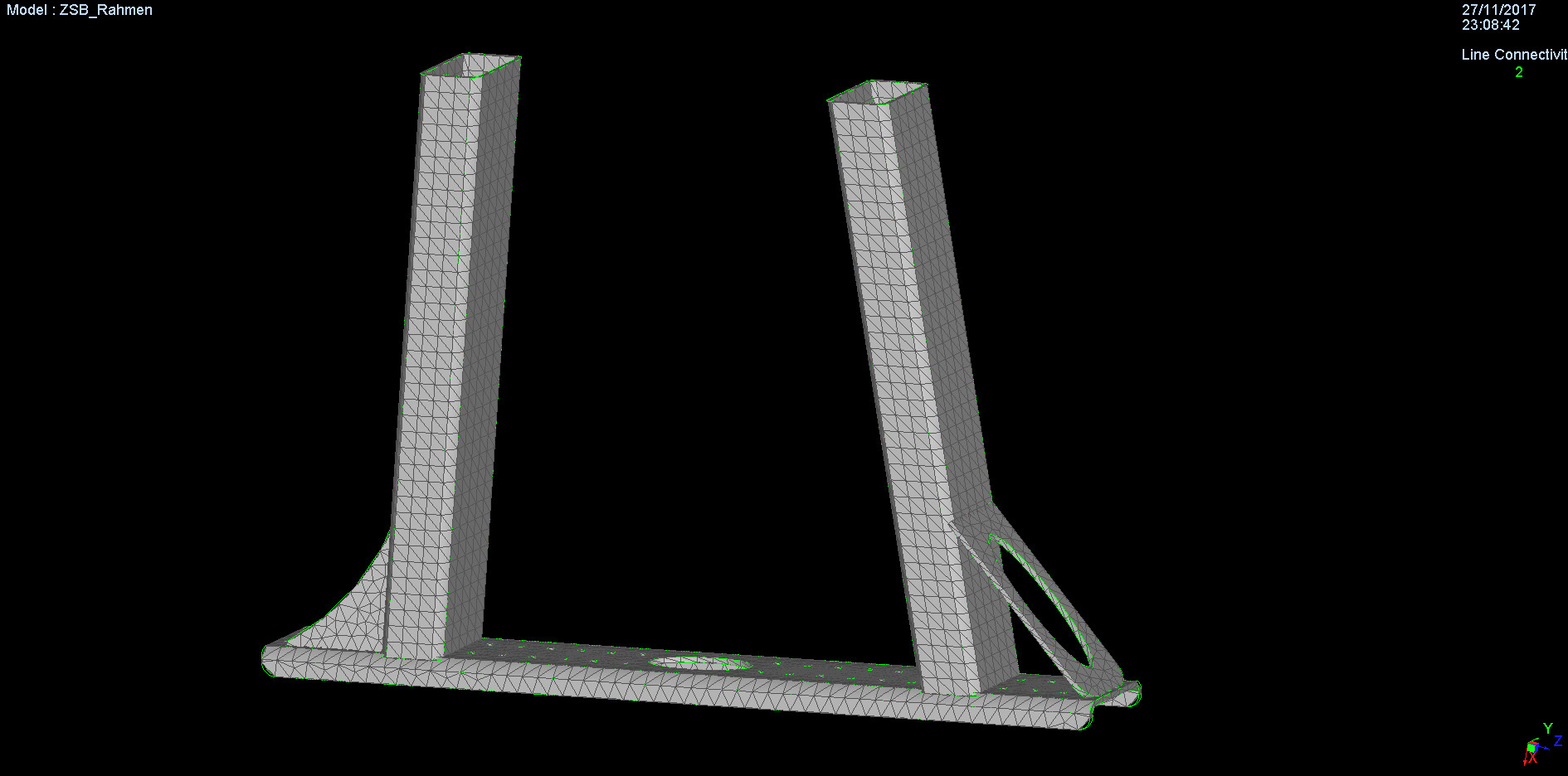

  • Is possible to mesh but considering the part composed by several bodies. Is better to modify the geometry into only one solid body.
    1890 x 936 - 200K
  • Hi Andrea,
    thanks very much! The mesh looks really good for what I want to do. Can you please tell me how you managed to mesh it?
    Regards, Roland

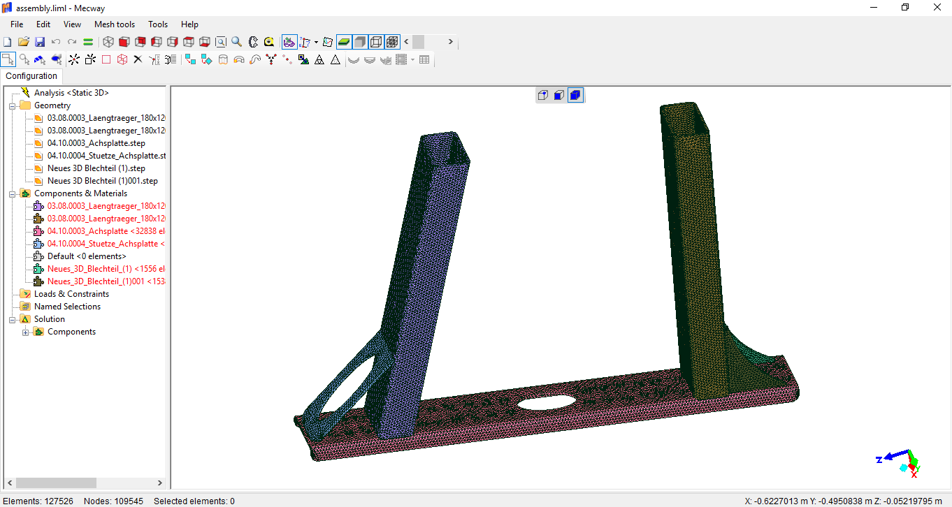

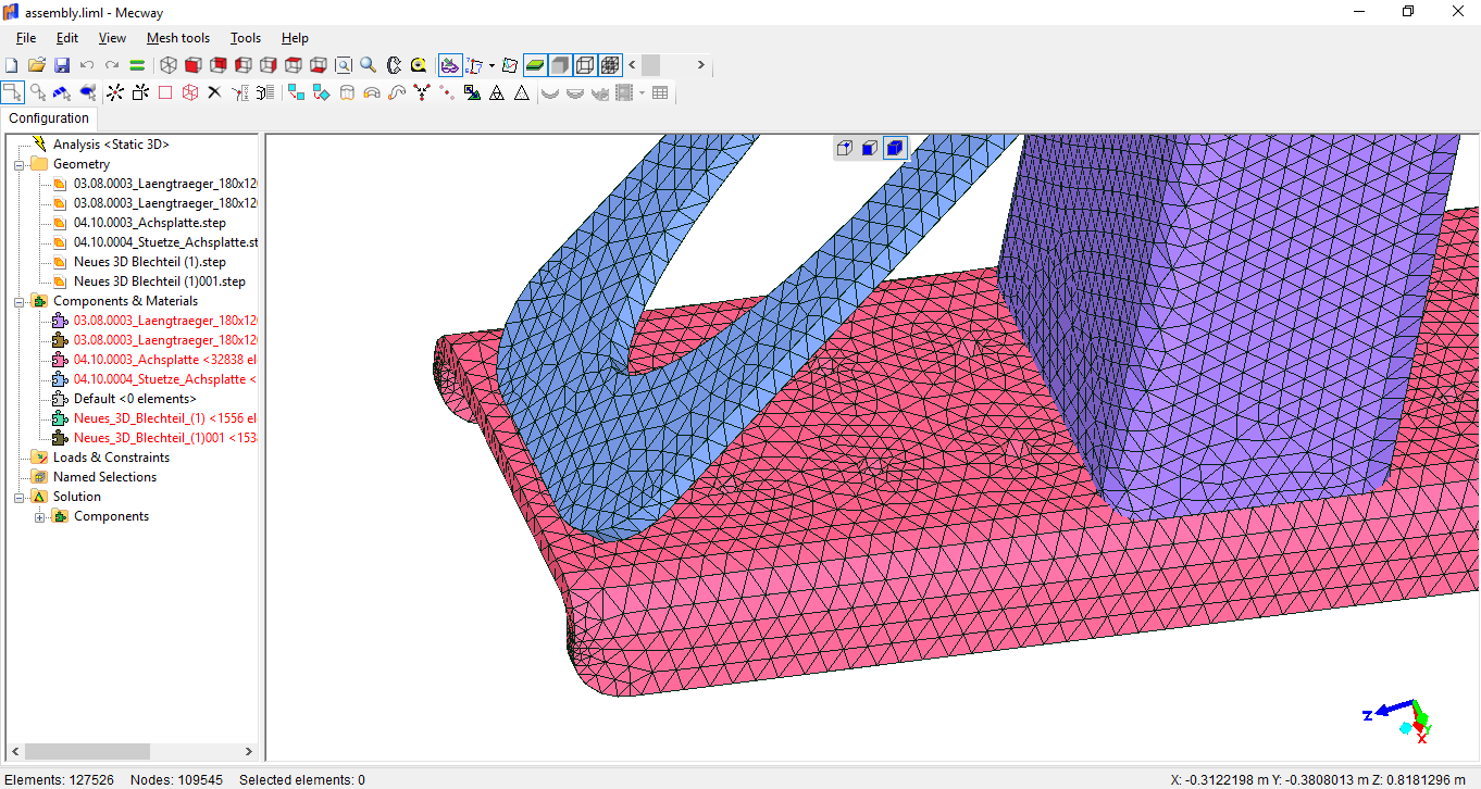

  • In your CAD package open the file and export every component as a single body step file (I did it with FreeCad), then import all in Mecway and mesh separately. Then you must join the parts (meshes) with bonded contacts.
    For this kind of geometry I would mesh it as surface elements with mostly quads and then extrude to create hexas, two or three along the thikness.

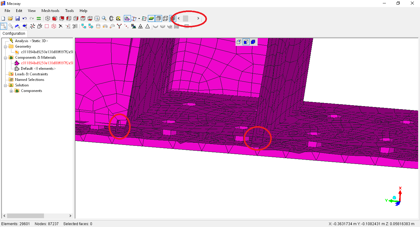

  • Some parts intersect each other which is probably why it's not meshing. To see where, make a surface mesh (which works), and use the cutting plane slider to look inside. No doubt, converting it to a single solid body in CAD as Andreas suggested will correct this.

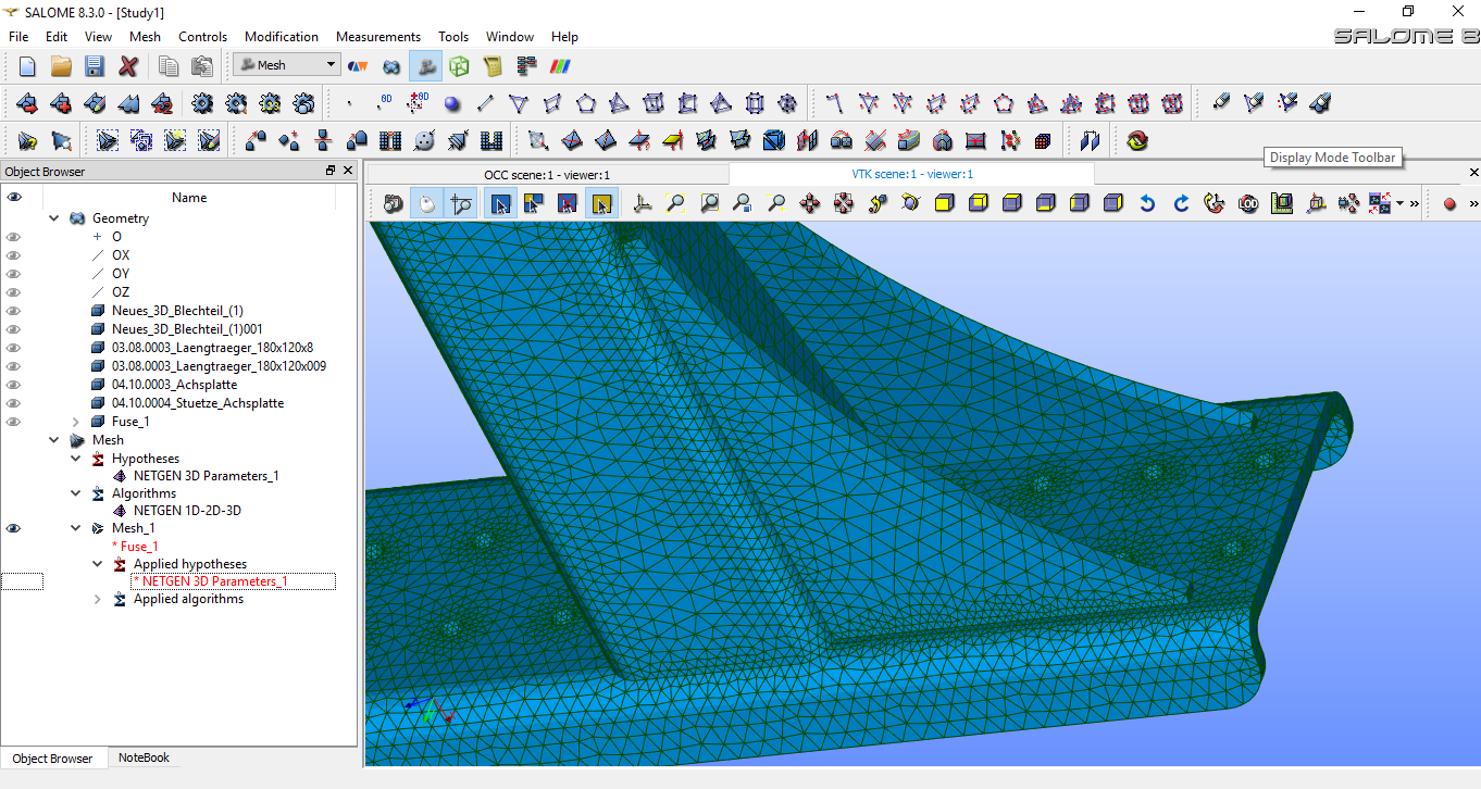

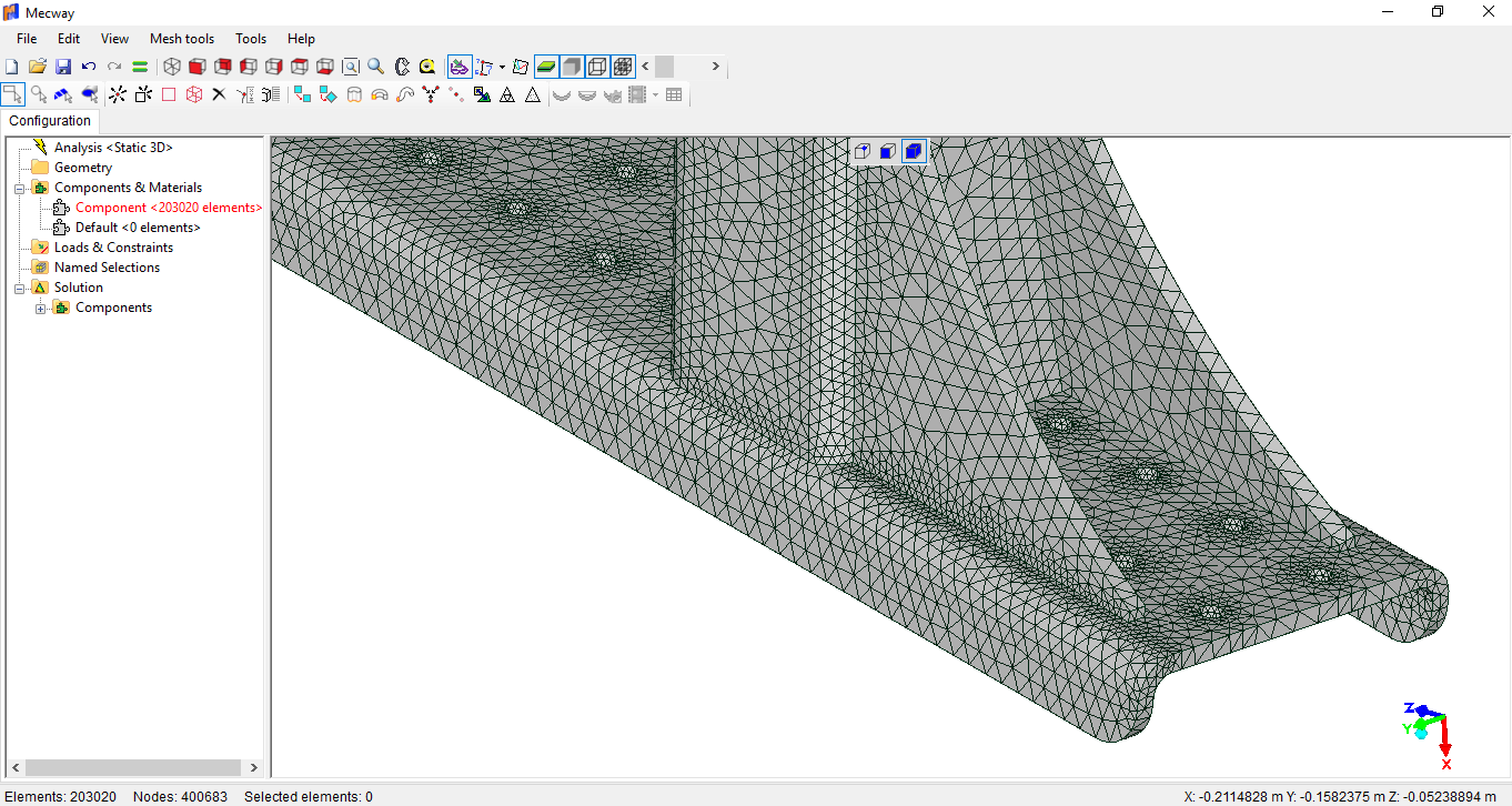

    I was able to merge the bodies in Salome 8.3 (Fuse is the boolean option) and then create a conformal mesh, but again, in my opinion this mesh is not accurate, you need more elements in thikness and with tets the model will be excesively big.

  • By the way, you could try to export the fused geometry as step in Salome, and then try to mesh it in Mecway to get an associated cad/mesh model.
