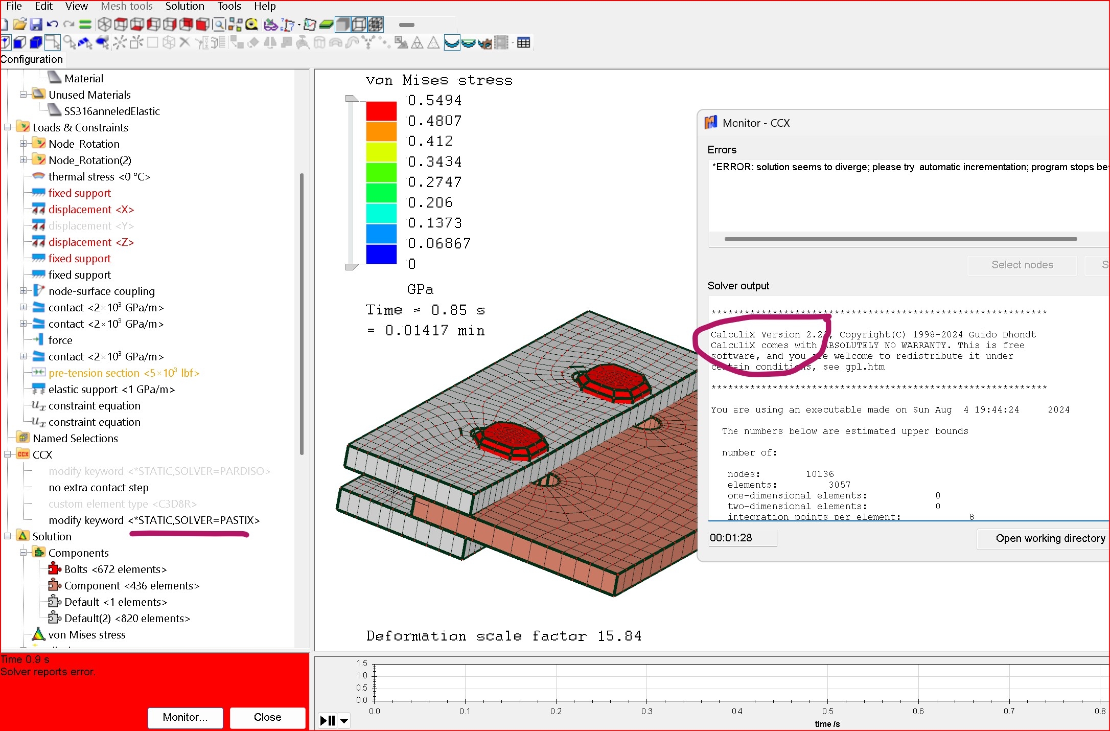

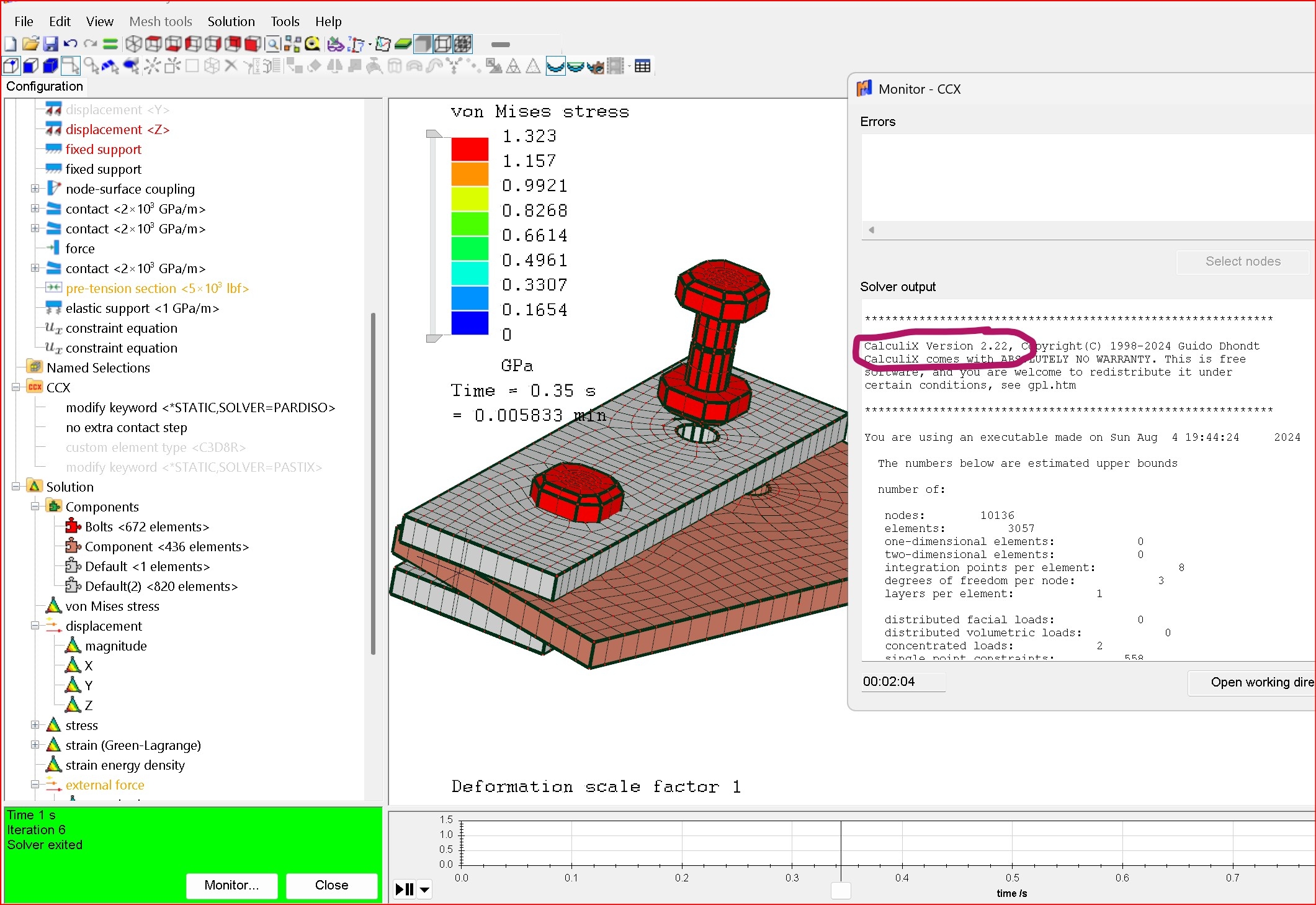

I have seen some differences in the solution generated from the same model in Mecway when I use 2.23 and 2.22 ( specifically a non linear contact involving bolts and pretension). In some cases 2.22 converges easily and 2.23 requires a different analysis set up to converge whatso ever. Has this been reported else where and are there any potential reasons for this? which solution is likely to be more reliable? I have attached the file 2.22 solves with out the need for automatic time stepping but 2.23 does not - the maximum stress is also different. I can well believe my approach to this particular problem may be questionable but I'm surprised at the difference in the solutions.

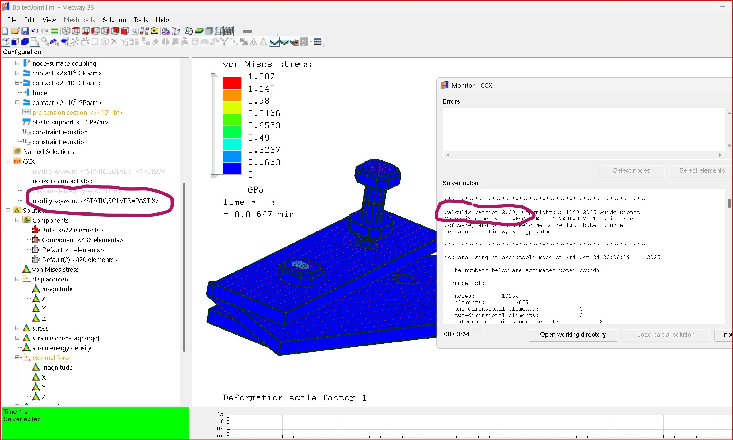

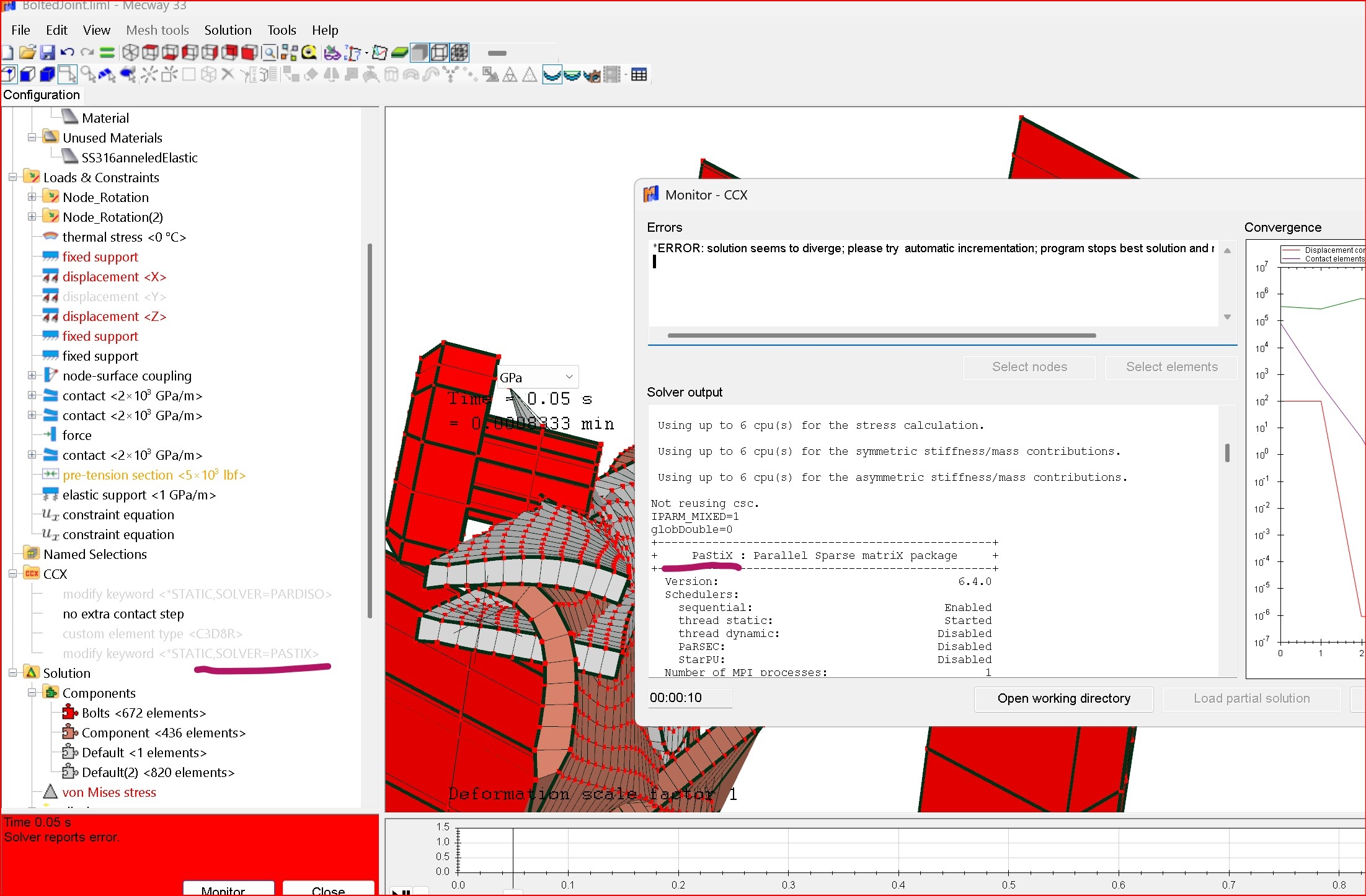

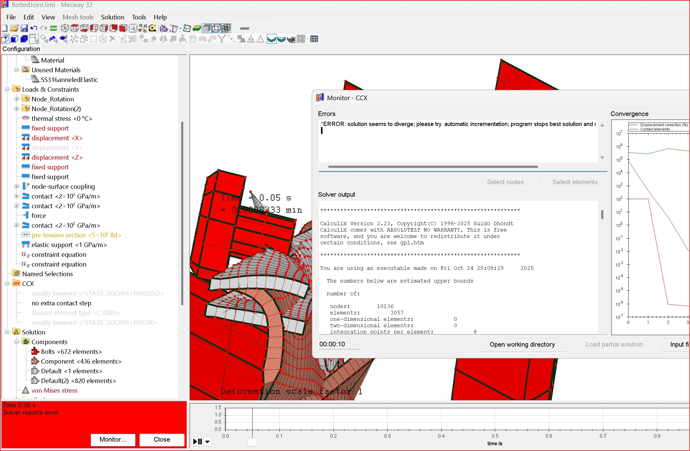

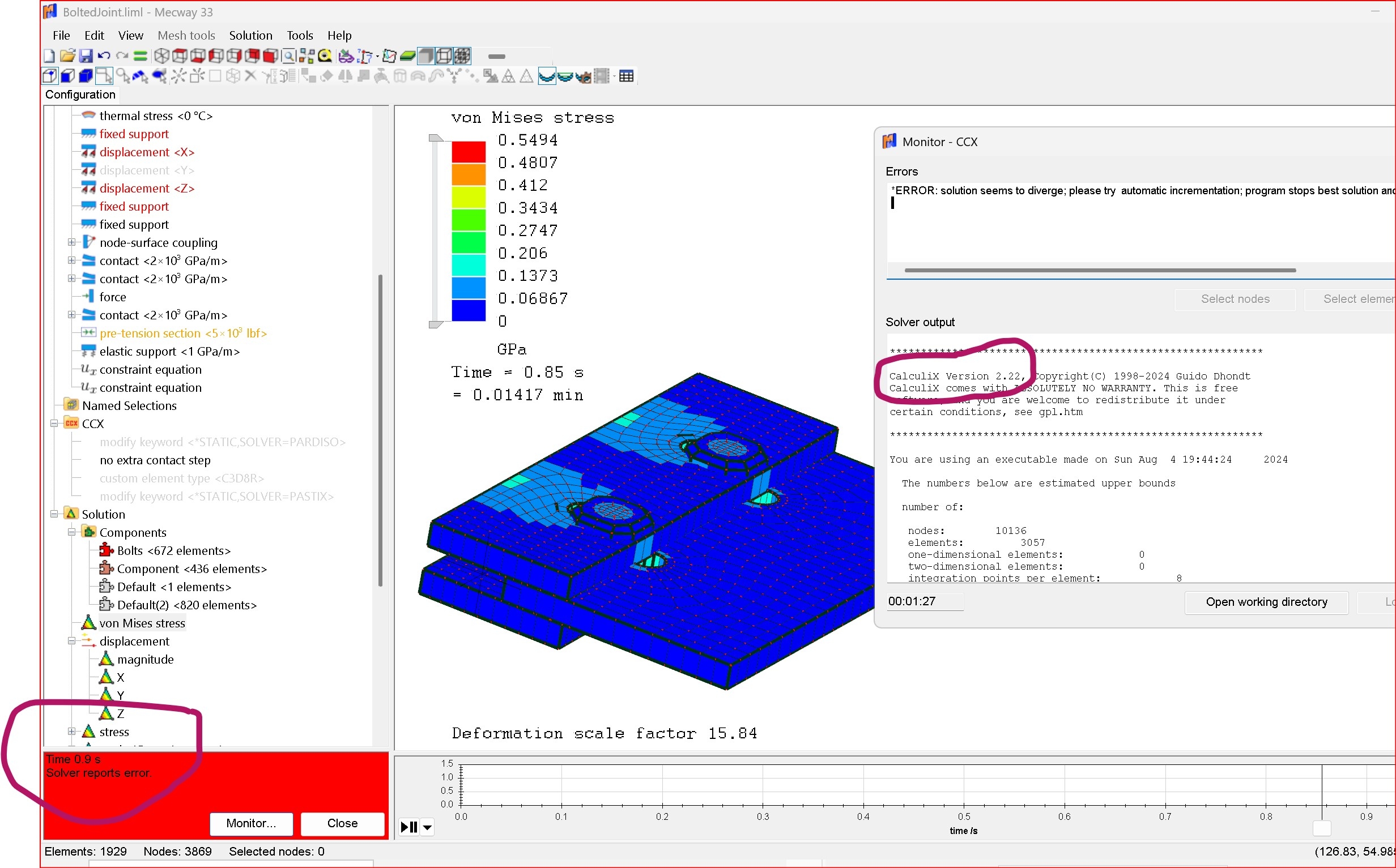

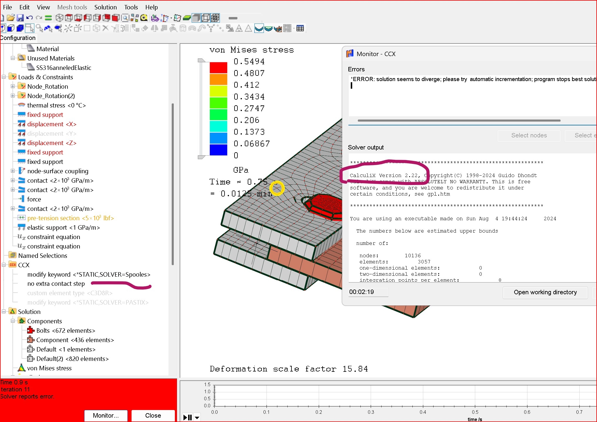

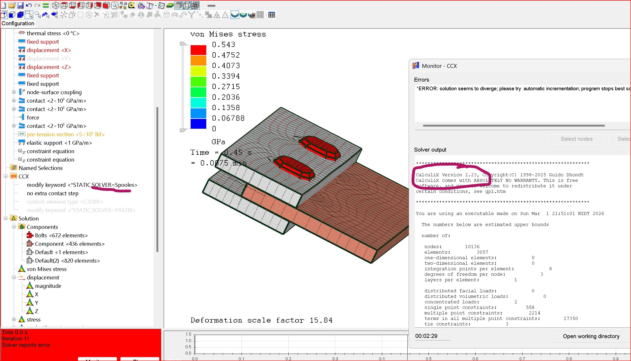

  • I have attached the file and some pictures. In the end i got myself a little confused - in one case i appear to have got different solutions with the same solver but one using the keywords and one using the default which suggested it was using the same solver! Quite possibly I have got hold of the wrong end of the stick (again!)

  • Yea auto time step certainly helps convergence. The bit that surprised me was the very differing solution with the same solver but different version- see pics in last posting

    From your pictures, it looks like Spooles doesn't converge in either version so there's no inconsistency there, and Pastix is the one that gives different results. Is that right?
    Pastix can give random results with mixed precision, which is the default, so make sure you turn that off using the environment variable. Even with double precision, I'm not sure it tests for convergence properly, so maybe it's giving results when it should have failed.
    I only test Mecway against the version of CCX that's included with it, as well as Pardiso built from the source included. Other builds might not work as well.
