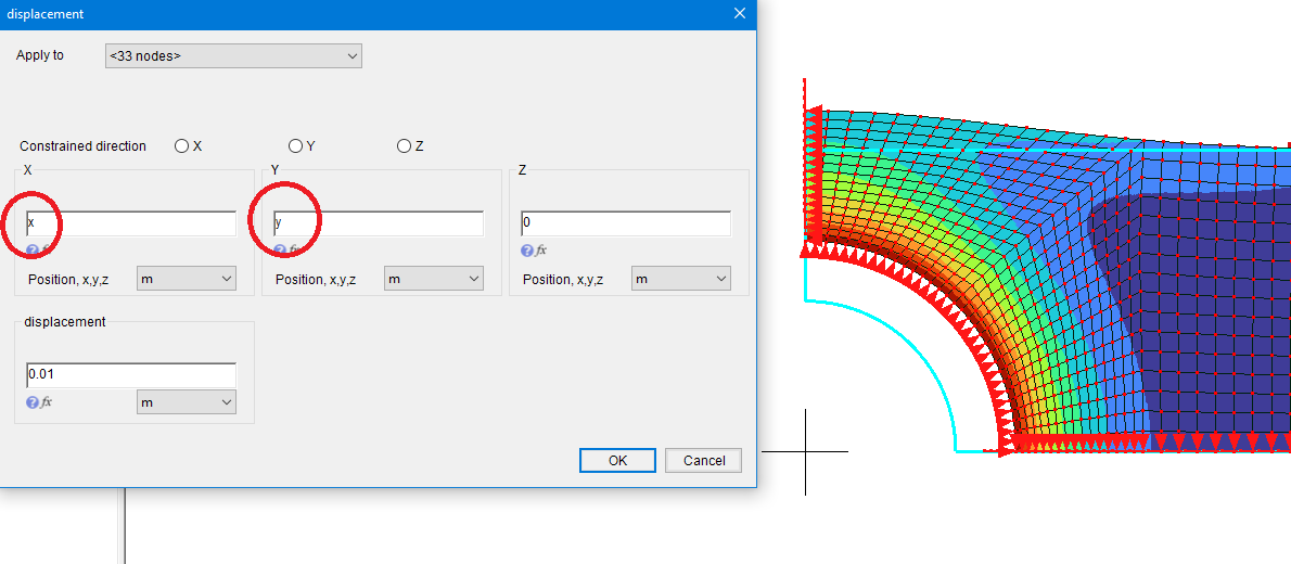

  • I see. It looks like the AI is trying to editing the mesh instead of applying a displacement constraint.
    You can do a radial prescribed displacement without a script, using formulas in Displacement like this:
    If you need to adjust the distance in a script, you can create the displacement constraint in advance then set the values in the script using
    mw.set_load_property(load, property, value)
    See Help -> API Reference for details.
    The API is generally not very capable at setting loads and constraints. It can't set formula values, for instance, or create them from scratch or assign nodes to them.
