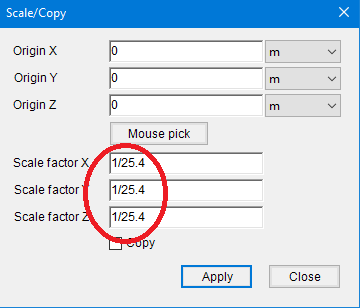

- Formulas (without variables) allowed in inputs for most meshing tools, interpolate, and refinements for mesher.
