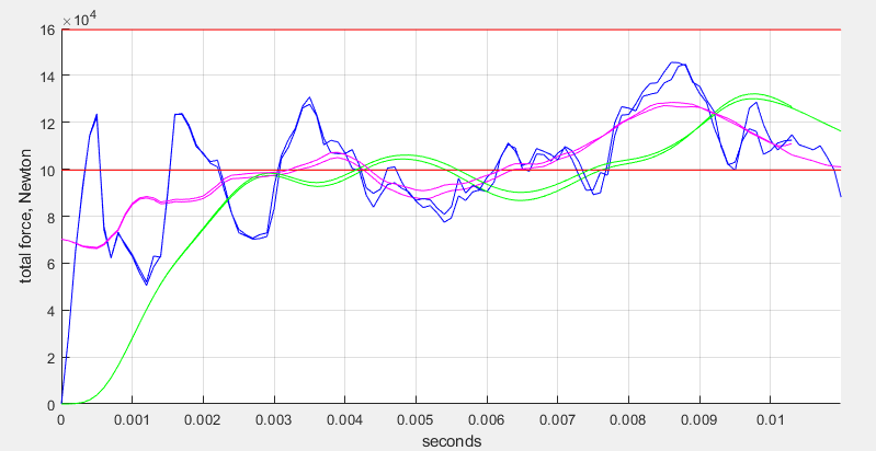

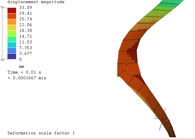

    The problem here was 26 meshed CAD parts, 159935 elements, 156871 nodes, timestep 1,5e-7 s (using advanced mass scaling to increase from 5e-8 s) and all of the surfaces that are not secondary/slaves in a tied contact is a part of a self-contact. Shown below is 0,0103 seconds simulated time, so that is 68667 computed timesteps. It is clear that the results start out the same but diverge from each other but the difference doesn't continue to grow within this amount of simulated time. On the graph of energy absoption, which is the sum of force times distance, they are indistinguishable.
    The blue line is the force on the impactor, the green is that force passed through a low-pass filter and the magenta line is a rolling average.
    Regardless of the disappointing speed increase, the conclusion on this test is that the single precision can be used (for me, in this particular model) to speed up the computation time without a significant loss of accuracy. Thus, I can use this to iterate faster and then run the final simulation at double precision.

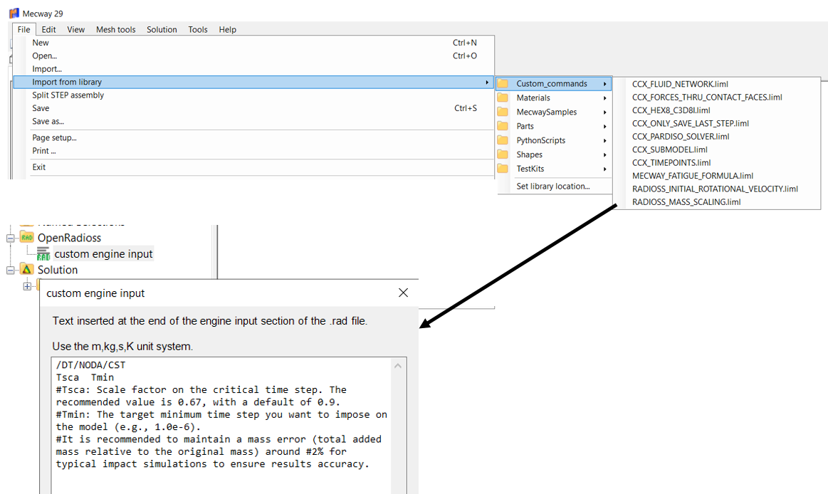

  • Seeing all the great OpenRadioss finds, I thought it would be a good time to share a nice trick. If you keep a folder structure of useful things - materials, pre-made parts, and useful custom commands, these can be saved as "command only" liml files and kept in a library for easy access, like this:

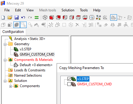

  • @JohnM nice trick! Did you find a way to save also custom meshing parameters for Gmsh? There are two sets of parameters, one for meshing conformal parts and the other to meshing with quads that could be great to save. Maybe could be saved at least as a dummy custom CCX command deck, and delete before launching the solver.
  • What you can do is import this "model", right-click and "Copy Meshing Parameters To"
    to use these parameters on your real step files.
