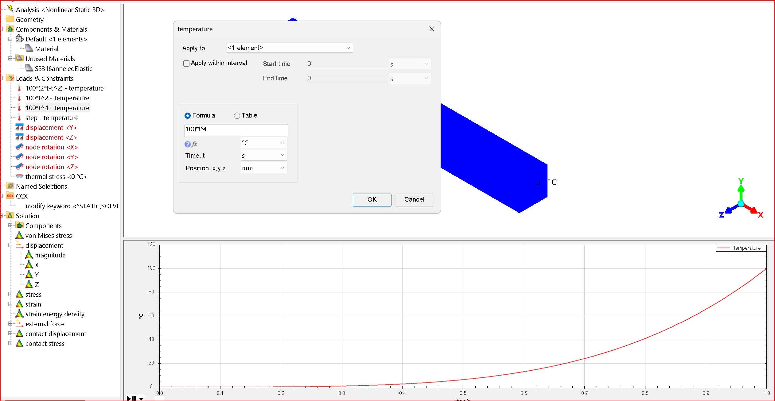

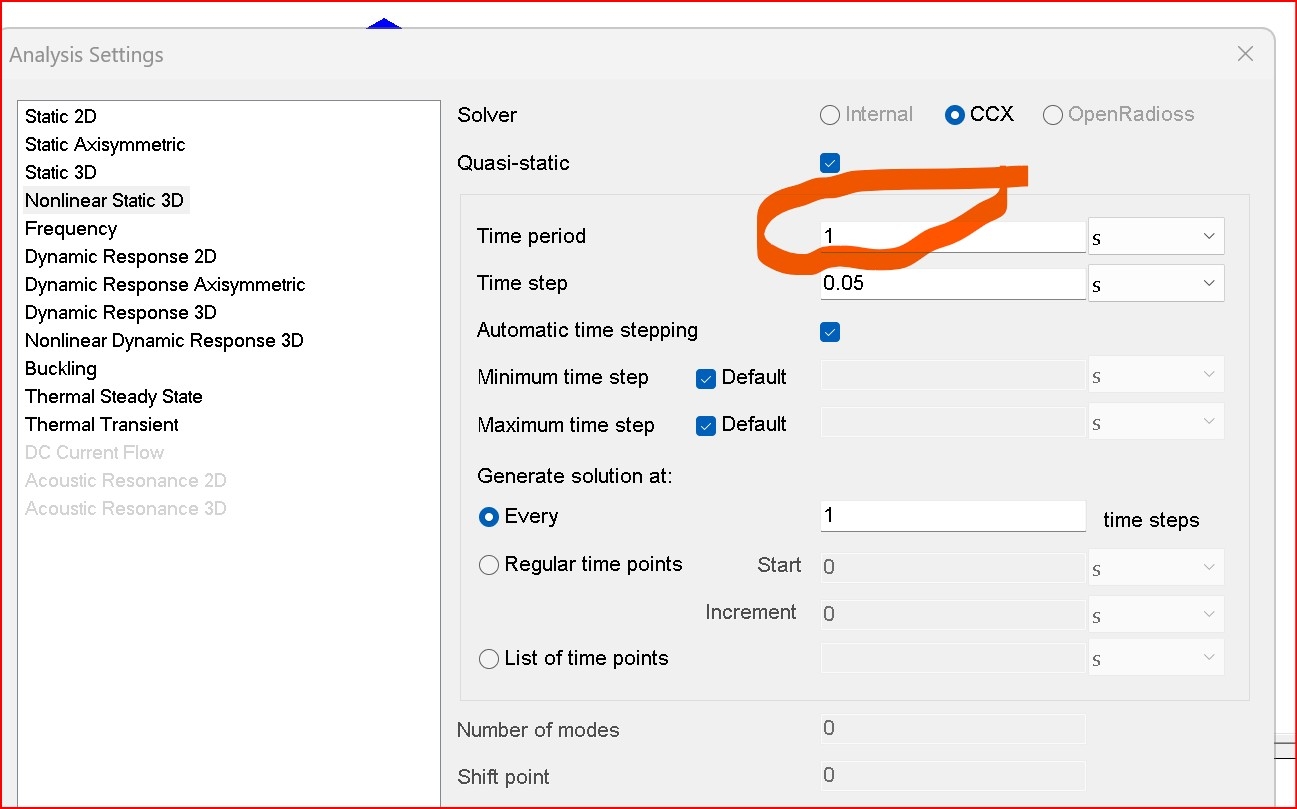

  • If u are using NL then by setting the time period to 1s
    there are some easy options to manipulate the time steps. Here I have shown a n an option Also by using tabular input a series of steps can be introduced

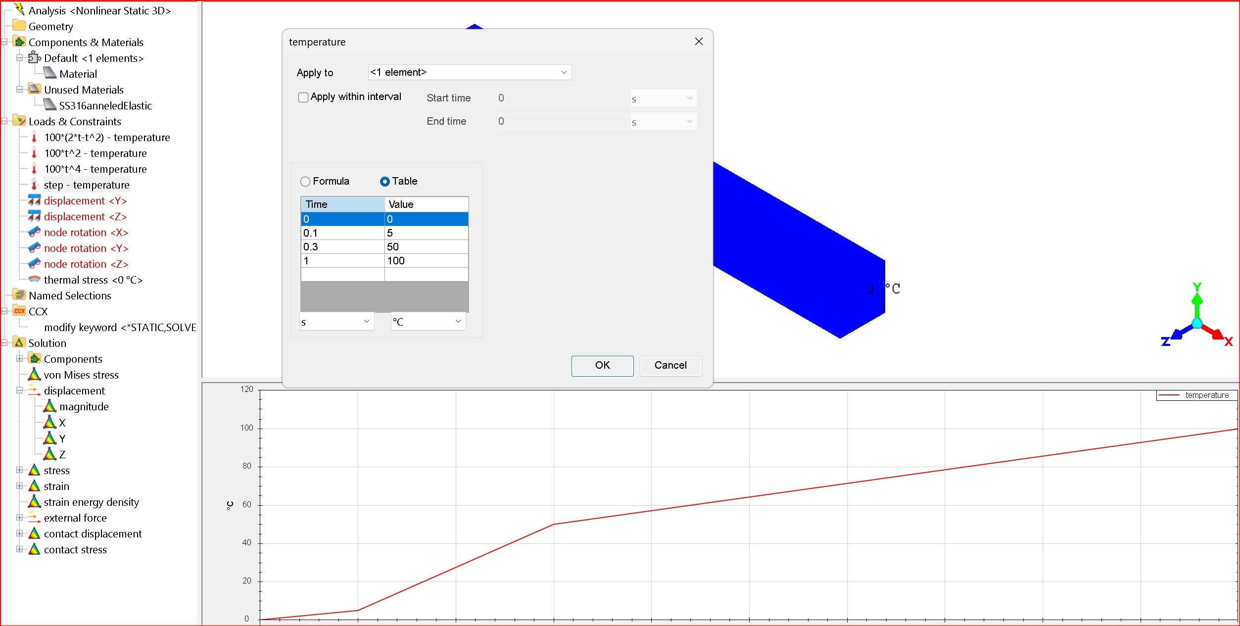

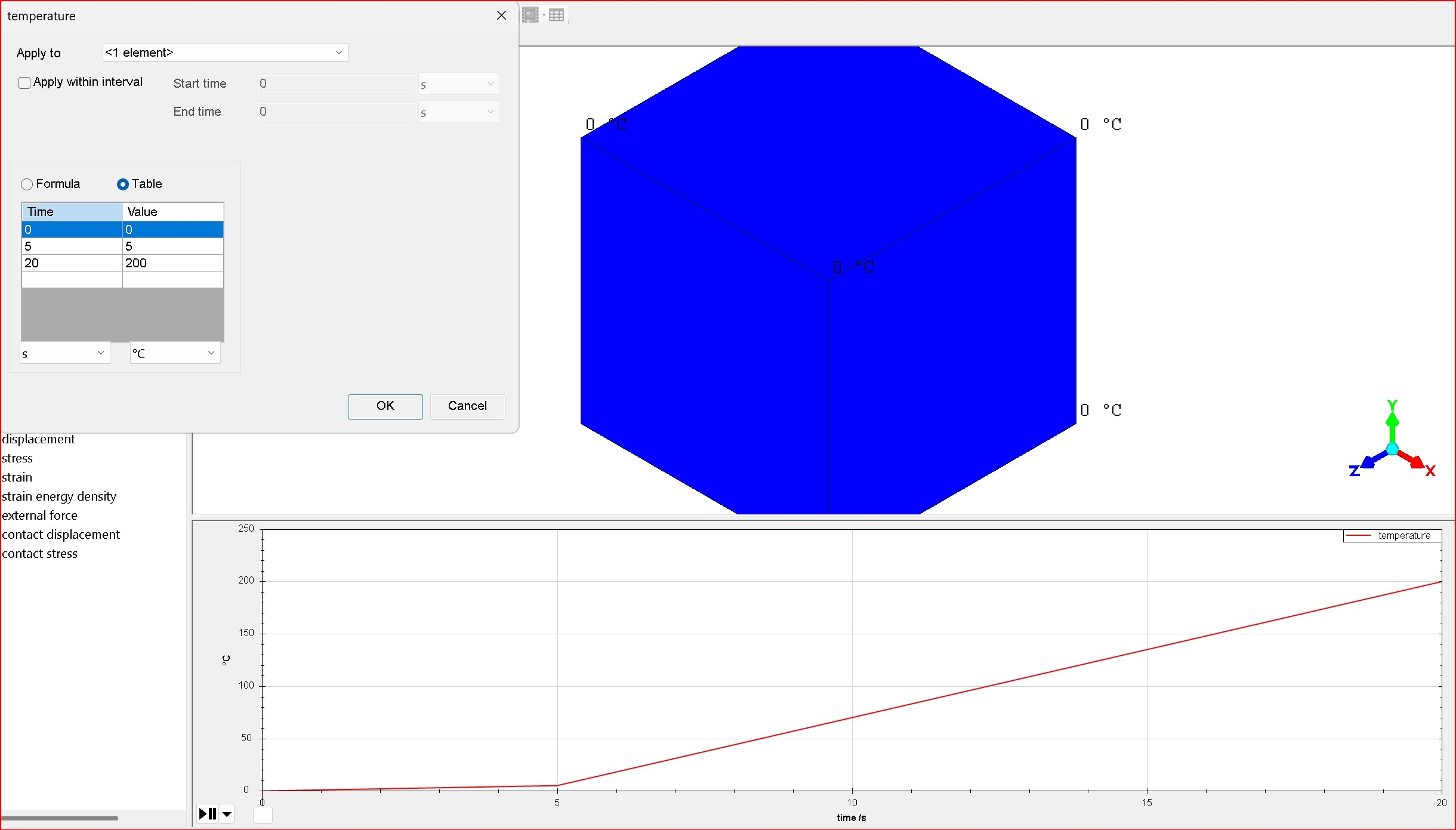

  • I may have not properly understood ur question correctly but i think there are several ways to achieve what u are after. The simple way is to use tabular inputs. If u run the analysis over say 20 seconds and u expect the tricky nonlinear part to be only in the first 5 then something like in this screen shot would do Also if u have automatic time stepping selected the time steps will naturally be smaller where the
    going gets tough
