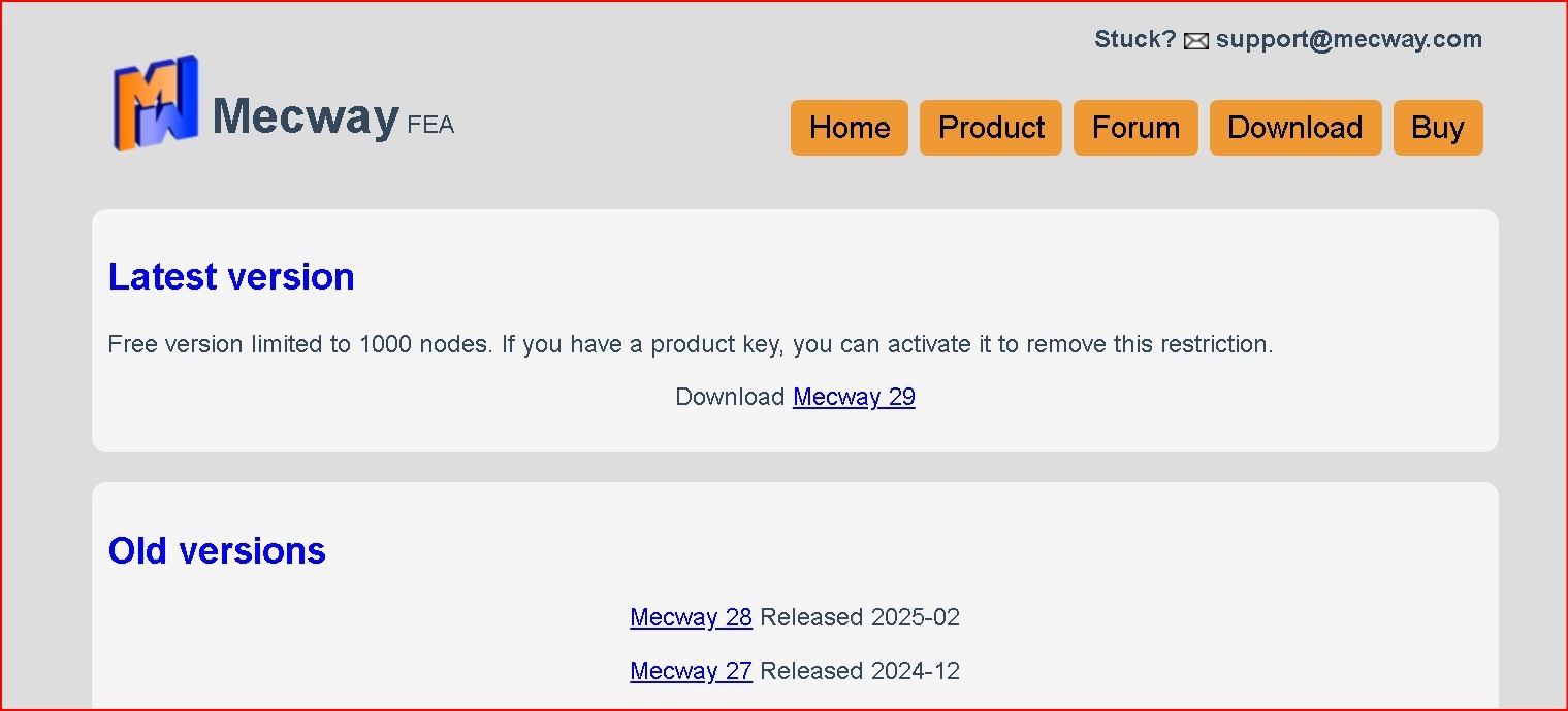

Mecway 29 is now available at the link below and includes the Spanish language manual translated by Germán Bresciano.
https://mecway.com/downloadChangesGeneralComments (text notes) which also get written to external solver input files.

The download link does not yet show version 29
Edit: Now it does.
