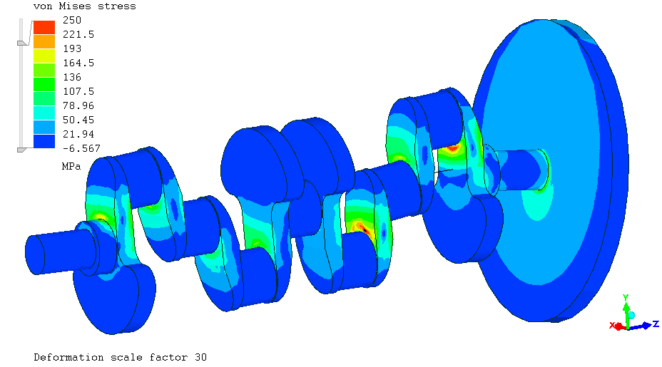

  • I have applied different combinations of the recommendations and hints contained on the attached files, but I found a big issue solving with NLGEOM Quasiestatic.
    Shaft bends with centerline offset properly but the system lacks from rotational inertia to sort out the critical turn around and keeps oscillating no matter what.
    The vertical position is an equilibrium position, and I don’t think I can inspect the whole 360 rotation without enforcing the rotation by hand with the rigid bodies.
    The load driven has many points in common with the Spur gears and needs a brake to remove the rigid body rotation.
    I have found something curious. Centrifugal force helps on the convergence for some reason. Similar to that dummy load on contacts.
    I’m using nonlinear springs to remove the contribution of the piston once it is returning to the starting position before a new expansion.
    Good looking but not satisfied yet.

    I have moved to Dynamic.
    I think I have dirty spark plugs but I‘m progressing. :)
