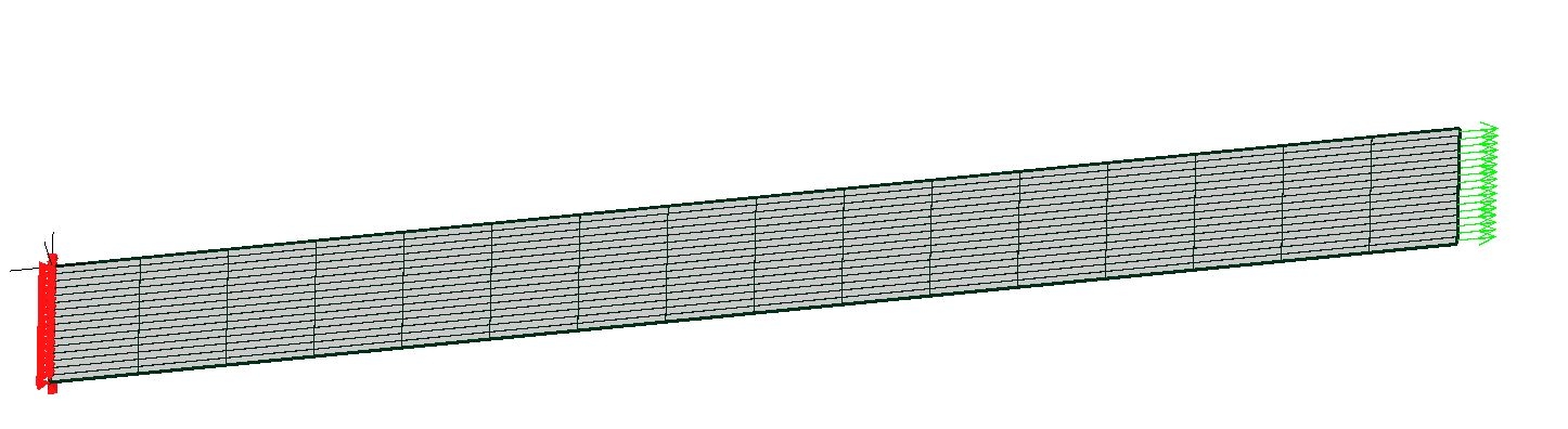

I'm relatively new to FEA but was hoping I could get some insight on simulating wrinkling in thin films under tension.
I have a material that is 25 microns thick, 1.15 cm wide and 25 cm long. It is isotropic (or at least I'm assuming it is
) with a modulus of 2.5 GPa, Poisson's ratio of 0.333.
Under tension of about 8 to 10 N we are seeing wrinkles form.
I would like to model this phenomenon but I am unsure of the type of model to use and the boundary conditions.
I have tried "Static 3D" and "Shell / Membrane" with the appropriate thickness. Then had a fixed support on the base and a force on the other end but the material only deformed like a tensile sample and was very uniform. I'm guessing I'm missing something.
Any help would be greatly appreciated!
Thanks,
Frank
I couldn't find any wrinkling that way but I wonder if the elements are too big to capture it or maybe the phenomenon requires plastic yielding or non-linear elasticity?
I would use hex20 with only 1 or 2 elements in the thickness direction instead of 16 hex8's.
Without forgetting the need to perform a convergence study, one general hint to foresee the required mesh density is to ask oneself ; how do I expected the Stress field will be?. Then put more elements where you expect more variation.
Looking at your plate, it seems a pure traction problem. That is to say, uniform stress across the plate so it has no sense to refine. Example
If you have some bending along the plate involved, Stress will vary along the plate. So, put elements along the plate and across the thickness.
Returning to pure traction, If your supporting base is fixed, then some stresses may emerge close to the support due to Poisson Ratio. That suggest mesh should be more dense close to the support and then you can could make It coarser as it goes away.

Maybe it's necessary to clamp both ends, like this
According to that paper (https://www.sciencedirect.com/science/article/pii/S0020768311003040) it should show up with linear buckling analysis, so that's probably a good thing to do first because it's much more reliable at getting *something*.
How do I set up "linear buckling analysis"?
Thanks,
Frank
- Set analysis type to Bucking 3D
- Choose a Number of modes. I normally use 3 or 4 to get a sense of what else is around even though only the first mode would actually occur.
- Set Shift point to something less than the lowest buckling factor. Maybe just use 1 to start with then reduce it later to make sure there are no lower modes it missed.
- Solve!
I just tried it and it looks like it's wrinkling near the support but needs finer mesh to capture it better.You can adjust the mesh according to the mode shape and a scaling factor using Mesh tools -> Transfer displacements from solution.
