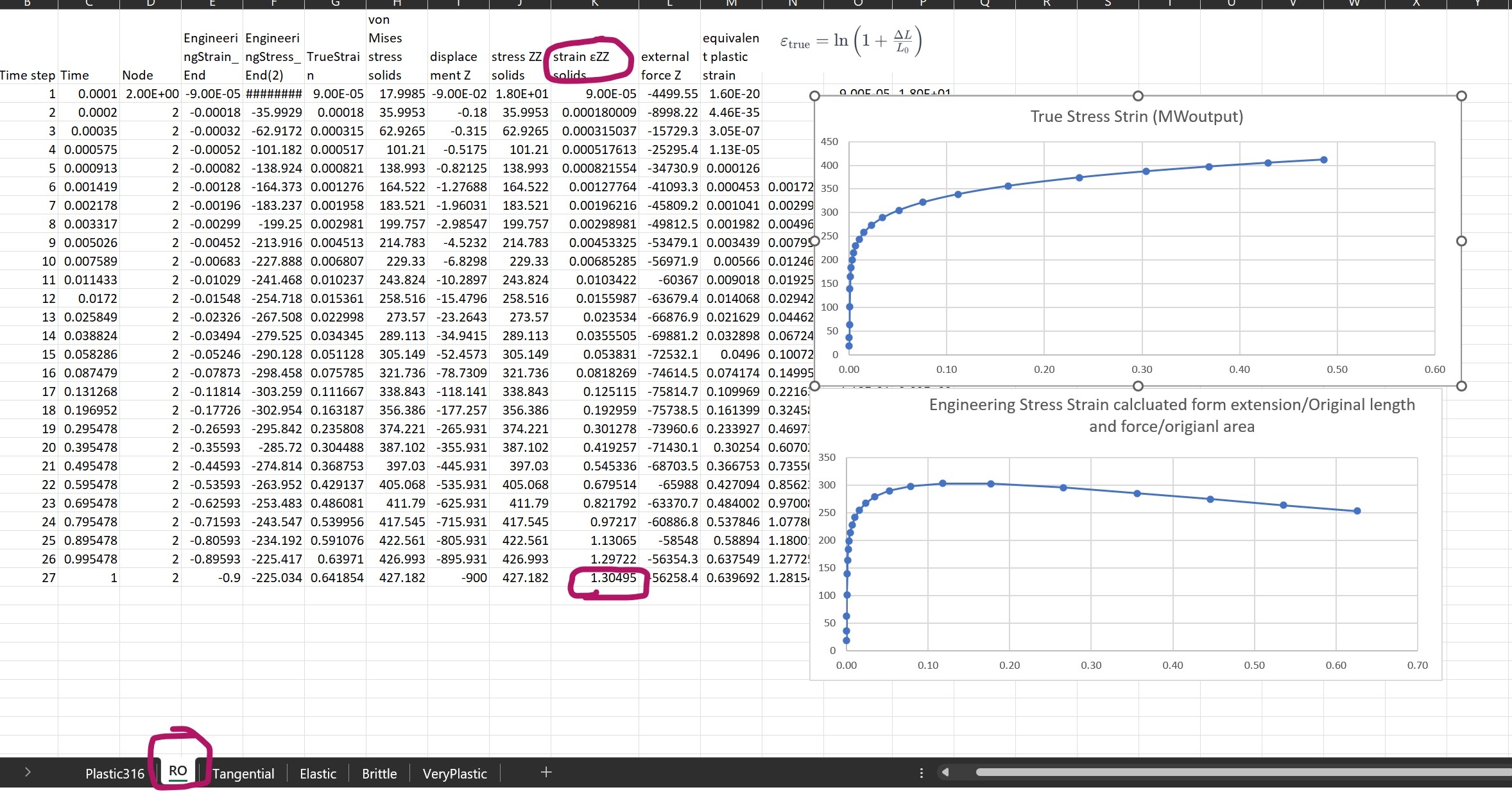

I was keen to understand some of the different methods of looking at plastic deformation. Having made the mistake of using complex structures to examine this before, I started with a (perhaps overly simple?) 1m cube. I restrained one end so that it was free to shrink in the off axis directions and pulled the opposite face 900mm. I then made up some variables to try and evaluate Engineering Stress and Strain and a form of True Stain using ln(1+deltaL/Lorginal).

1/ what "strain" is Mecway generating in the ZZ direction -i see something like 1.30495 (same for principle strain in 1 axis) when my block has been stretched 900mm -I don't see where this strain comes form. Coincidently, it is very close to the sum of my generated true strain variable and the plastic strain generated by MC.
2/just to be complete I ran one analysis with a complete elastic material and as initially surprised to see a non linear relationship between stress and strain in my calculated engineering stress/strain - is this something to do with the change of section area or just an indication I have generated my Engineering Stress/Strain numbers incorectly.

    Hi Fatmac,
    I have also noticed that you should also take a look at your graphs. They don't seem consistent with your results. They reflect the importance of distinguishing correctly not only the stresses but the Strain you are talking about.
    Enginieering Stress & Enginieering Strain Curve.
    Enginieering Stress @ ( 0.9 Enginieering Strain) = 225 MPa
    True Stress & True Strain Curve.
    True Stress @ ( 0.64 True Strain) = 427 MPa
  • Its pretty clear I need to go back to school where it comes to the definitions of all the different types of stresses and strains!.
