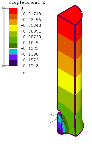

The following image shows a static analysis where the top surface of the cylinder is fixed and a negative pressure is applied to the bottom surface (the stud). This causes elongation in the negative direction as shown in the legend.
Generally, hot colors are used to indicate a large effect whereas cool colors indicate a small effect. In this case the colors are reversed so that red indicates near-zero displacement and dark purple indicates maximum displacement. I'm looking for some way to easily invert the colors. Taking the absolute value of the displacements gives the desired color distributions but then the legend is wrong since all displacement values are indicated as positive (next image). (Re-editing \Tools\Options\Contour plot\Custom\Custom colors isn't really an option since this takes too much time and then interferes with "normal" legends.)

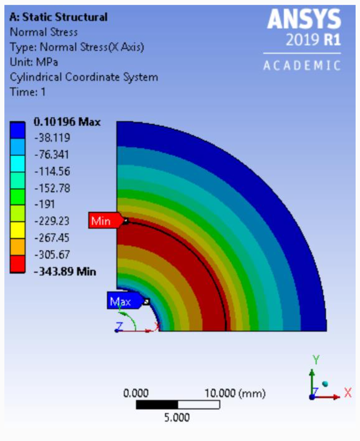

  • Ansys apparently allows this (https://forum.ansys.com/forums/topic/interference-fit-pressure/) unless the legend colors were manually inverted. (The model is for an interference fit.)

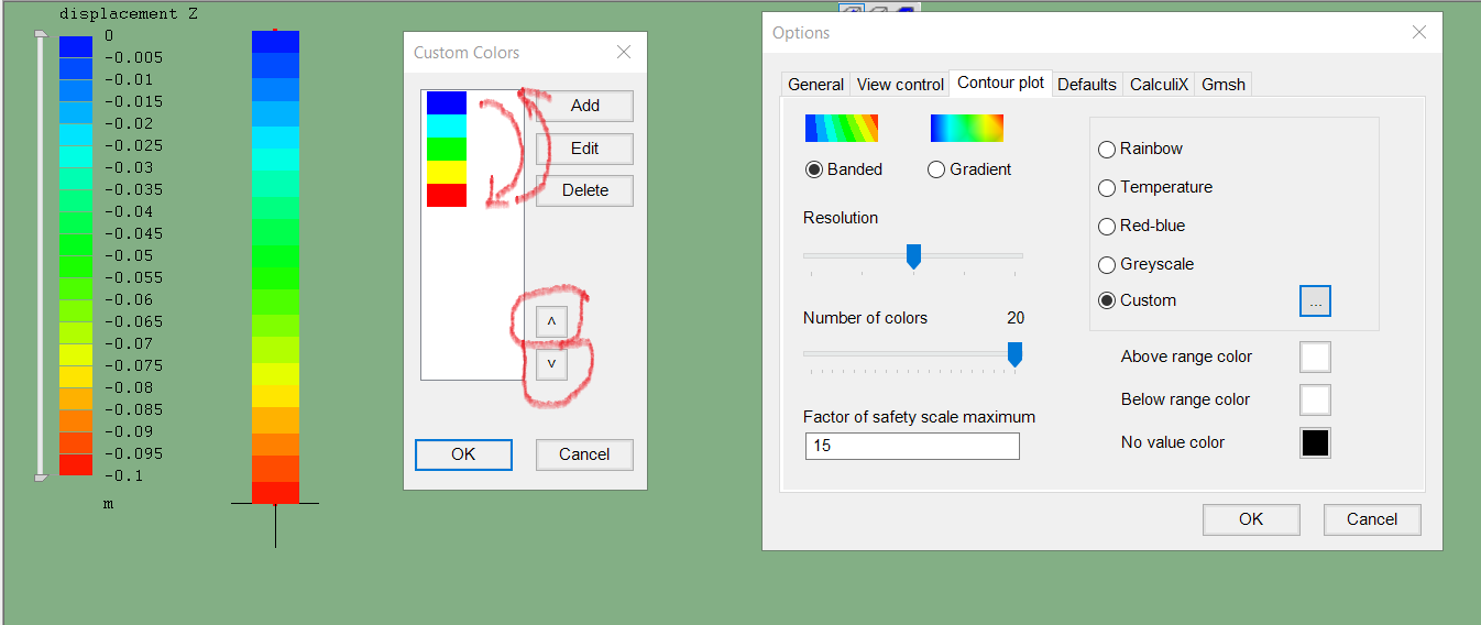

    There is a way to do this. My first response was probably too precipitated as sorted the problem immediately but for a more permanent solution you could create a custom color legend and save it inside the default model folder to be loaded automatically each time you create a new file. The “Custom” legends would contain the “Reversed colors” and will be saved permanently.
    Custom file needs to be created in case you haven't. Tell Mecway the folder in Tools/Options/Defaults.
    To invert the colors, edit the “Options/Contour Plot/Custom” colors. Delete any colors in case you have changed previously something and press ok.
    Reopen “Custom” and you will have the standard range again. Use the up and down arrows to sort them upside down.
    Press ok and save the file as Default.
    Next time you create a file , Custom contour plot will contain the reversed color range.

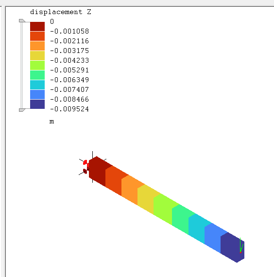

    This works --
    However, it has a major shortcoming (as far as I can determine). Once this inverted color scheme is created, it is applied to all models. However, the original (non-inverted) color scheme may be desired for some models. In this case the inverted color scheme must itself be inverted to get back to the original color scheme; then the inverted color scheme is lost.

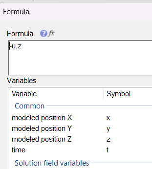

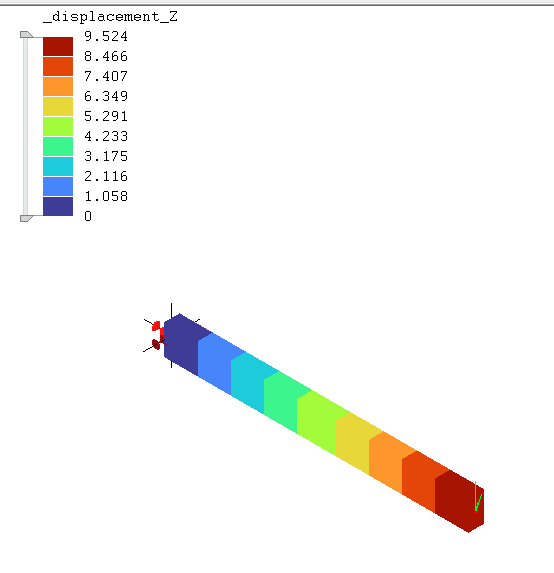

  • Just create a formula with the opposite of the variable you want to display and colors will be inverted (as the sign of the variable).
  • Thanks a lot, German - I like this workaround of yours! (simple enough)
    Gert
