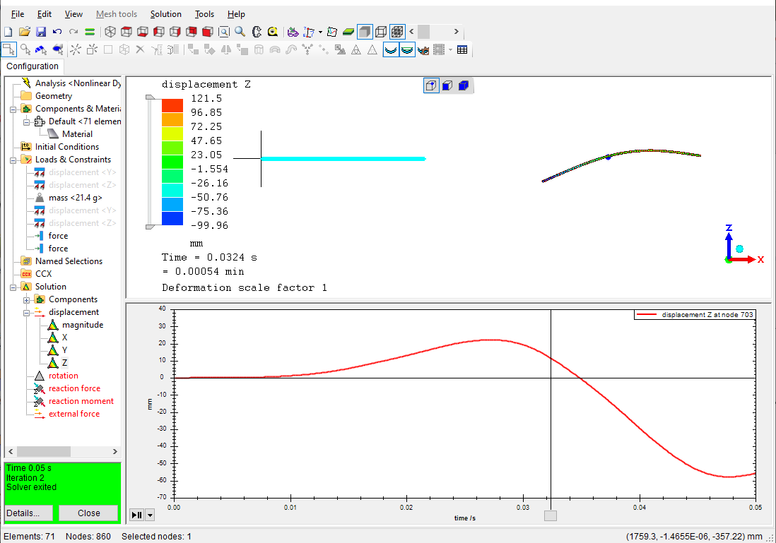

Slightly different problem I guess. I'm trying to verify the lateral deflection of an archery arrow. If you look up "Archer's Paradox" you will see that all arrows have this to some degree. It's quite significant.
Attached is the Dynamic Response 3D file using 2d beam elements.
Initially I only applied a 312N time varying load in the direction of flight (X-Axis). The arrow accelerated as you would expect. No lateral deformation as you would expect (in Y or Z directions).
I then applied 3N in the Z direction hoping to start the arrow buckling. It does show a few mm deflection laterally which is about what one would expect from this size lateral load but I do not see any buckling effect from the 312N load in the X direction.
Can anyone suggest a better model? Should I be using diffent elements?

  • The linear Dynamic Response 3D analysis type can't model buckling. Use Nonlinear Dynamic Response 3D with the CCX solver instead. You'll have to change the elements to line3 for that too.
    I didn't get much different a result until I doubled the force to 600 N and that dramatically increased the lateral deflection, so I hope this is the effect you're looking for.
    I also increased the Time step size from 0.00001 s to 0.0001 s for speed.

  • Just looked at that paper, fascinating stuff. I think it's useful to run the modal analysis first, as this will give you some idea about your required time stepping. For example: 1/(frequency * 10) might be a good start.
