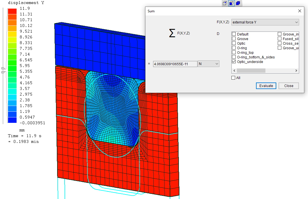

I found this from Victor on another post:
"1. Select the fixed elements and right click one then Add elements to new named selection.
2. Solve.
3. Solution -> Sum external forces on the element selection:
a) Choose an external force component
b) Select only the element selection for the domain D
c) Evaluate
That shows the sum of reaction forces at the current time step."

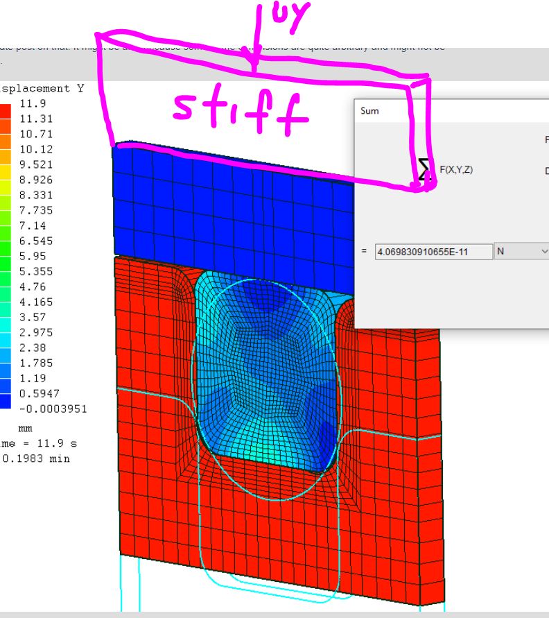

I still think that the numbers this gives are too low (see attached). I am currently revisiting the definitions of C10 and D1, and I think I may have had it wrong before, but I am not close to being sure I am right this time. I wish I were clever.
About your problem, guess that you miss to attach the file.
I was just going to attach the image. As originally stated, the force seems very low, even when multiplied by 360 to sum for the whole circular O-ring. On the next time step the mesh destroys itself - I presume because the deformation exceeds that allowed by the Poisson's ratio. I think I need to understand the D1 and C10 parameters better (and C1 for Mooney-Rivlin), to make sure the material properties are approaching reality but I think I'll make a separate post on that. It might be also because some of the dimensions are quite arbitrary and might not be realistic.

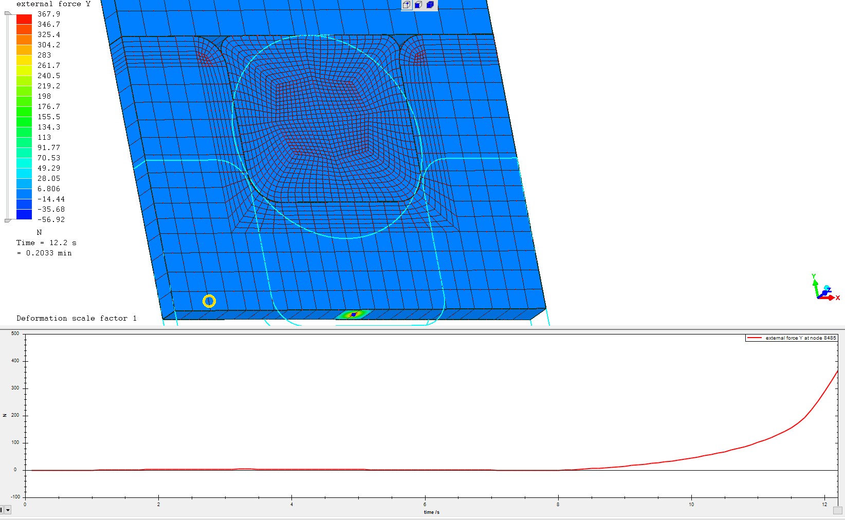

I have just tried this and it looks much better. The scaled up force is now 132451 N for the whole O-ring. This configuration has also run to full displacement whereas the previous one exploded. No idea why.
Does the shading for the external force indicate that reaction force is shared by other nodes meaning that this is an underestimate of force through deflection of the component? Maybe this is why you guys use the stiff material/rigid body trick. Neat stuff.

As for failing on the next time step. That can be more likely if Automatic time stepping is turned off which it looks like it might be.
Yes, where the contact is. Thanks for the explanation.
Yes, saw a few suggestions in earlier posts to turn off Automatic time stepping. When I did, the deformation near first contact was much more reasonable.
