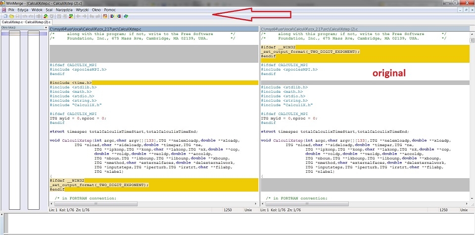

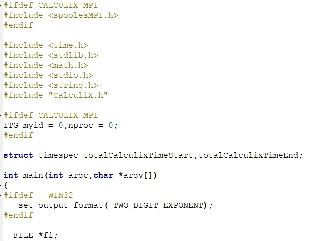

3. Simple file modification ccx_2.17 and CalculiXstep.c like:
and ccx_2.17.c (already after modification):
4. Modify the Makefile to this form:
