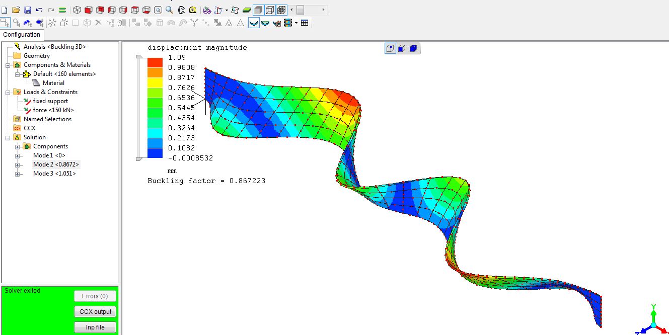

    When the buckling factor (acr) is greater or equal to 1 there is no problem with calculix 2.16.
    When the acr is<1 the calculix 2.16 gives wrong results, while other versions e.g. 2.15 and lower have no problem.

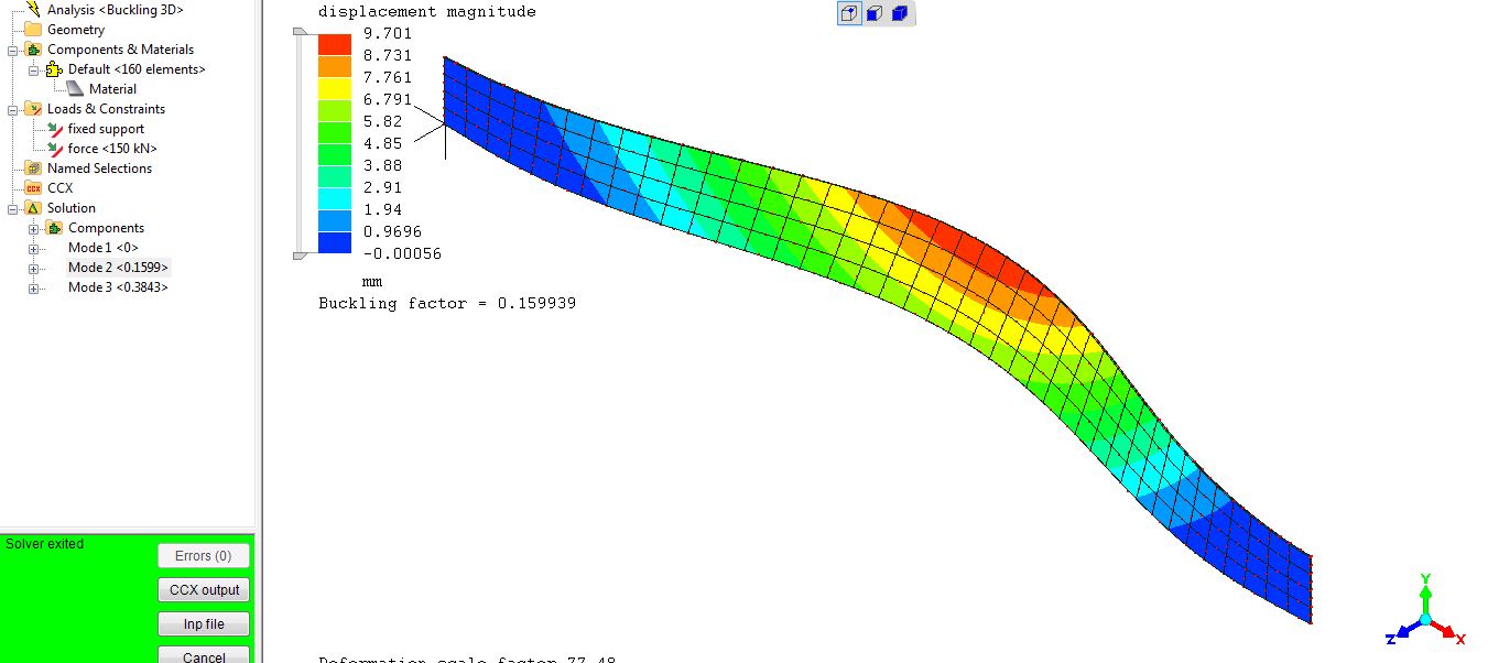

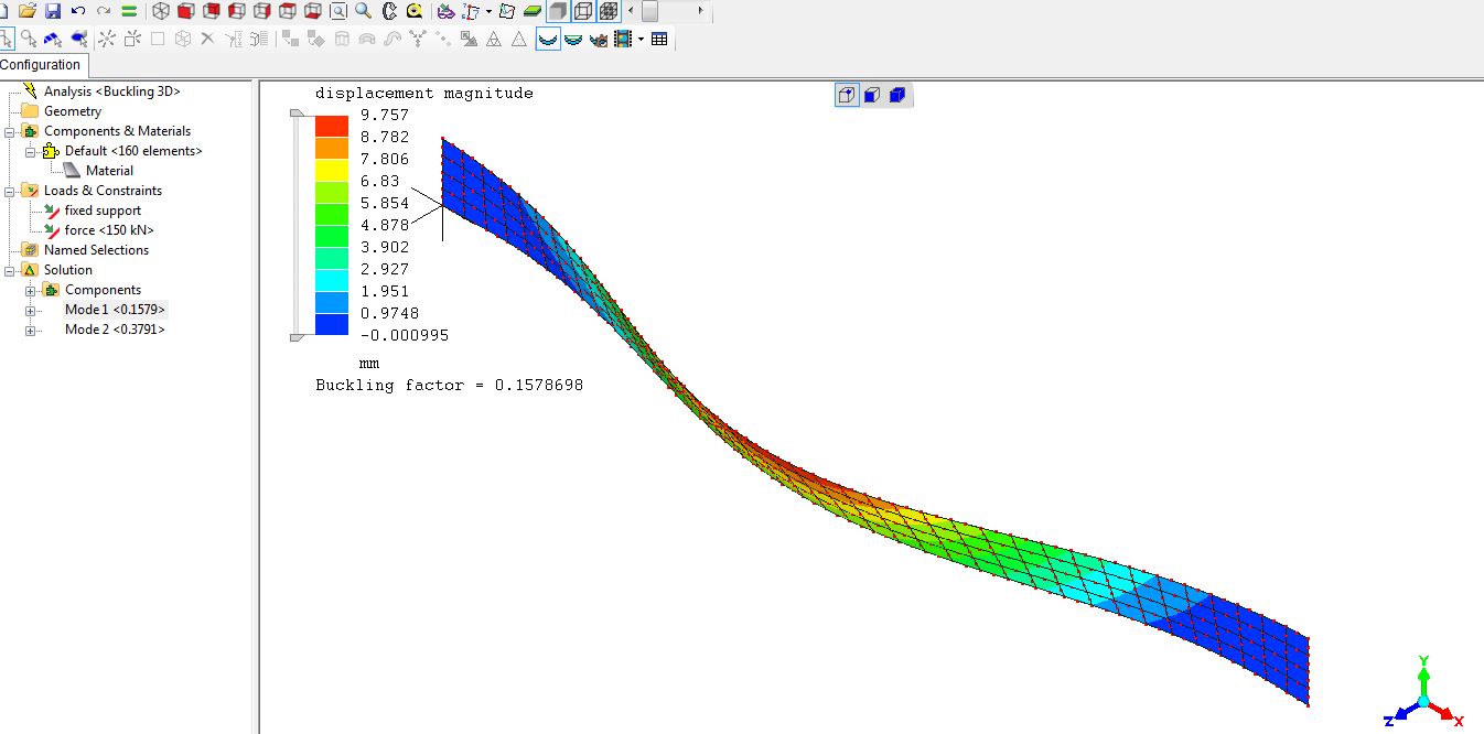

    I use mecway9,32bit, and ccx,32bit versions. Please see attached images and liml file.
    In the particular example when I use calculix 2.15 or mecway solver the acr~0.16, but calculix2.16 shows acr~0.86 and from the buckling shape it is obvious that omitts lower buckling modes.
  • I see the same problem with the CCX 2.16 included with Mecway but not with CCX 2.16 from dhondt.de, nor CCX 2.15. So this could be a big bug. I'll reply on this thread when I have more progress. Thanks for bringing it up!
