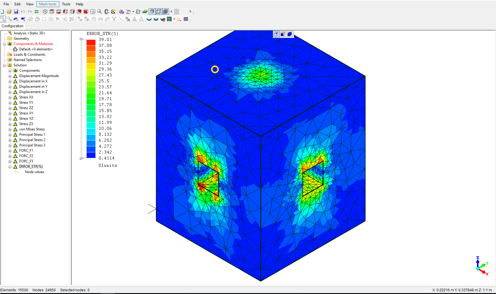

Hi everyone,
I was wondering if anyone had any further information, or previously encountered on the ERROR_STR(%) solution output when using the Calculix solver.
See attached screengrab for reference.
Cheers,
Tim
  • This appears to be the "gradient error estimator" (see CCX manual). If it's this, then it's an estimate of the error in the maximum principal stress and is obtained using a heuristic based on the difference between values at the integration points in each element.
    I'm not sure why it's appearing without having to specify ERR in the *EL FILE card.
  • It would be good if this value ERROR_STR_% could be used in formulas, so absolute error could be calculated multiplying % error by principal stress.
  • I'm unlikely to do that soon unless there's a lot of demand because it's a bit tricky.
