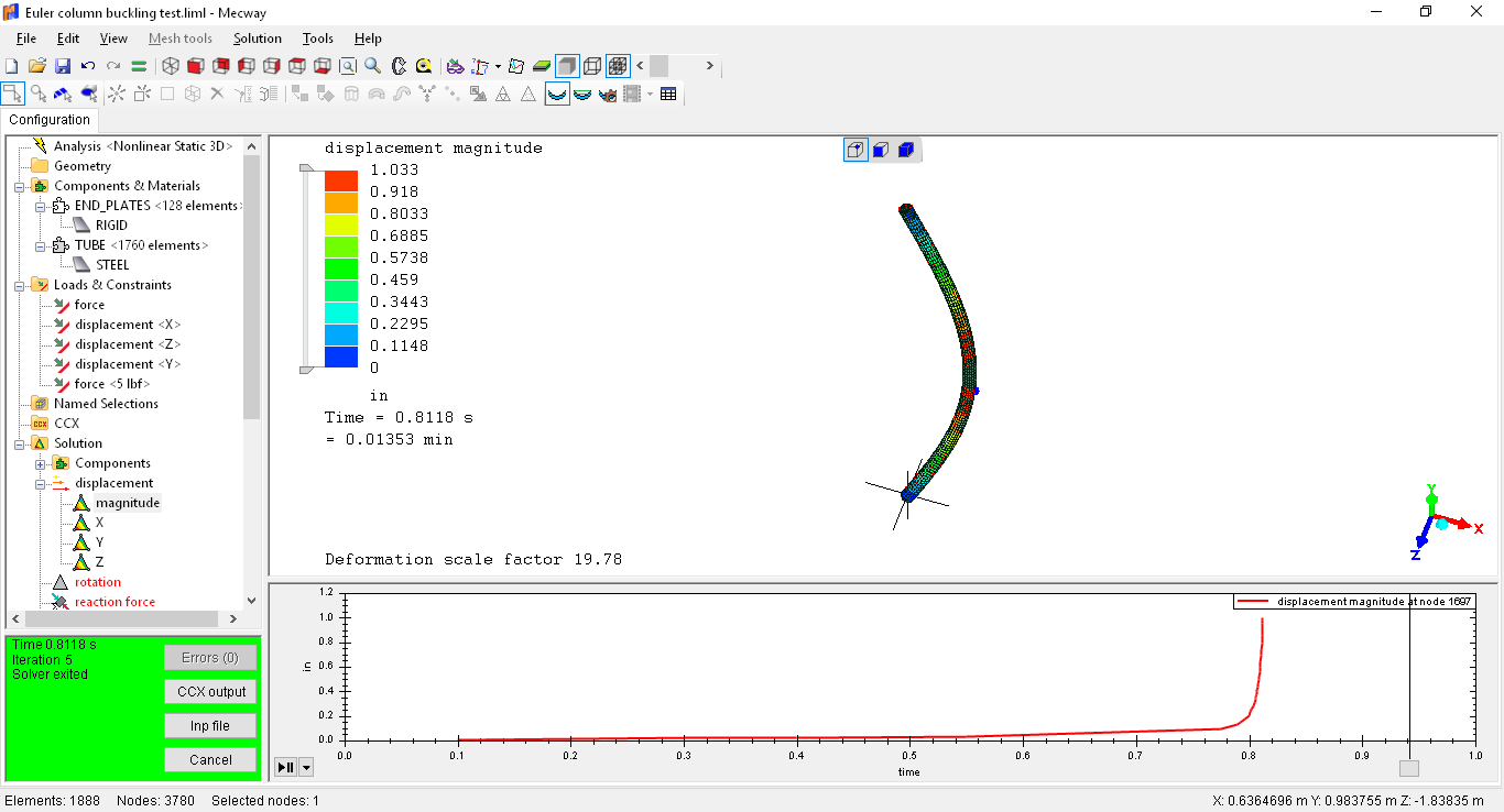

    **4) The easier way is to use time steps:
    • Turn on Quasi-static in Analysis settings.
    • Set Time period to 1 for convenience, and time step to 0.1 s which is just the starting value before it automatically adjusts.
    • Ramp up the axial force by changing -40518 to -50000*t. I made the maximum value higher to ensure it reaches the buckling load on the way.
    • Then, in the solution, you can see where lateral displacement suddenly increases. The value of the force at that time is the buckling load. See attached picture.
    Mecway always runs CCX using m,kg,s units and automatically converts to whatever you choose when it imports the solution. So if you're looking at its output files directly, they'll be in those units.

  • I don't have the file anymore. But it should fail to converge when it buckles and only show the solution up to that point. If automatic time stepping is turned on, the steps might get pretty big but I think it should be on to get the greatest time resolution as bucking begins.

  • With the initial time step at 0.1 s the solution failed to buckle: when I changed it to 0.01 s the solution looked like Victor's.
  • I made Victor's constraint adjustment, set the time step to .01 s and reproduced the plot (Cheers).
