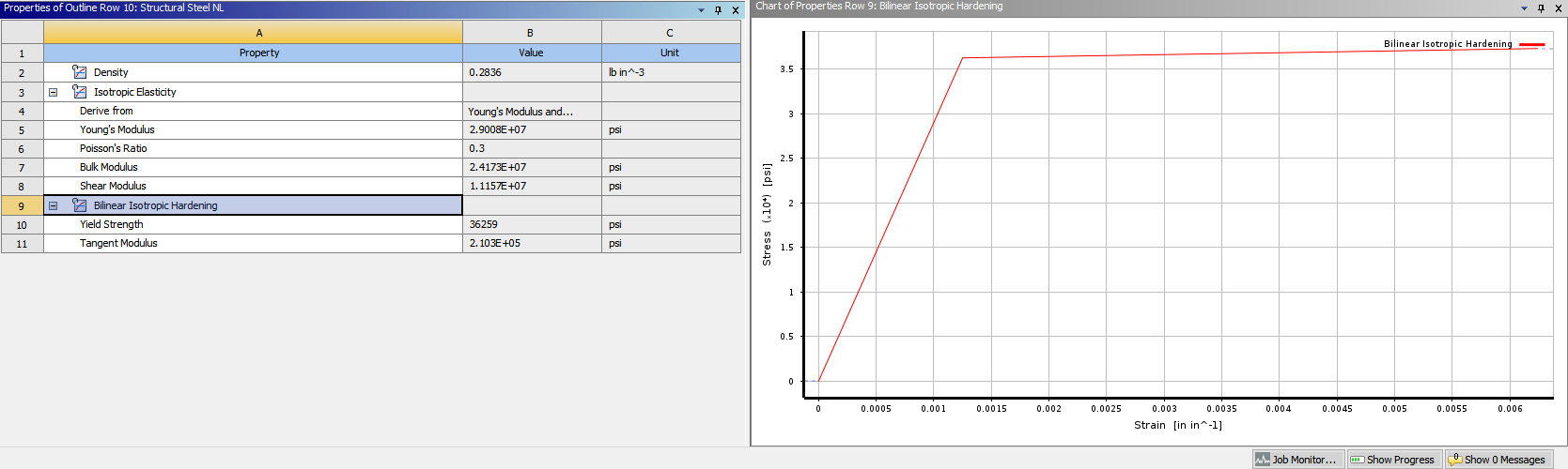

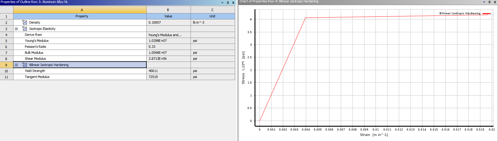

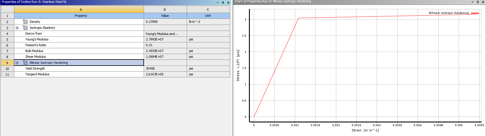

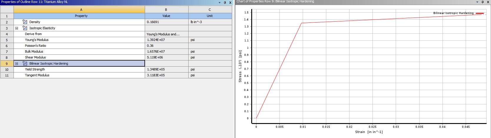

  • I found these General Nonlinear Material from Ansys...
