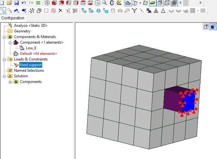

I think the reason it failed was a lack of constraints on the cap part. Contact doesn't usually constrain anything initially, so it has rigid body motion before the contacts close and a static solution can be found. A simple way to correct that is to apply fixed supports through very soft elements so they support it gently but don't carry any significant reaction force. Probably a good idea to start with a few patches of fixed support to make sure that this solves the problem, then replace them with more realistic soft supports later. I'm trying that now but it's quite slow to solve.
Whats the process of constraining a body with weak springs to restrict rigid body movement. As you said body which is only constrained by contact may undergo rigid body motion until the contact close which may lead to convergence failure. Can you explain how to do it?
The next version of Mecway (12) will have elastic support for CCX so you won't need to make the new element or material.
