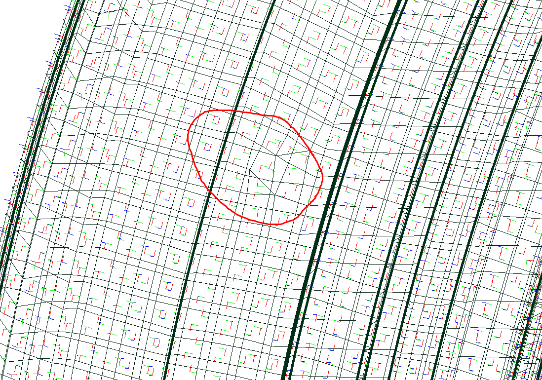

3. See atached picture/file, with minimum elements per curve and edge at 0 (and above mentioned settings) this gives the best orientation of the elements. However, some elements (in the fillet area for example) don't have the x orientation in the right direction (fiber direction). How to solve this? I know you can do some corrections by hand, but that would be very hard with complex 3D shapes. Is there a better way to do this?

    3. The default element orientations are effectively arbitrary so don't use them. Instead, there are two ways to define the direction of the U (local x) axis:
    a) Select elements, right click one, click Element properties, enter the direction vector there under Orientation.
    b) Add an Element orientation under Loads & constraints. This way is newer and allows you to define it by a formula as a function of position, so you might have them uniform along the straight part but rotated around the circular part.

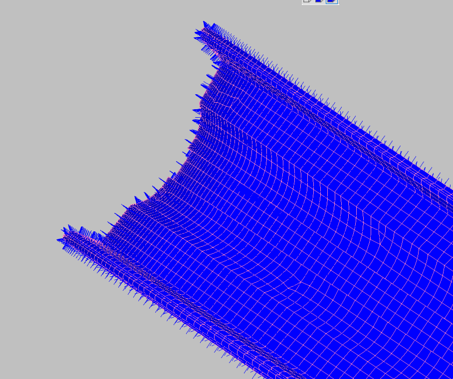

    However I don't see how I change the orientation in case of a complex 3D shape. For example I attached a motorcycle wheel (see file). Let's say this is a aluminum wheel and I want to change the rim for a CF rim. I made two parts; Hub and spokes are out of aluminum (orientation of elements not relevant), rim of UD CF. The spokes and hub are meshed with the Gmesh option. Rim is a surface mesh. Since you mentioned I shouldn't use the default element orientations, how to orientate these the right way? I've no idea of a formula that can fix this for me...

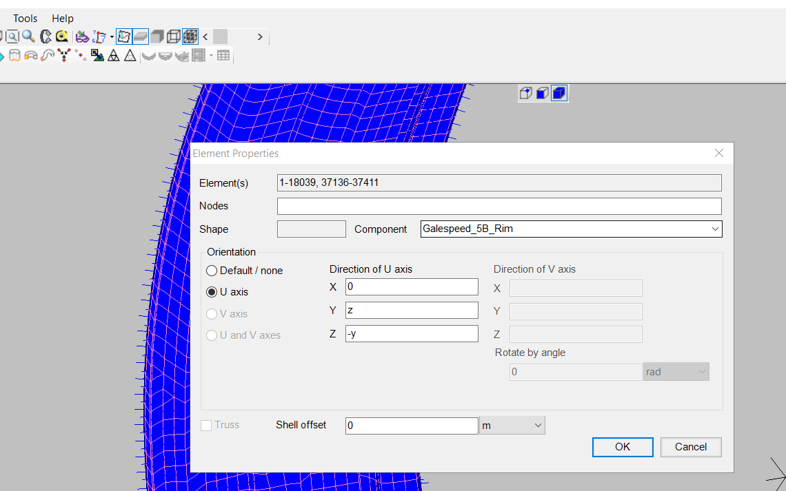

  • You could try choosing all rim elements and apply an axis change of this kind (see picture)
    To open this dialog box ,put cursor on top of the elements , right button and element properties menu
  • A point that might be confusing is that "orientation" here doesn't affect the shape of the mesh, just the direction that the composite material is aligned with.
    So disla's (0,z,-y) formulas would make the U axis in the circumferential direction despite the crooked elements. But that's only available with the Loads & constraints -> New element orientation option, not through Element properties.
