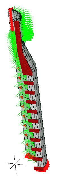

I am trying to be sure I have the right boundary conditions (BC) for my model. I am new to Mecway and quite impressed. I made a 2D model and extruded it -90 degrees. Now I think I have 3D solid elements (I don't know how to check what type of elements I have). I thought I could get mirror symmetry on the two faces with frictionless support BCs, but I am worried about the rotational constraints in the model. I tried to add rotational BCs but the model said the elements don't have the necessary degrees of Freedom (DOF) -- the faces don't move out of the plane in the solution. Do I need to constrain rotation to get mirror symmetry? In the manual I see ( at 10.6) that solid elements need a pair of displacement constraints to prevent rotation about the Y axis (etc); I'm just confused about the proper implementation -- first BC:select z, z=1, x=1, d=0; second BC: select z, z=1, x=-1, d=0 ???? I looked up and down the discussions. Sorry to bother you. Thanks for the help. jhc
BC are correct but you can change from "Frictionless support" to Z and Y displacements because your model is a quarter of the complete model.
Is not necessary to apply rotational degreed of freedom because you're working with 3D elements. These are necessary for shell elements.
I don't know if the pressure loads are correct because on the lower part is applied internal pressure and on the upper part is applied external pressure (seems to be strange)
The two pressures: (1) the outside pressure is from a press fit due to a pipe thread connection (tapered threads cause deformation, I followed Shigley's analysis to estimate a contact pressure); and (2) the internal pressure is the gas pressure. Thus the two pressures.
Again, I appreciate your help in learning about BCs. jhc
Look at the faces without applying rotational BC. Are they plane?
Obviously there is a reason
PS Maybe is necessary to apply gas pressure to all inner surfaces
