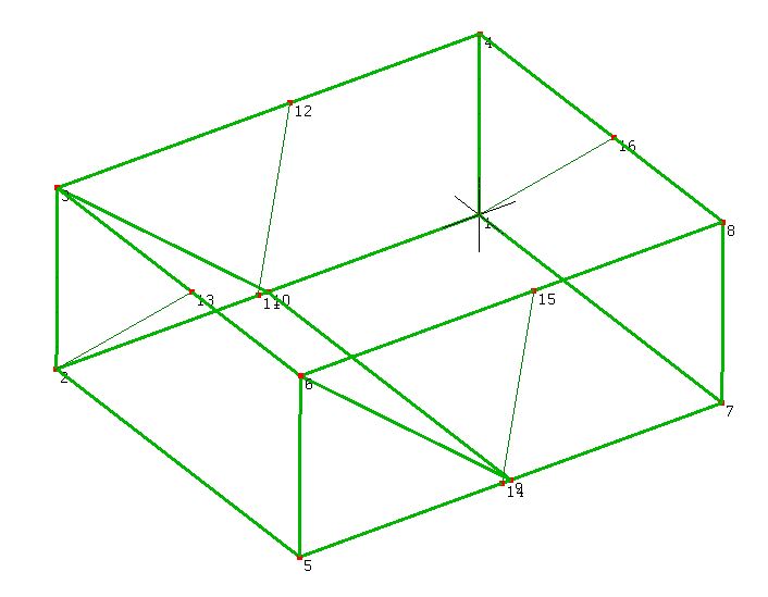

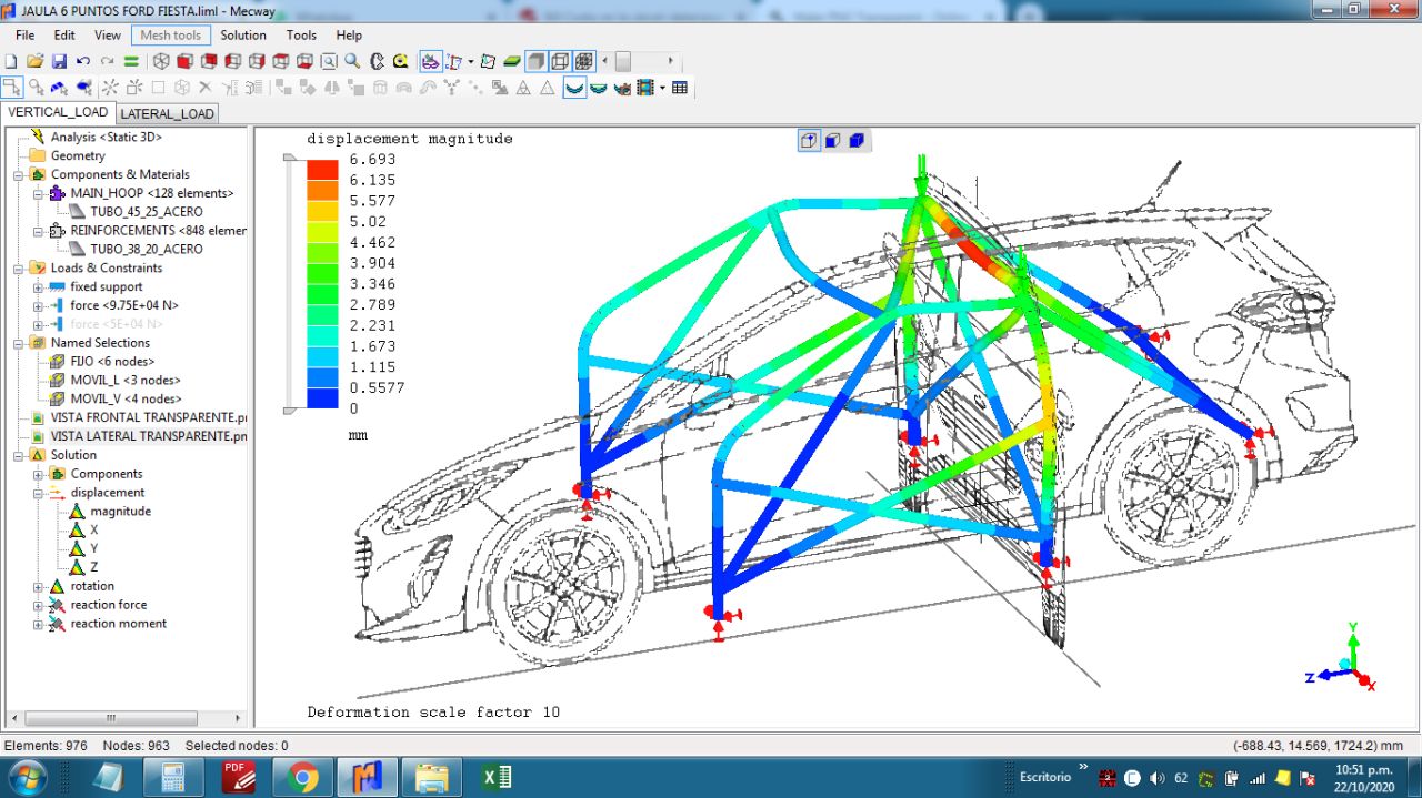

I have a handful of existing truss structures that I wish to compare, similar to this
or this:
http://mecway.com/forum/discussion/423/nonlinear-3d-with-beam-elements-for-spaceframe-car-chassisThey are built using the Solidworks 3D sketcher, which I can export to STEP and open in FreeCAD. However, Mecway only imports solids from STEP files, not lines or curves.

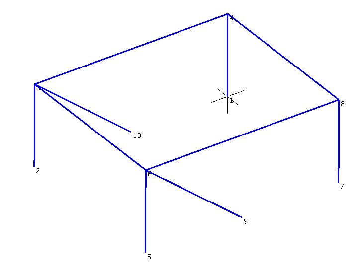

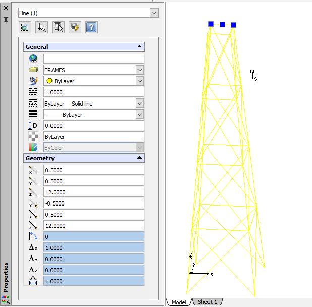

It sounds like if I can find a way to produce a 3D DXF using whatever tools I can get my hands on, then the wireframe geometry from that file will appear in Mecway?

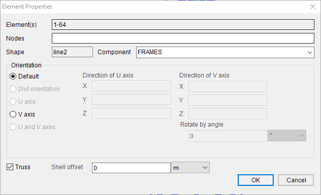

in MW you can assign section element then changing the properties to truss from icon menus.

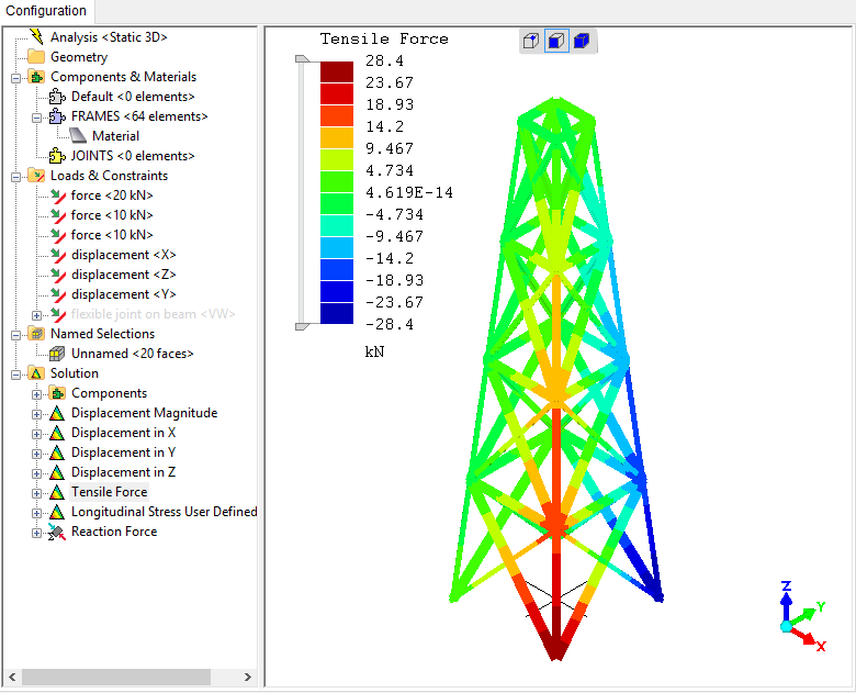

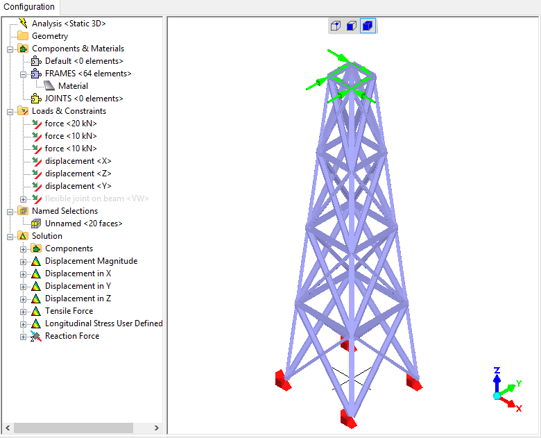

I could then use the 3d dxf in mecway and it works fine
