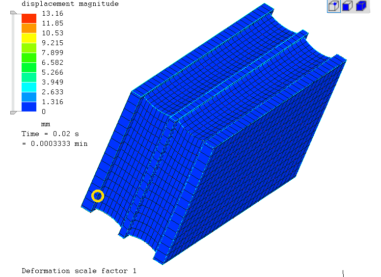

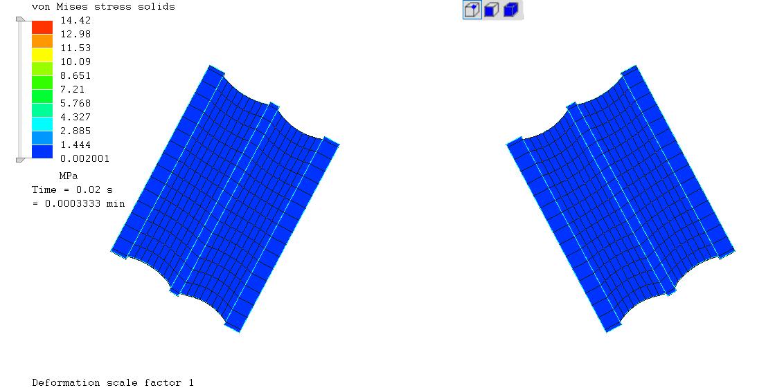

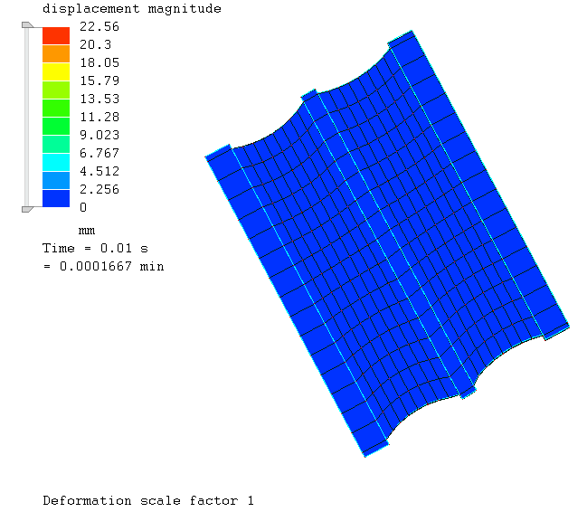

  • There is very few info on the site! It should gave you at least the static stiffness in X Y and Z direction.
    I would start defining a spring by two nodes separated by the issolator unloaded height, so when you apply the load (weight) you would have the preload state. You will need to define also the other two stiffness (by deflection and max load you can define the vertical, but still lack the lateral ones).
    Will try to take a look on the Trellerbog model maybe during the weekend to see if I can compute some stiffnes values for the three directions.
  • Can you measure the unloaded height of the mount? I'm not sure if the height on the table is with or without preload.
  • The height on the mount in the table is the unloaded free height. (120 mm), thank you.
  • edited February 2019
    A little late, but here are the results, hope they be usefull. In the PDF file are the load deflection curves and stiffness values for each direction, assuming a preload of half of the maximun load (8mm)
  • That's fantastic. Thank you very much Sergio.
