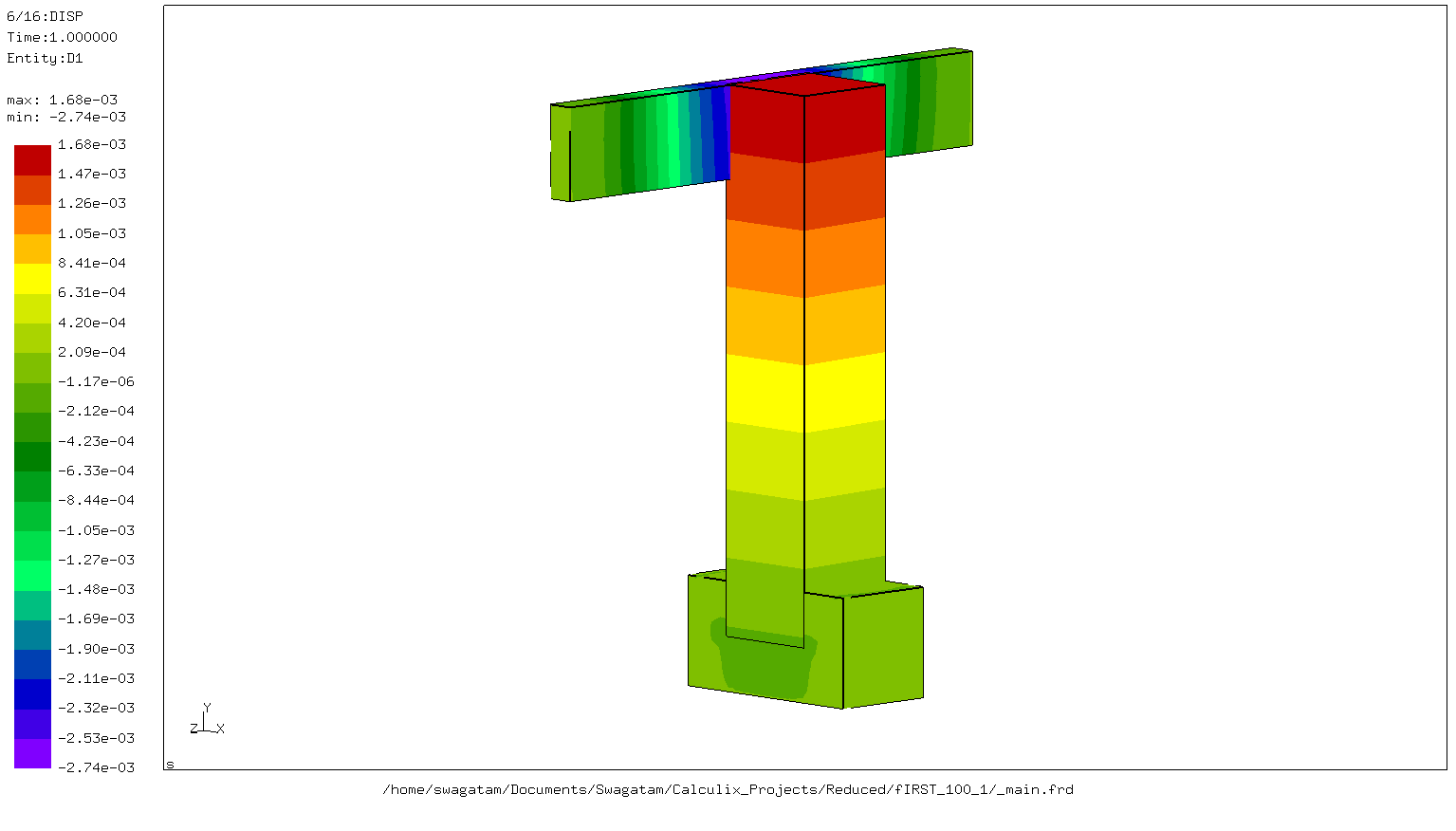

In the figure below, The base U shape is the Foundation which is fixed and Cuboid is fixed on the foundation. The plate is kept fixed on the ends. You can see the plate is intersecting with the cuboid and it has penetrated the cuboid surface. The purpose of doing this is to create an initial bending of plate , by giving a contact between cuboid and the plate. I want the value of stresses at the base of the cuboid and at the contact area of the foundation. Is it possible in calculix

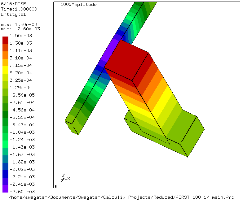

    Thanks Sergio & Victor. I tried experimenting with the intersecting geometry. I tried to give a linear,no penetration contact between plate and cuboid and it showed stresses but I tried to validate it by changing the young's modulus of Plate to see if the displacement is logical or not but it turns out that its not.When I reduce the plate 's Young Modulus by the factor of 10,it is suppose to increase the displacement of plate in -x direction but it doesn't.What can be the reason. Here are the include files. 100_1Plate inp is the mesh inp file

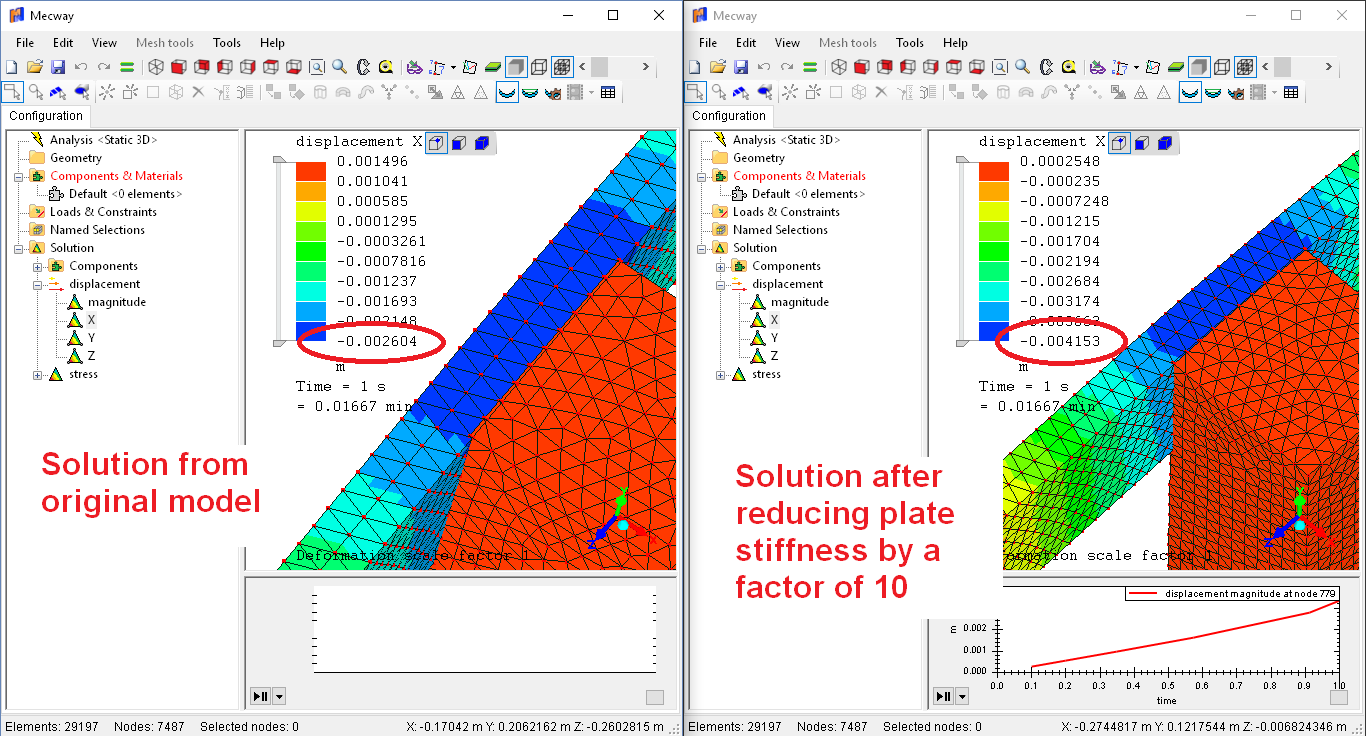

  • It works OK for me. I used this plate material:
    *MATERIAL,NAME=Cplate
    *ELASTIC
    1.0000E+08,0.3
    and it caused double the displacement at the middle of the plate, compared to the original plate material with E=1e9.

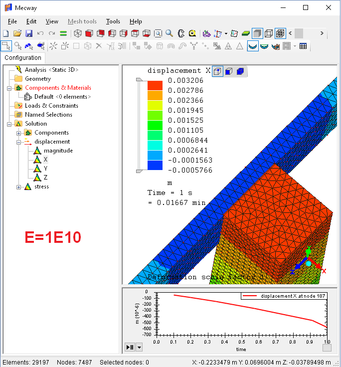

  • Thanks Victor. Yours result with 1E10 is correct according to hand calculation but CCX is showing different results than yours with 1 e+10 youngs modulus. DId you change anything from your side ? If not then do i have to use another build of ccx?

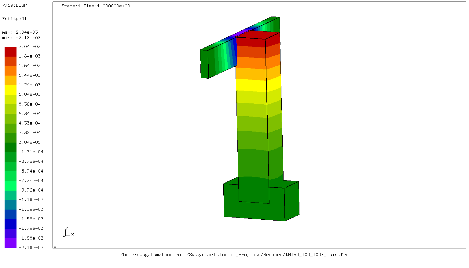

  • This is what I am getting for 0.1,1,10,100 Gpa Youngs Modulus.

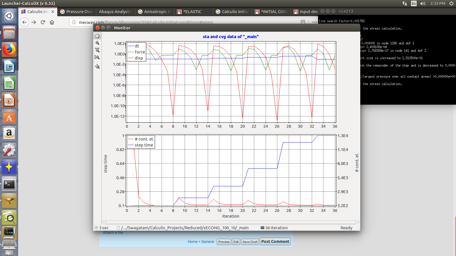

  • I ran your .inps file and it worked and It gave the correct results. So its not the problem of the solver. So it can be about convergence.But no matter how low i make the initial increment or increase the number of increments it gives the same result.Seriously,its odd.Our inputs are same but still its giving me so much trouble. I hope you can find out what the problem is.
    1600 x 900 - 192K
  • Attached is the .cvg file, if it helps
